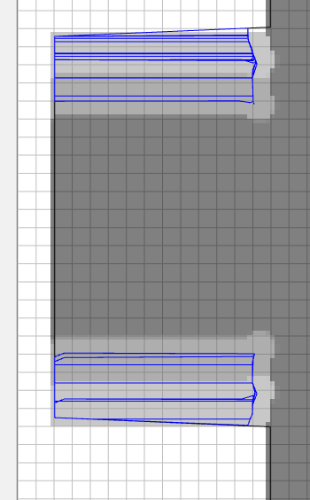

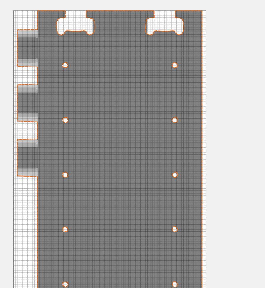

the bounding box is still terrible, any word on getting that fixed? Or just like geometrically correct STL’s in general? Paid for CC Pro again and I’m feelin a bit cheesed since the 806beta thread the question was asked and it was touted and it was supposed to be good.
Is there any way to get the kind of accuracy I need without additional programming that would give pro enough value outside of being artsy?
edit: there are only nominal values up to 3 decimal places and all of the angles are either 90deg or holes

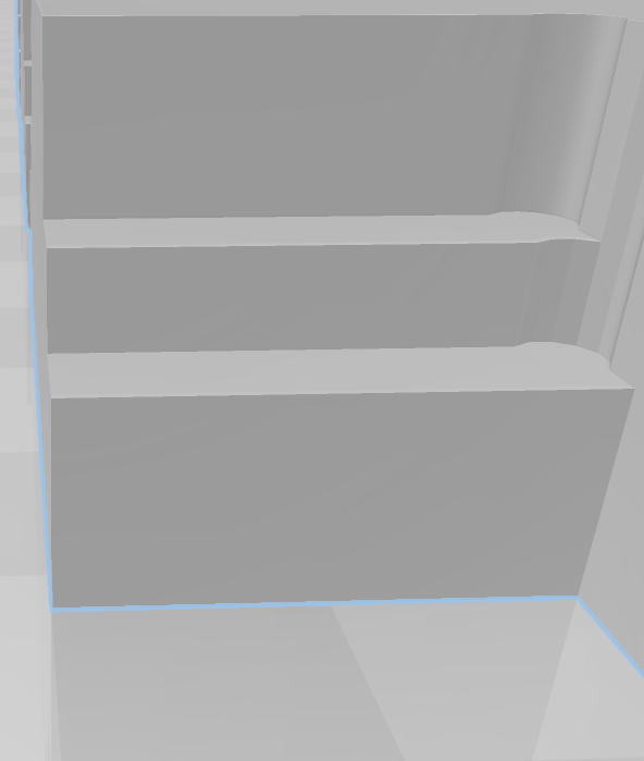

in 3d builder i see no strange geometry or awkward angles with the exception of a minor fillet leadout from the hole cutouts.
yet the toolpath wants to leave random walls and add steps that aren’t there.

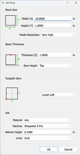

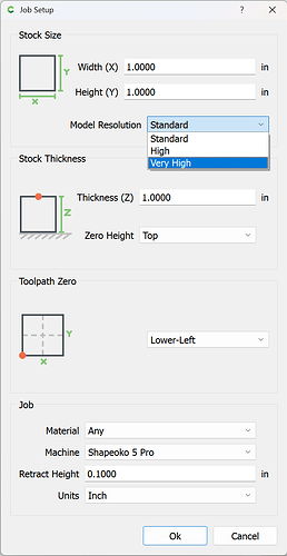

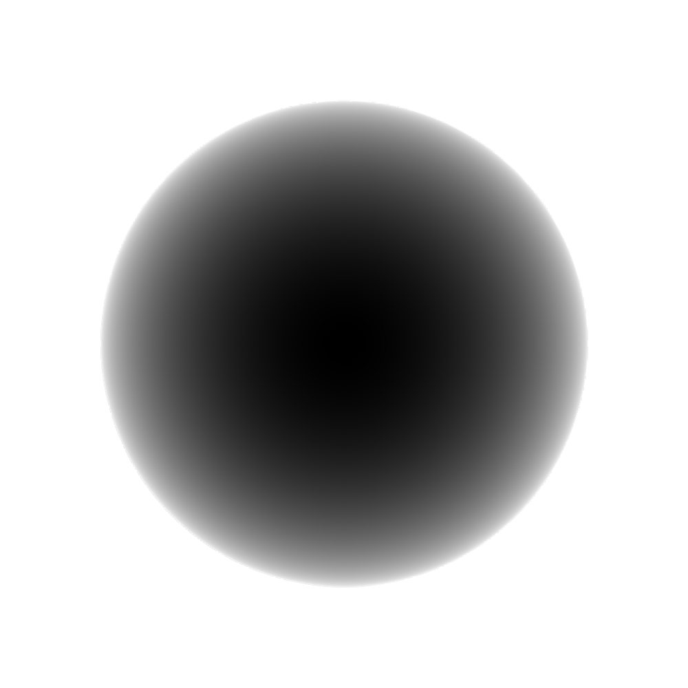

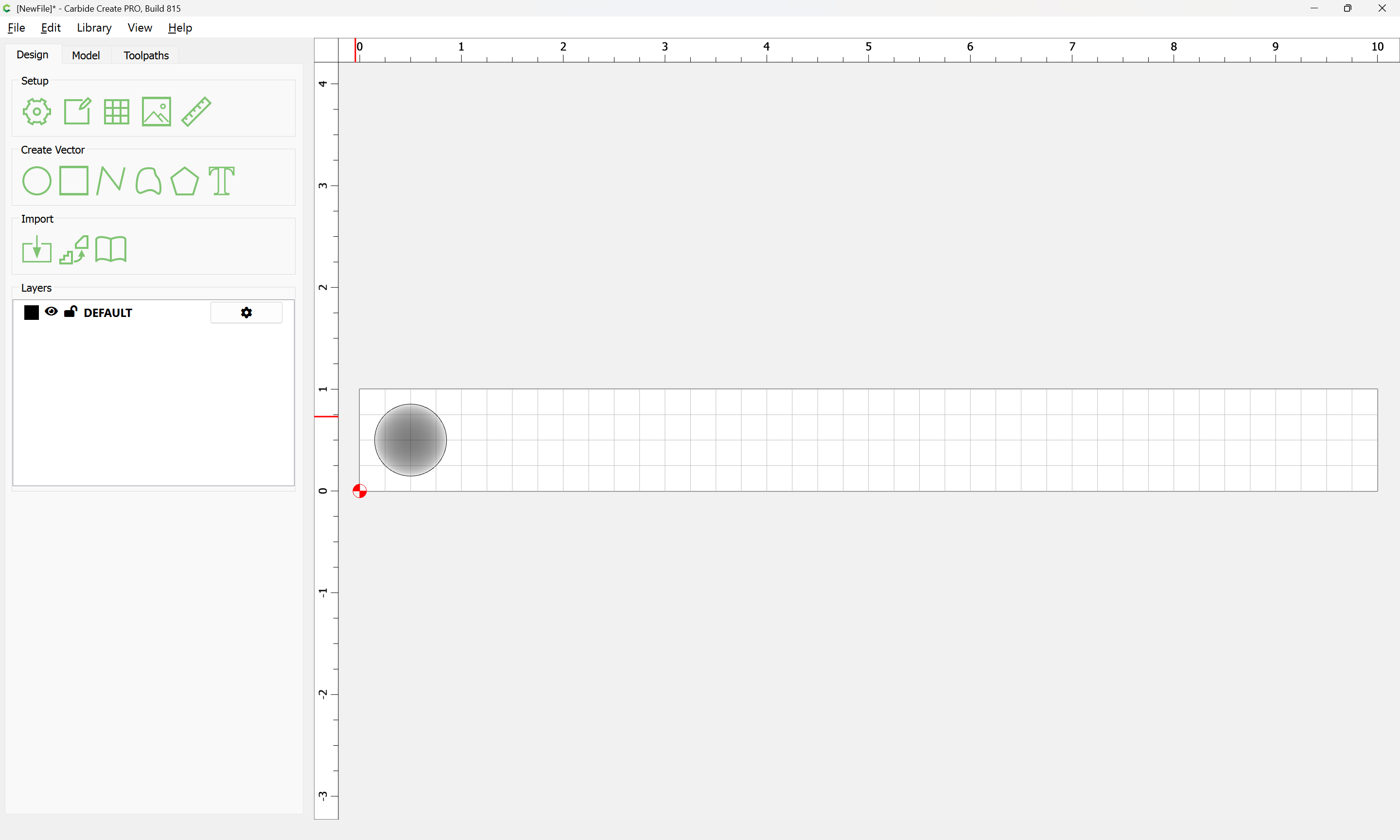

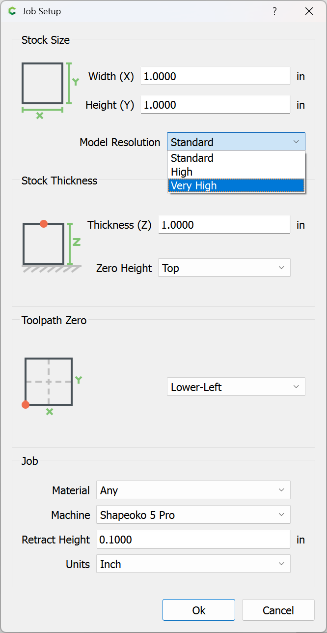

STL import takes the STL triangle description of the 3D surface and maps it to a pixel image — the dimension of the pixel image is determined by Model Resolution in Job Setup:
A 1" x 1" Stock area will be modeled as a 1000 x 1000 pixel image when exported using File | Export PNG:

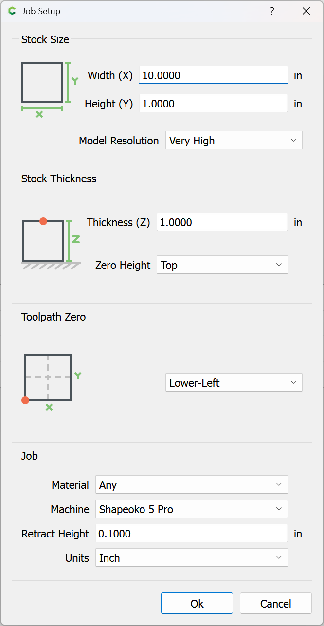

If you then change the Job Setup dimensions to:
and export again:
then the dimensions become 6,325 x 633.
