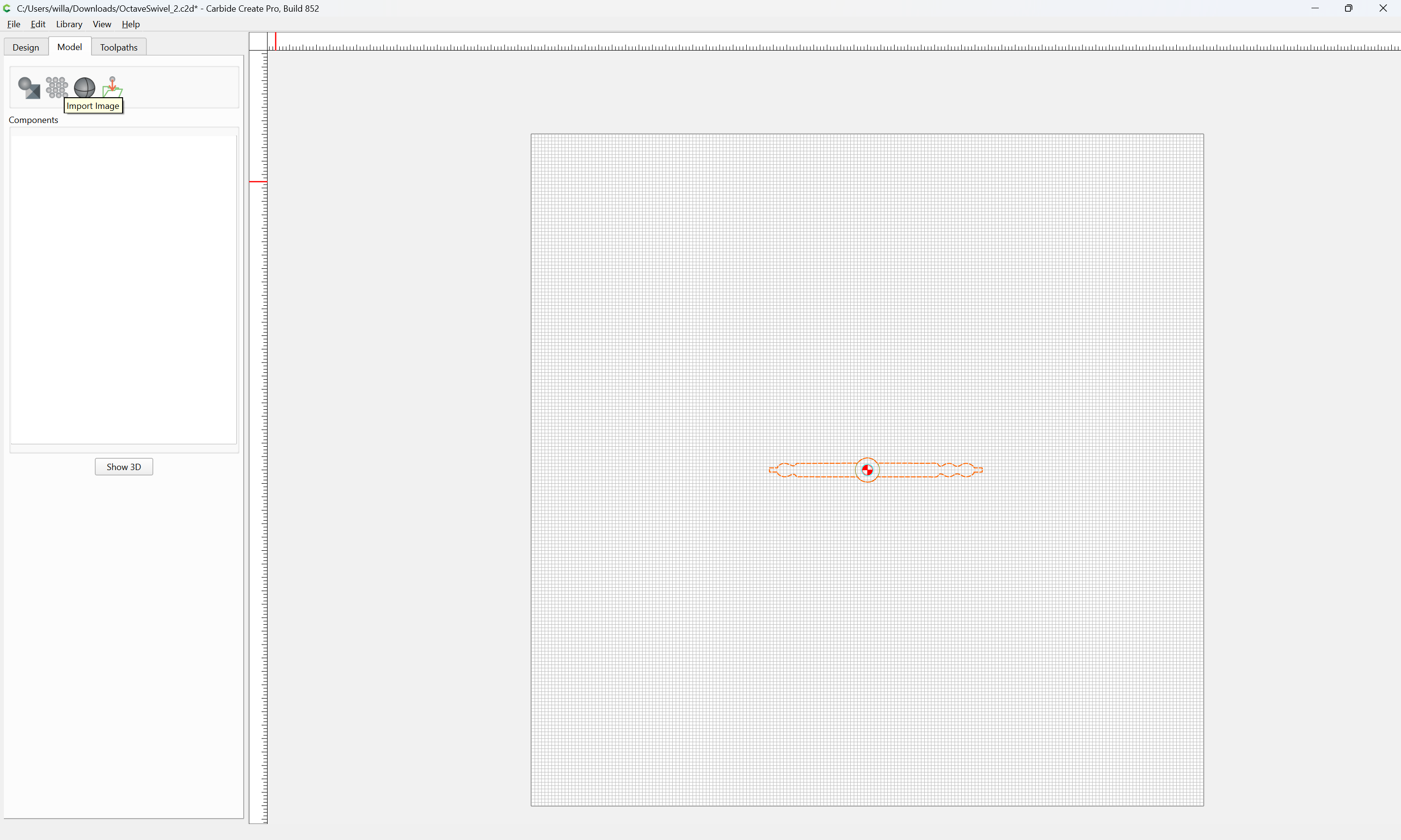

STL repositions unwantedly

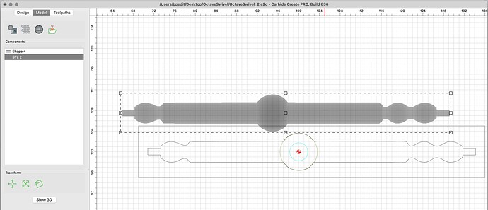

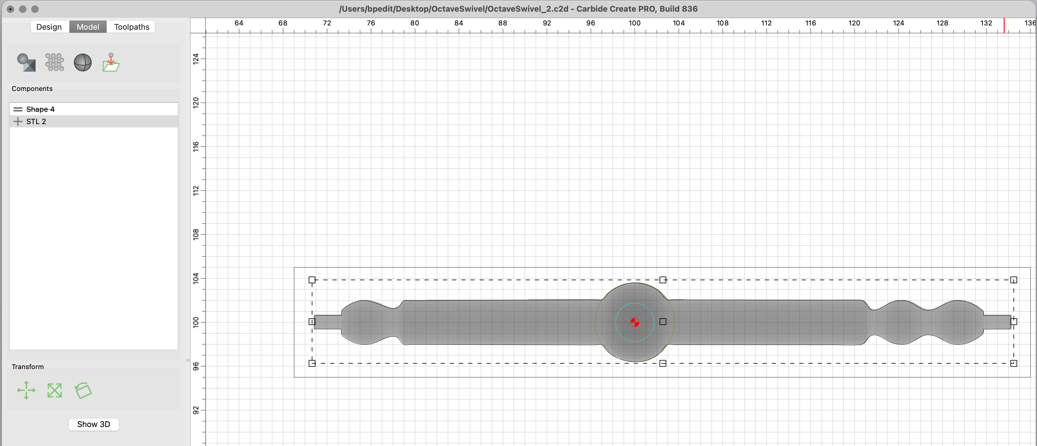

I want an STL positioned to match center. The only way I find to move it is by dragging the selection box. The Transform buttons have no function.
Okay, fine.
But as soon as I click Done in the Edit Component dialog, whether I’ve changed anything or not, the position reverts to the previous position.
I remember this issue but I don’t remember, nor does a search provide, a solution.

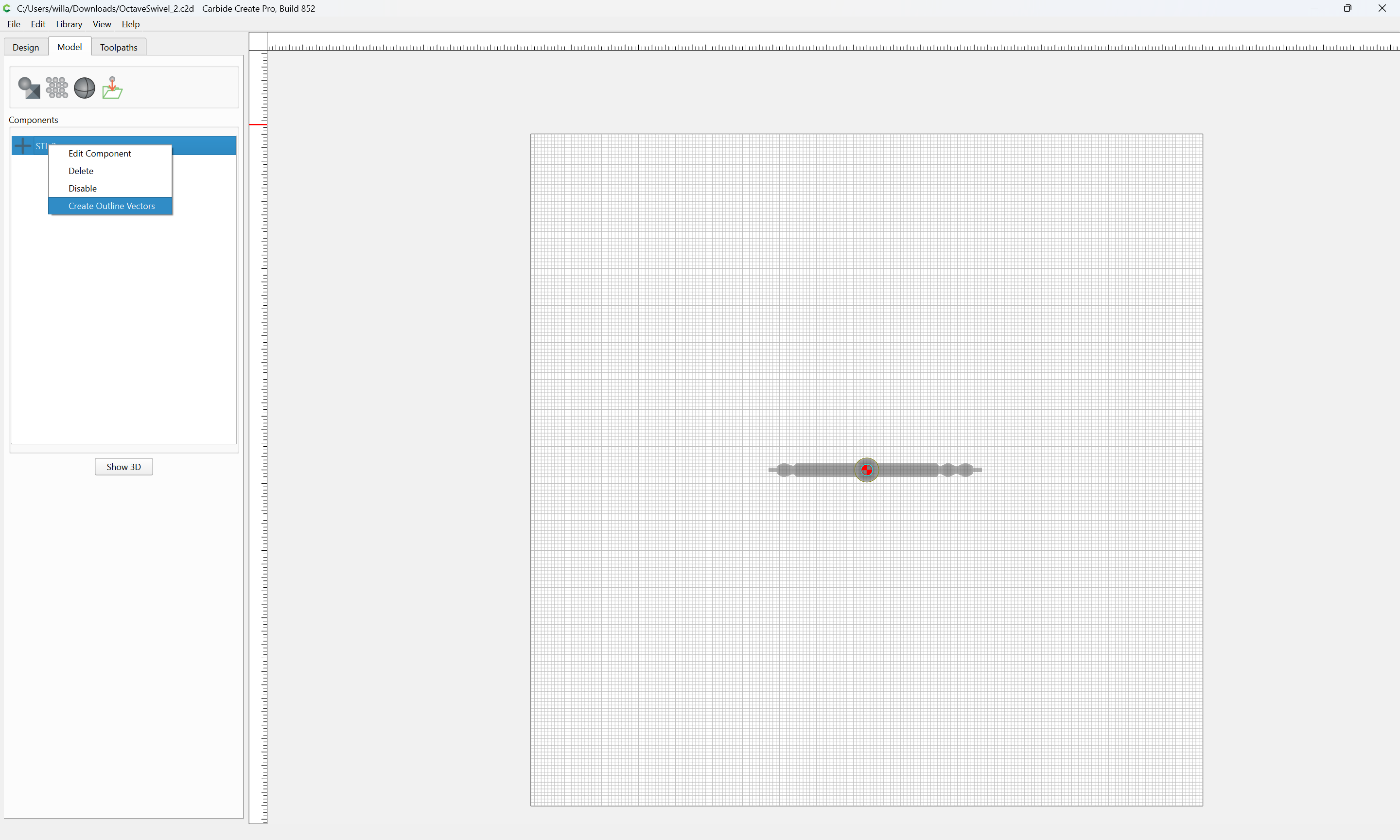

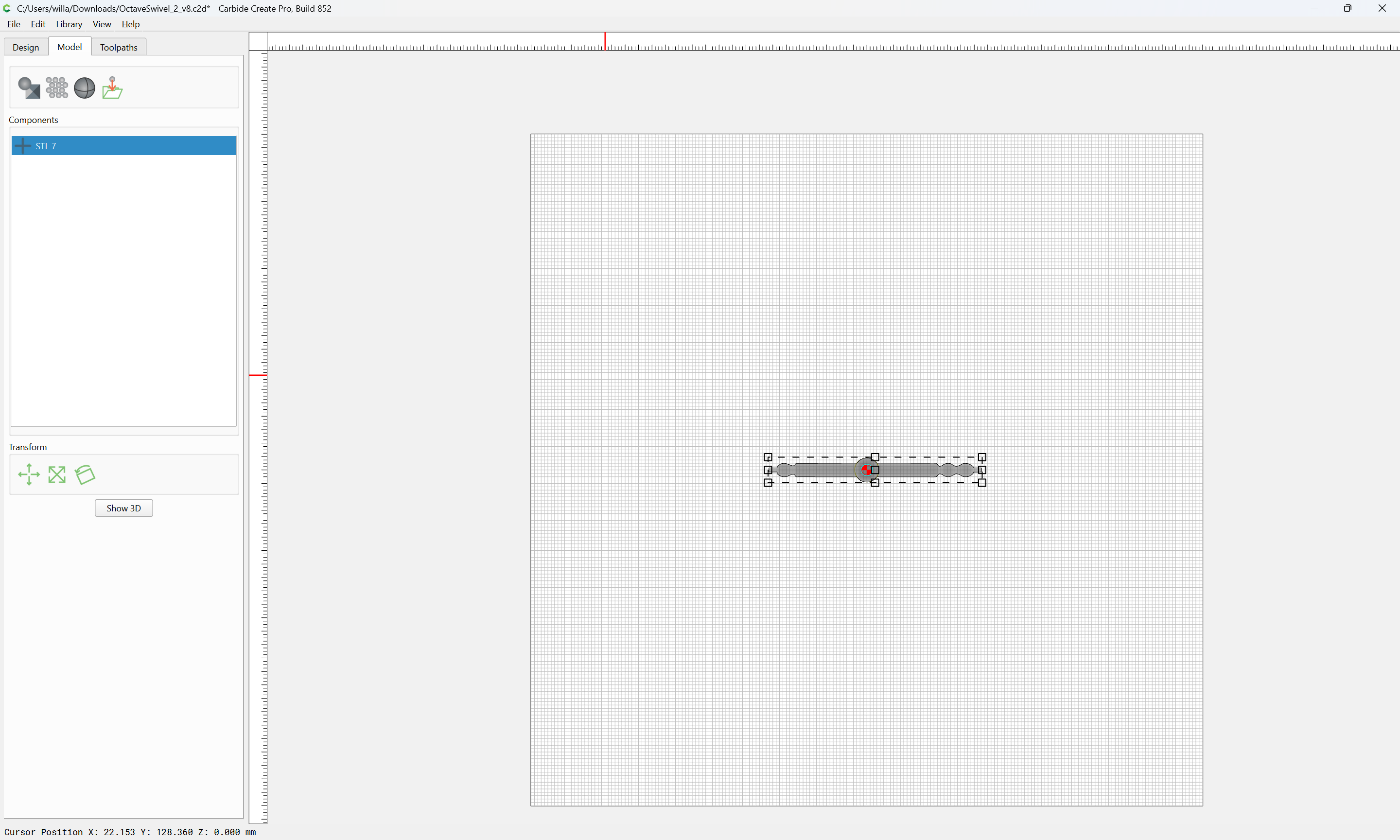

If I select the STL in the list:
drag using the center proxy:
and the moved object stays where it was placed.

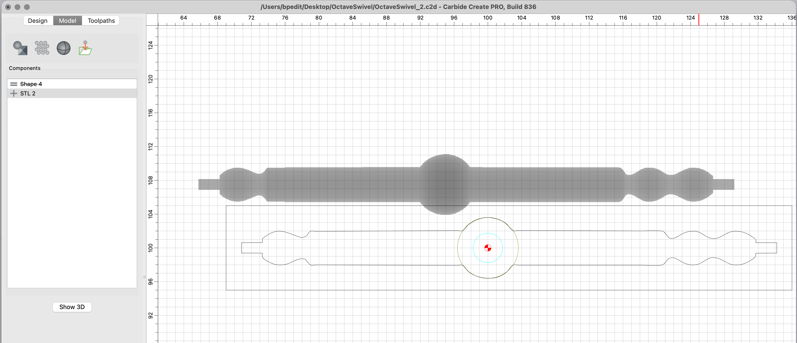

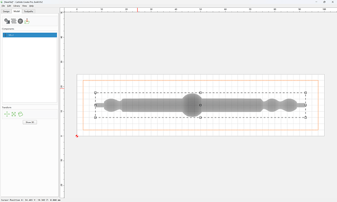

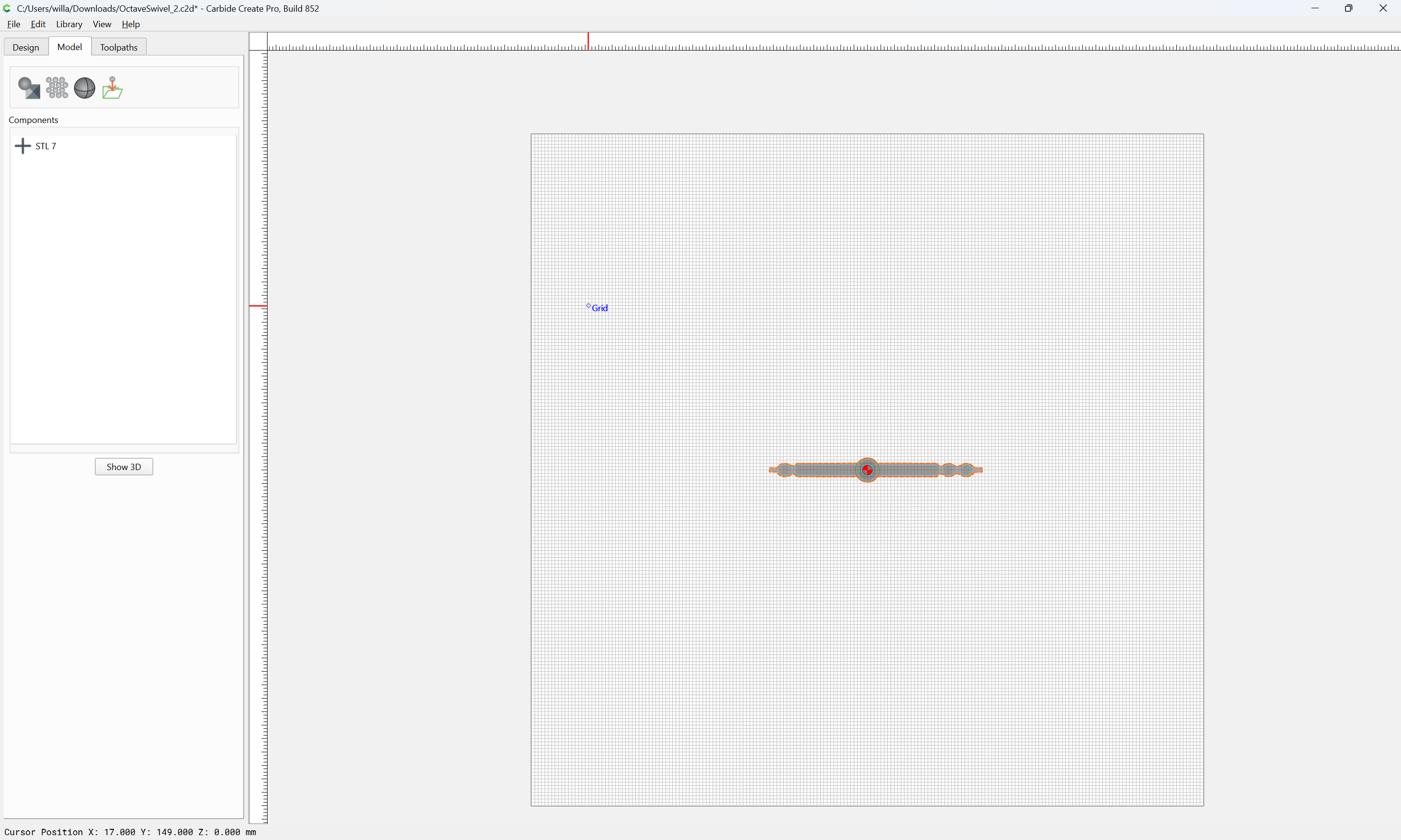

No. When you first open this file the STL is where it should be
• Select the STL in the Model window and Right Click to select Edit Component.
• Click Done.
What happens?
The issue isn’t the object immediately bouncing back. It is, as originally stated, the object repositions after clicking Done in the Edit Component window.
OIC.
I am able replicate that and will file a bug report.

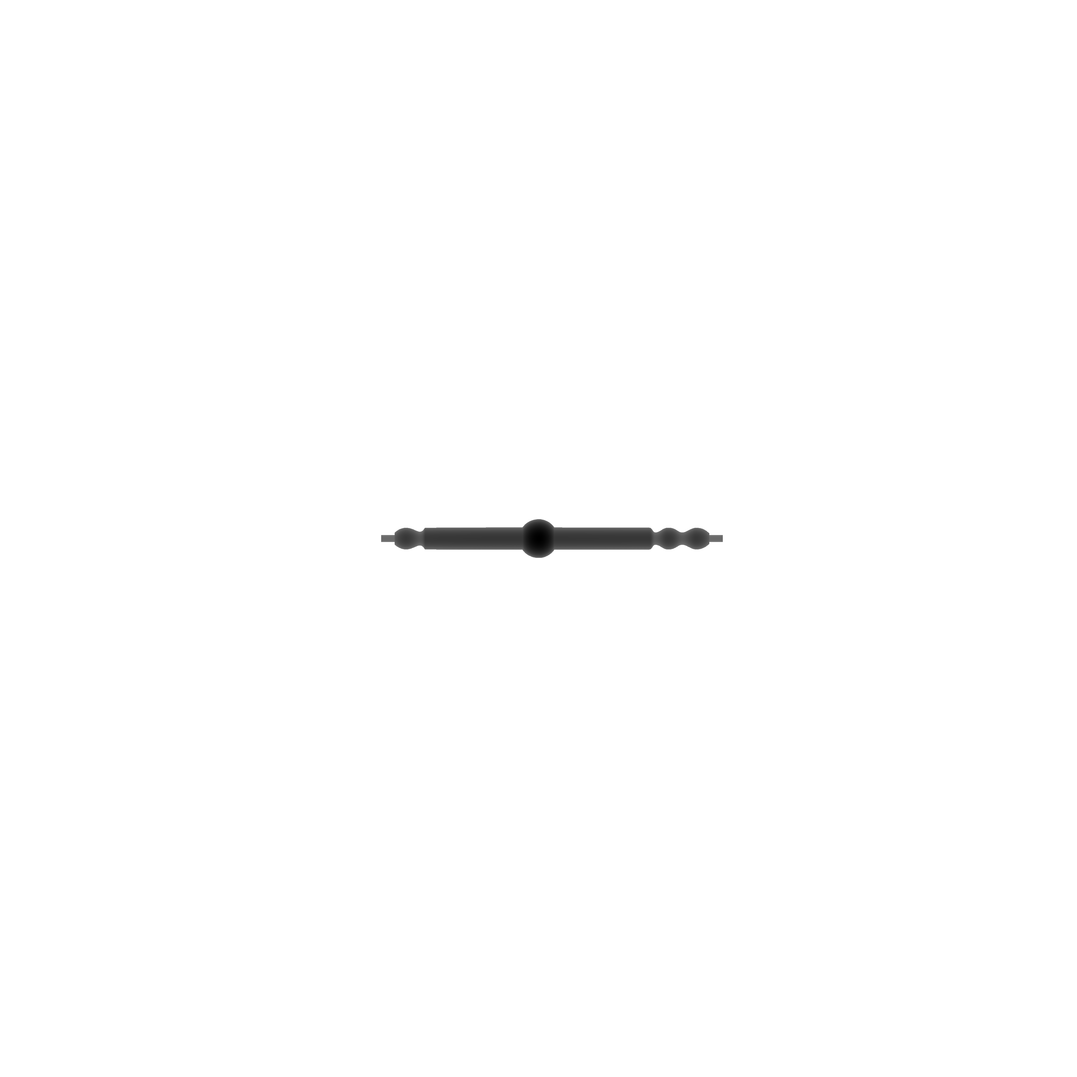

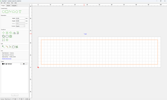

To work around this export to a PNG.
Trace the STL:
delete the STL and select the geometry:
and use Import Image:

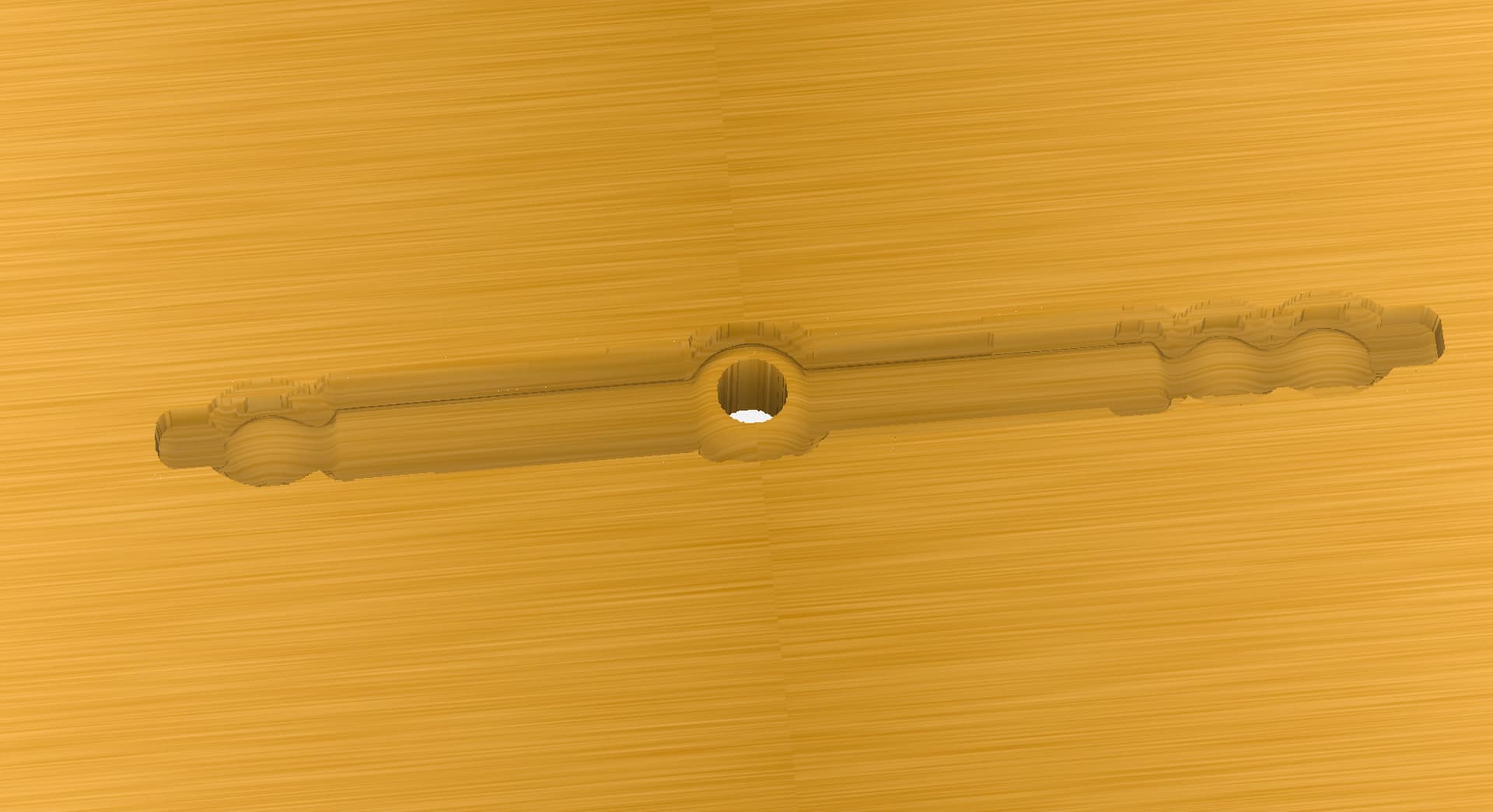

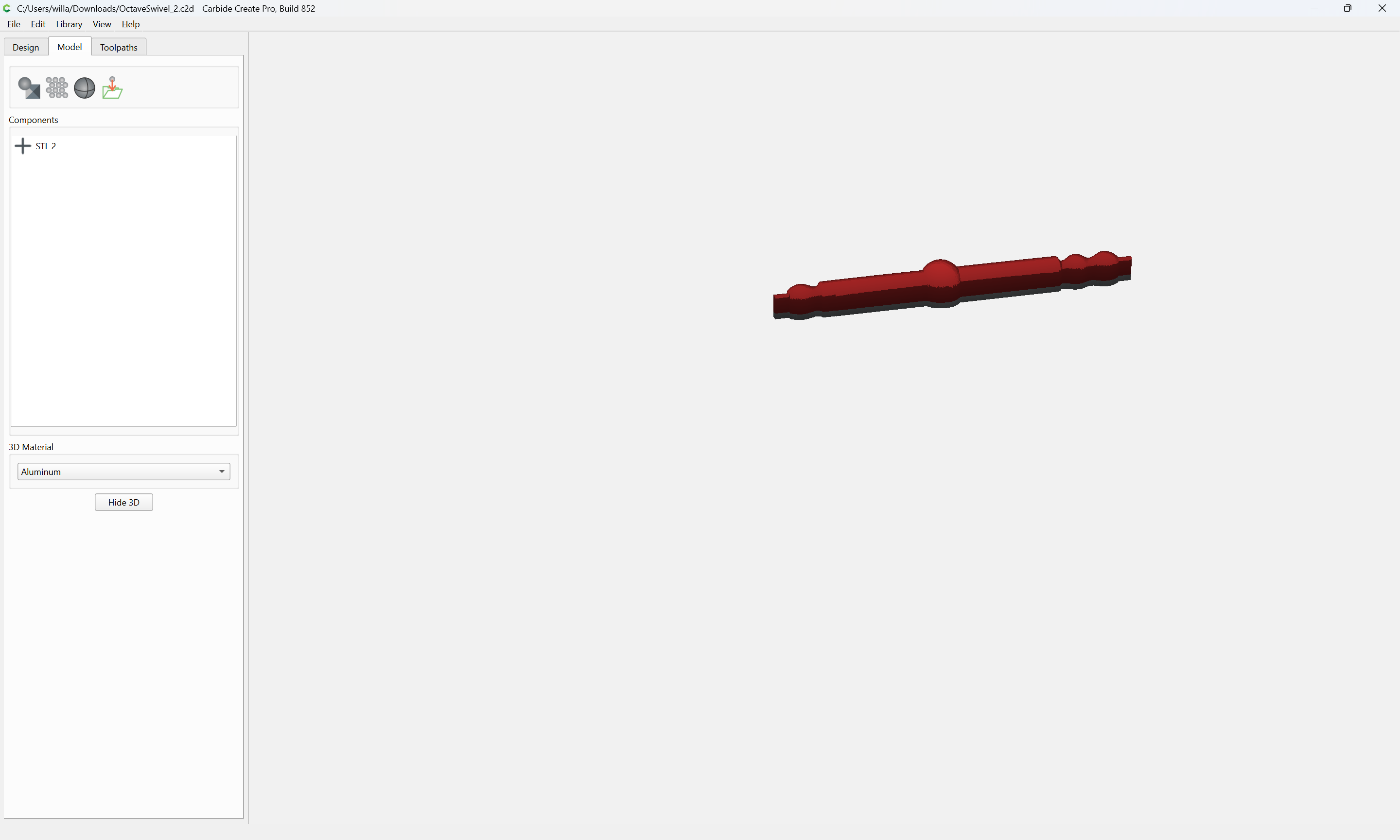

except that won’t work because the STL was modeled to be thicker than the stock:
Yes, the model is thicker than the stock. The central sphere is meant to be truncated by the top and bottom of the stock. It should appear as such:
My current workaround is to simple reposition the model each time. A bit tedious zooming in for precision but it works.

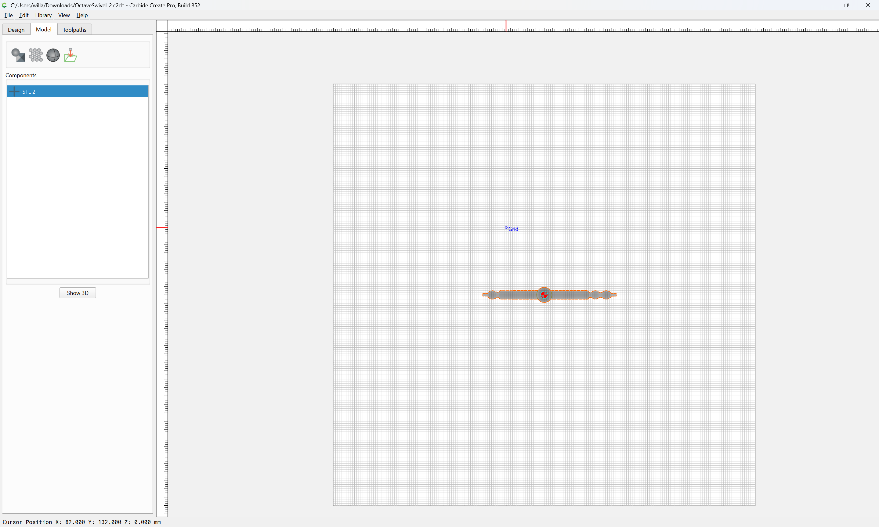

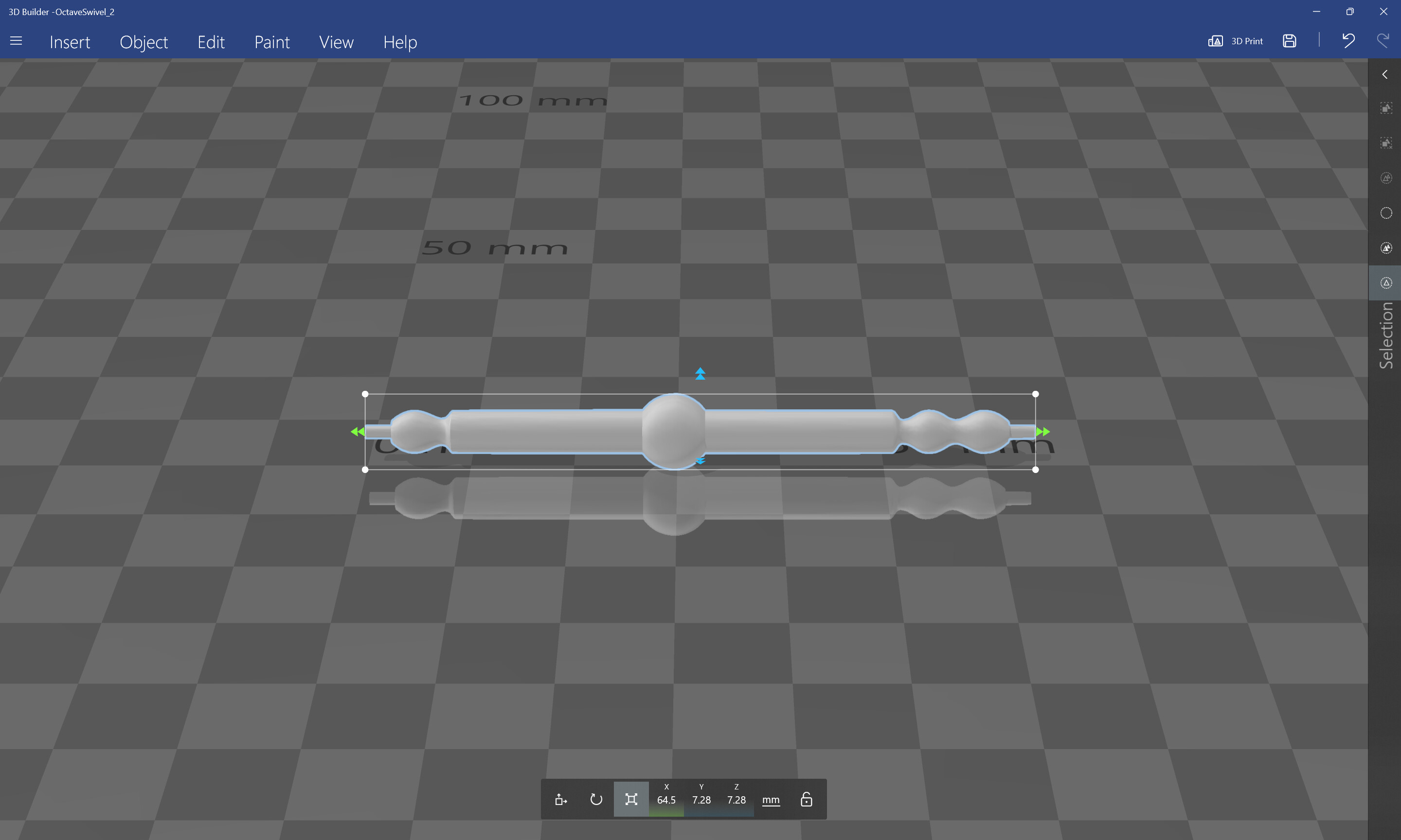

I tried experimenting with the STL file which you sent in.

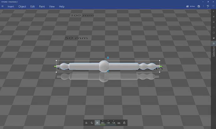

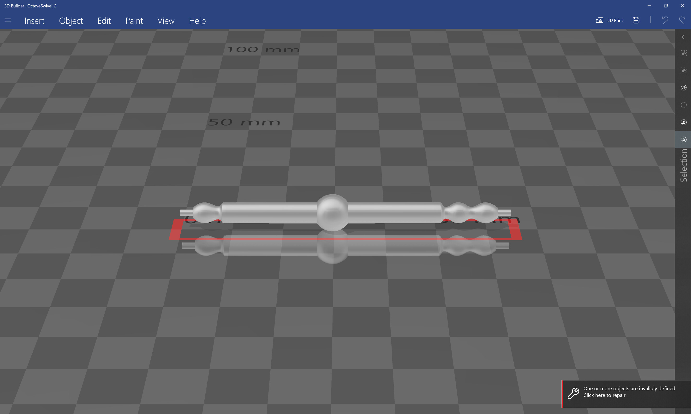

As noted, it is reported as having errors when examined for dimensions in Microsoft’s 3D Builder:
and if one repairs it, then the dimensions seem to match up with your file:

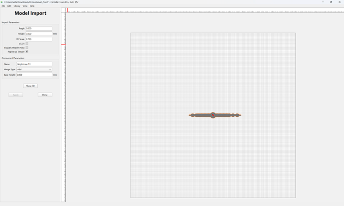

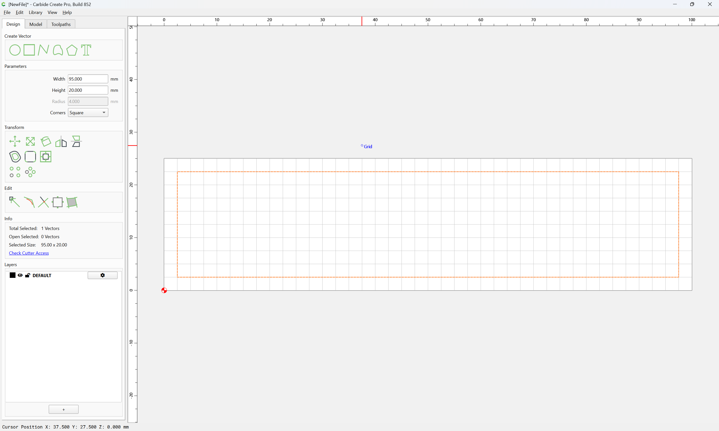

but if I make a new file:
and import into it, the scaling seems way off:
and if I then edit this STL:

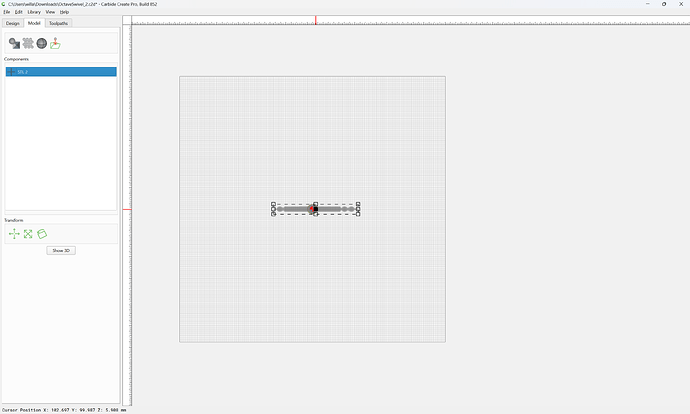

it does not shift/change position when “Done” is pressed:

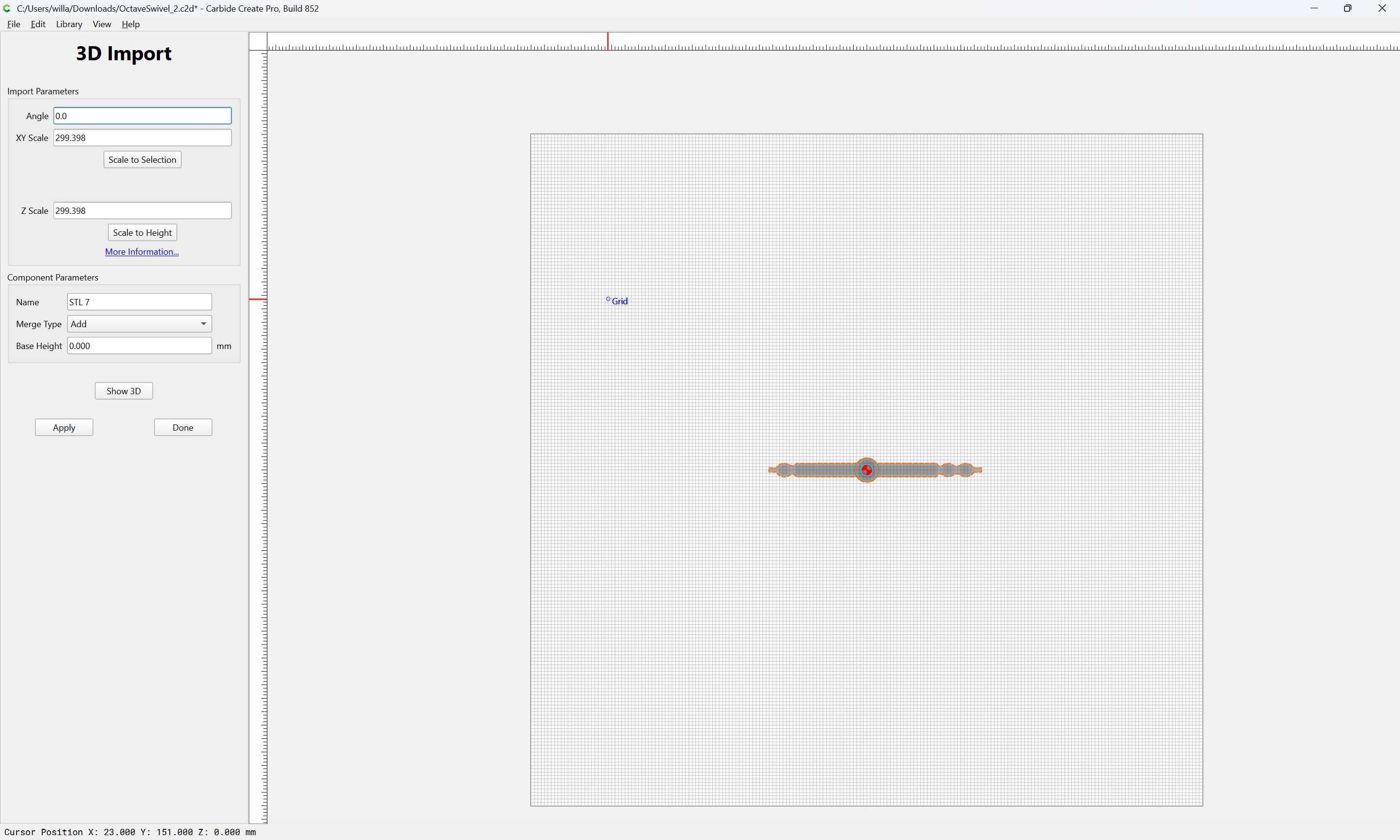

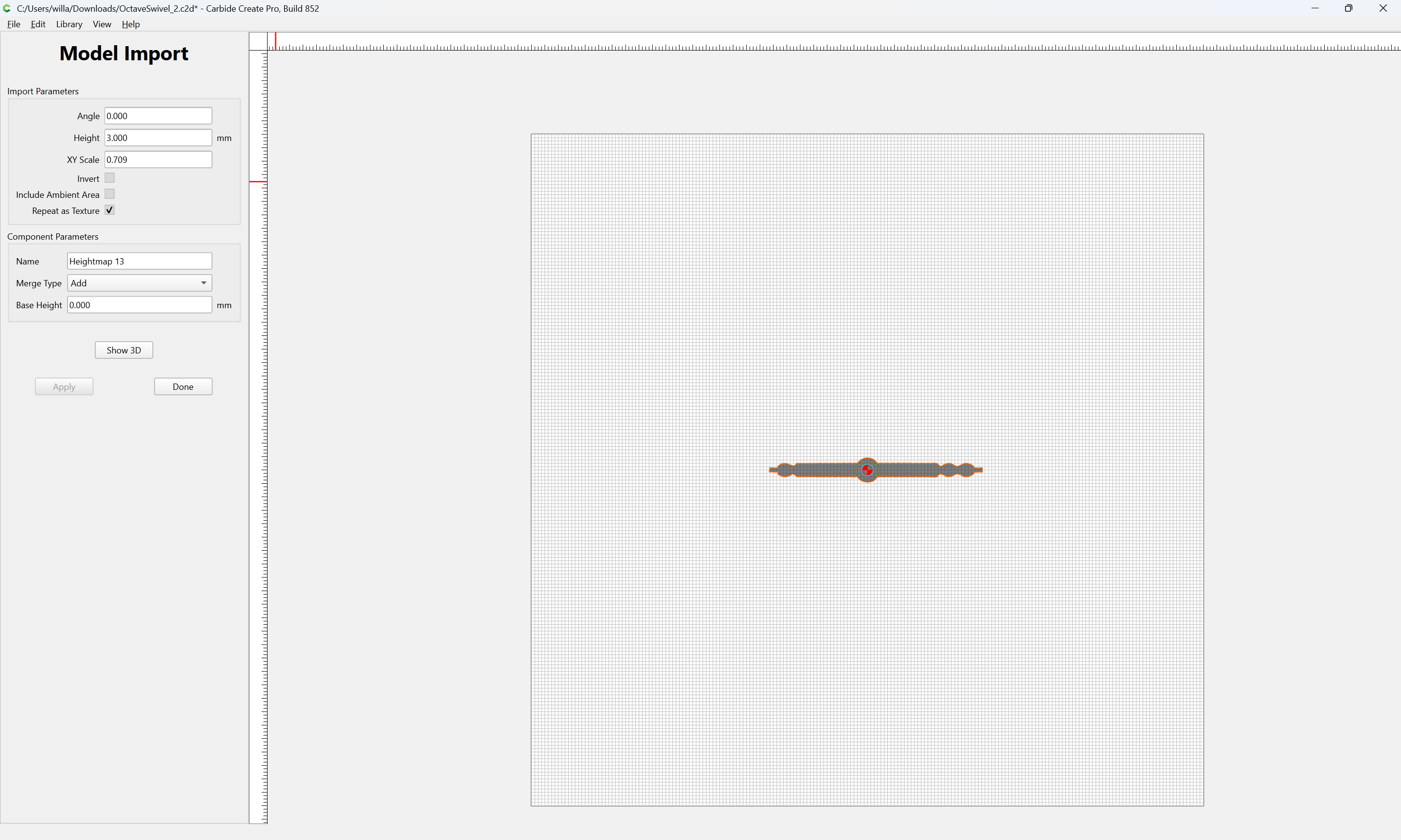

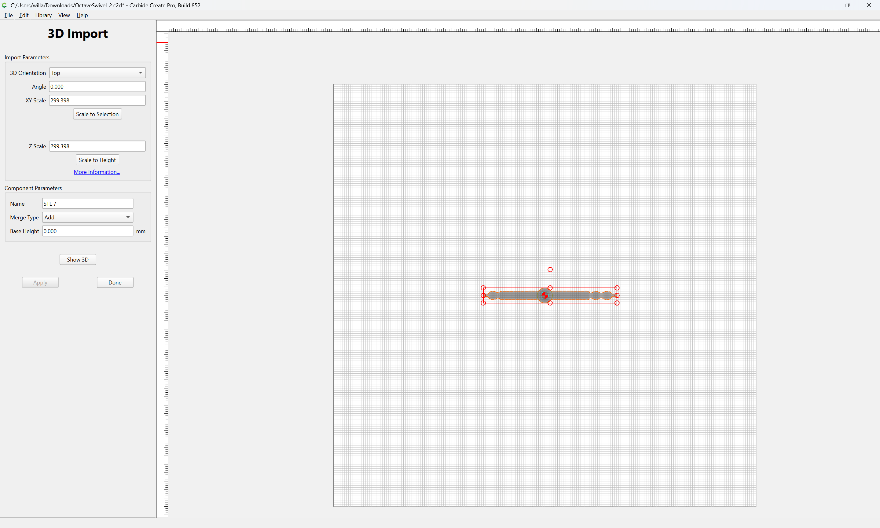

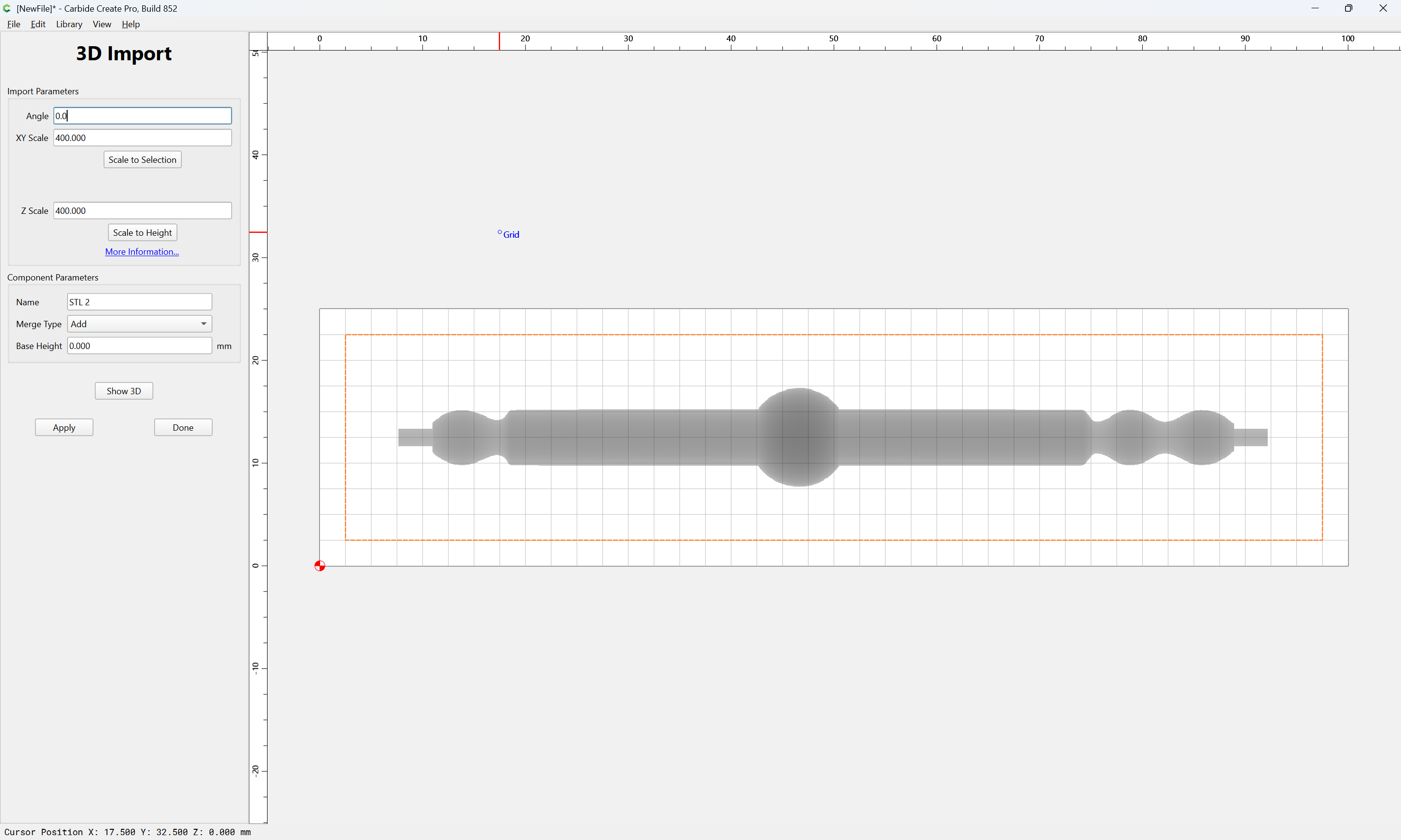

Importing the STL into your file after tracing the STL and deleting the 3D model:
seems straight-forward (though I suspect that the scaling should be changed to 300)

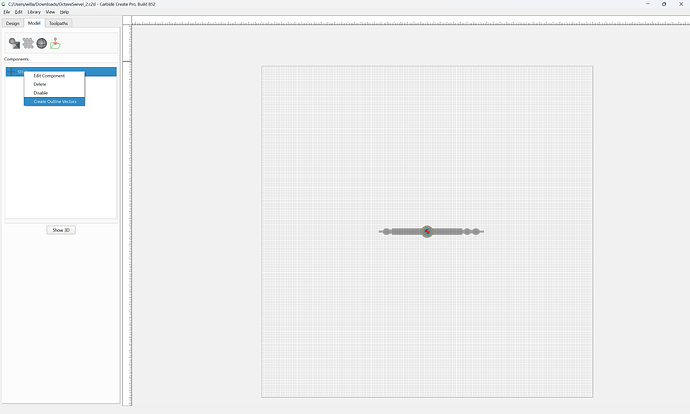

Subsequent editing of the STL component:

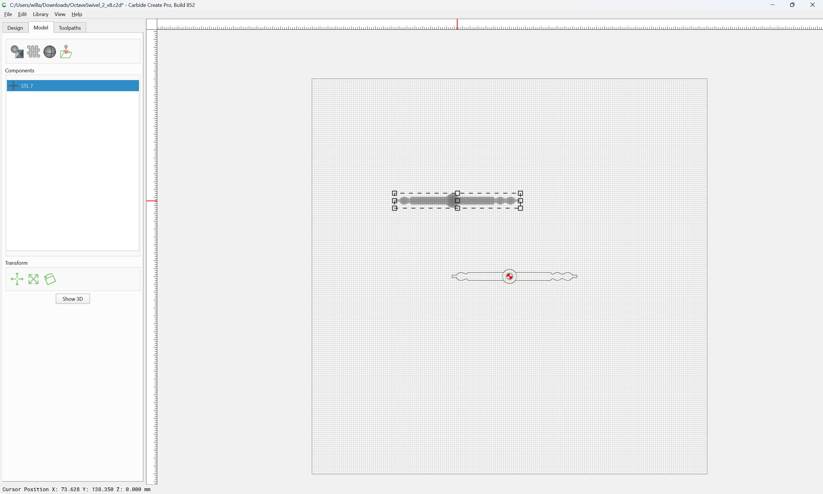

Does not shift things — but I’m on Windows and you seem to be on Mac OS and I’m using 852 while you’re using 836…

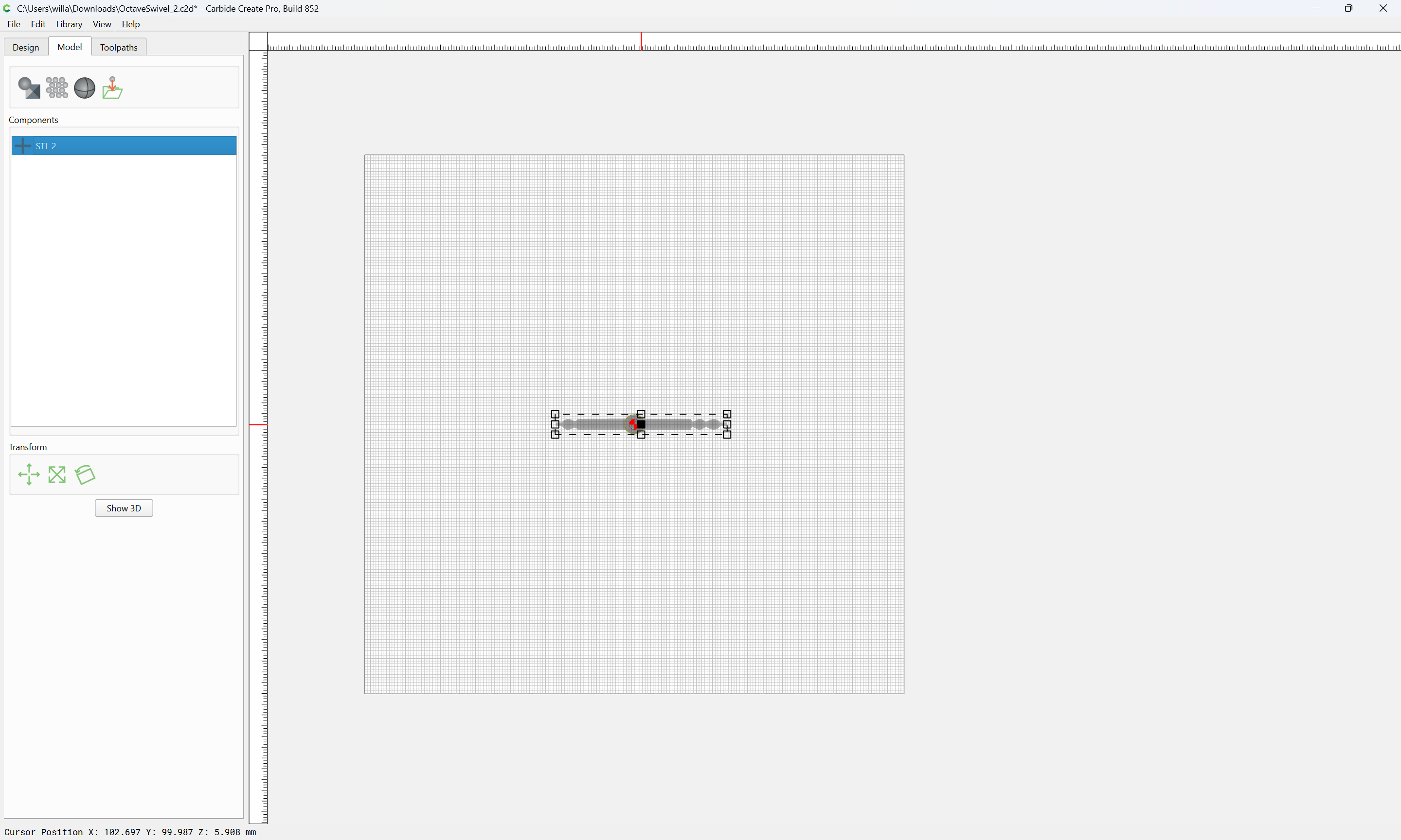

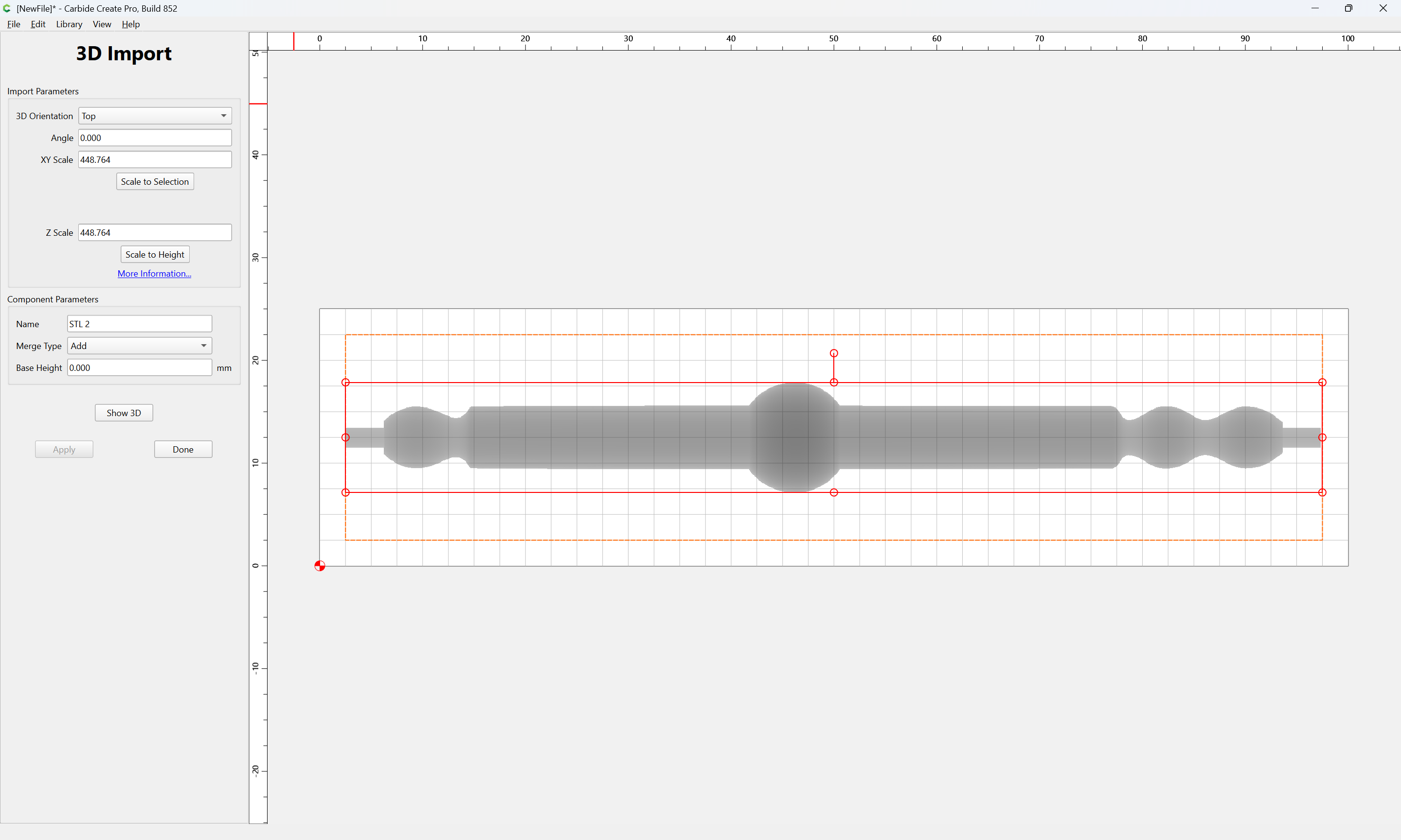

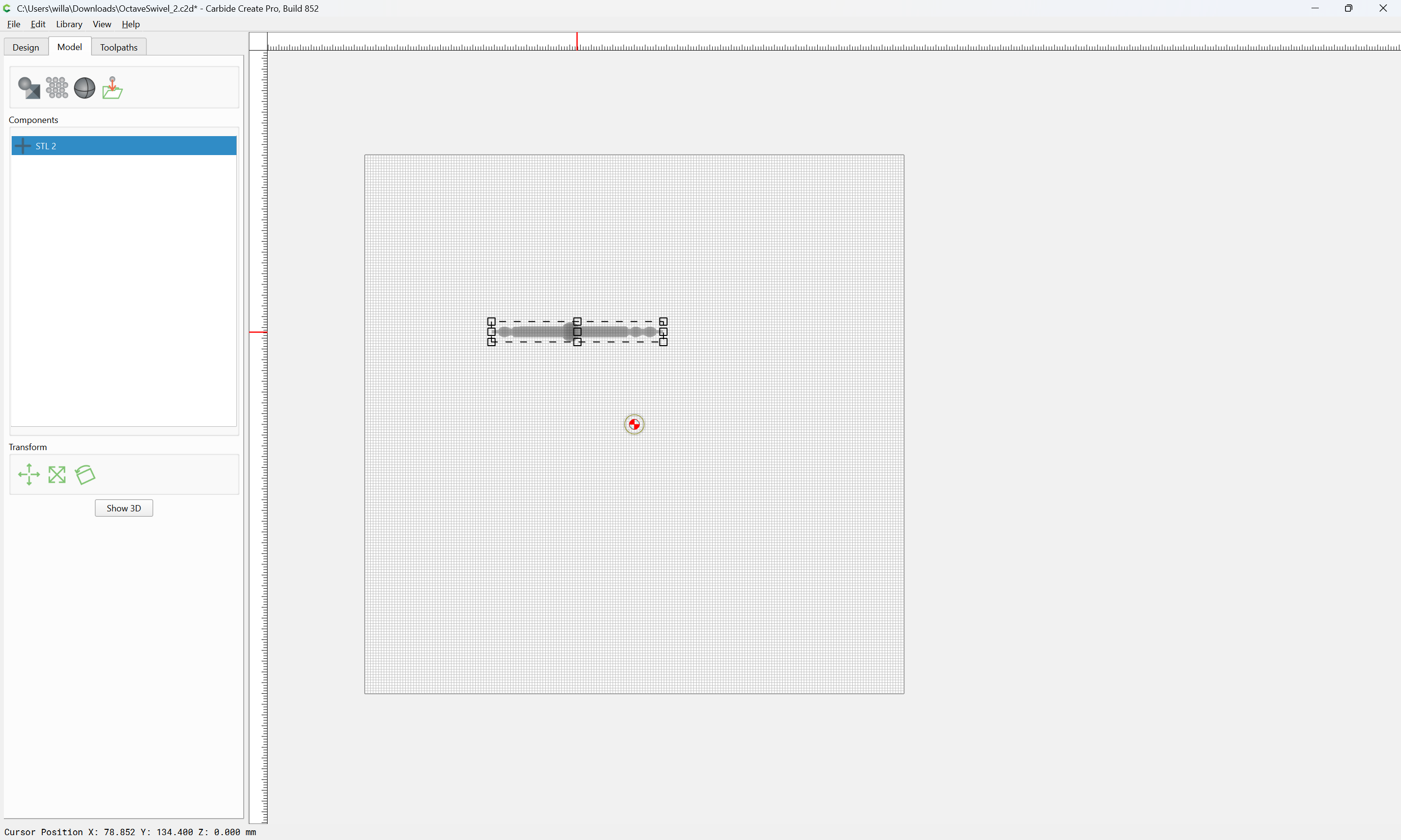

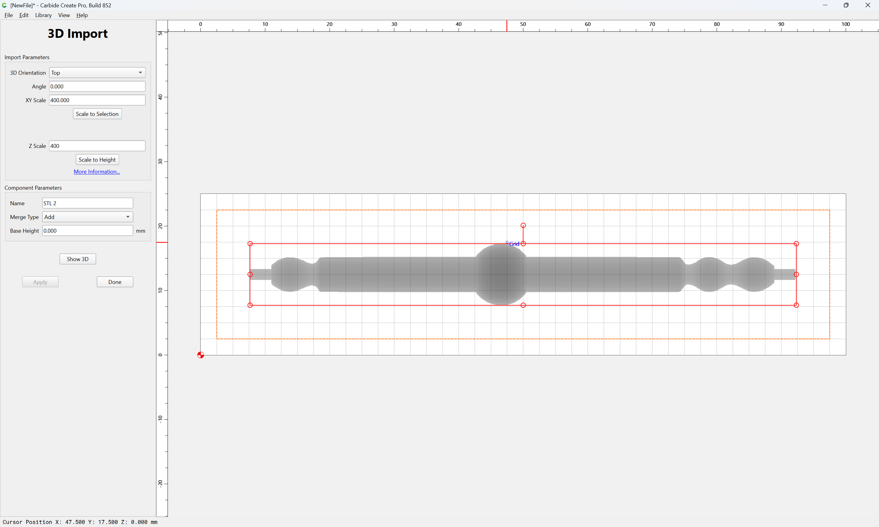

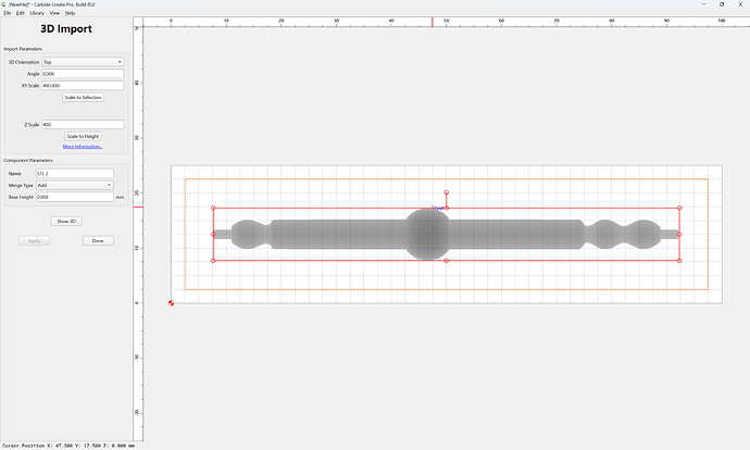

Notice the red bounding box you are positioning when the model is first imported. You can move it all around but once you dismiss that box the model has a "home”. The issues arise when you want to later reposition the model by selecting it in the Model panel and moving it with the black dotted box. That’s the “home” the model will return to after editing and clicking Done.
As mentioned in email I’ve resorted to a bas relief half model. This time I made sure to position it where it needed to be before dismissing the initial red box. This isn’t always as straight forward especially with multiple models and changes of plan but problem solved for this project.

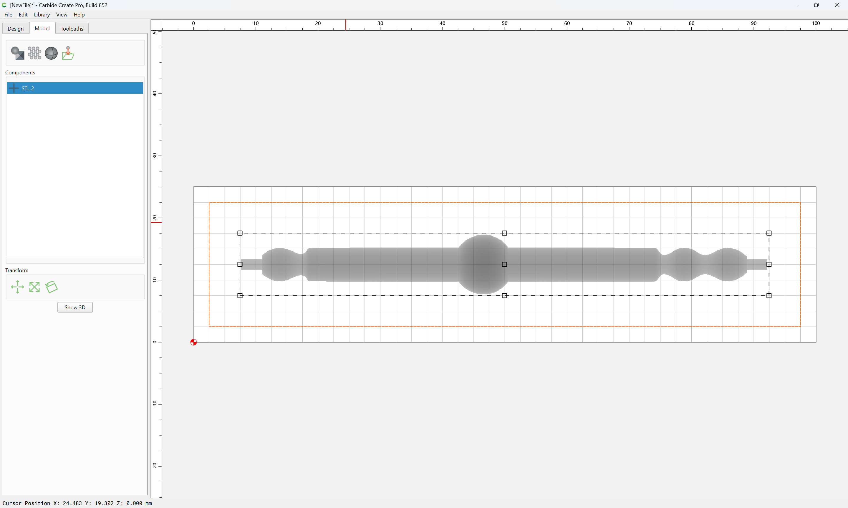

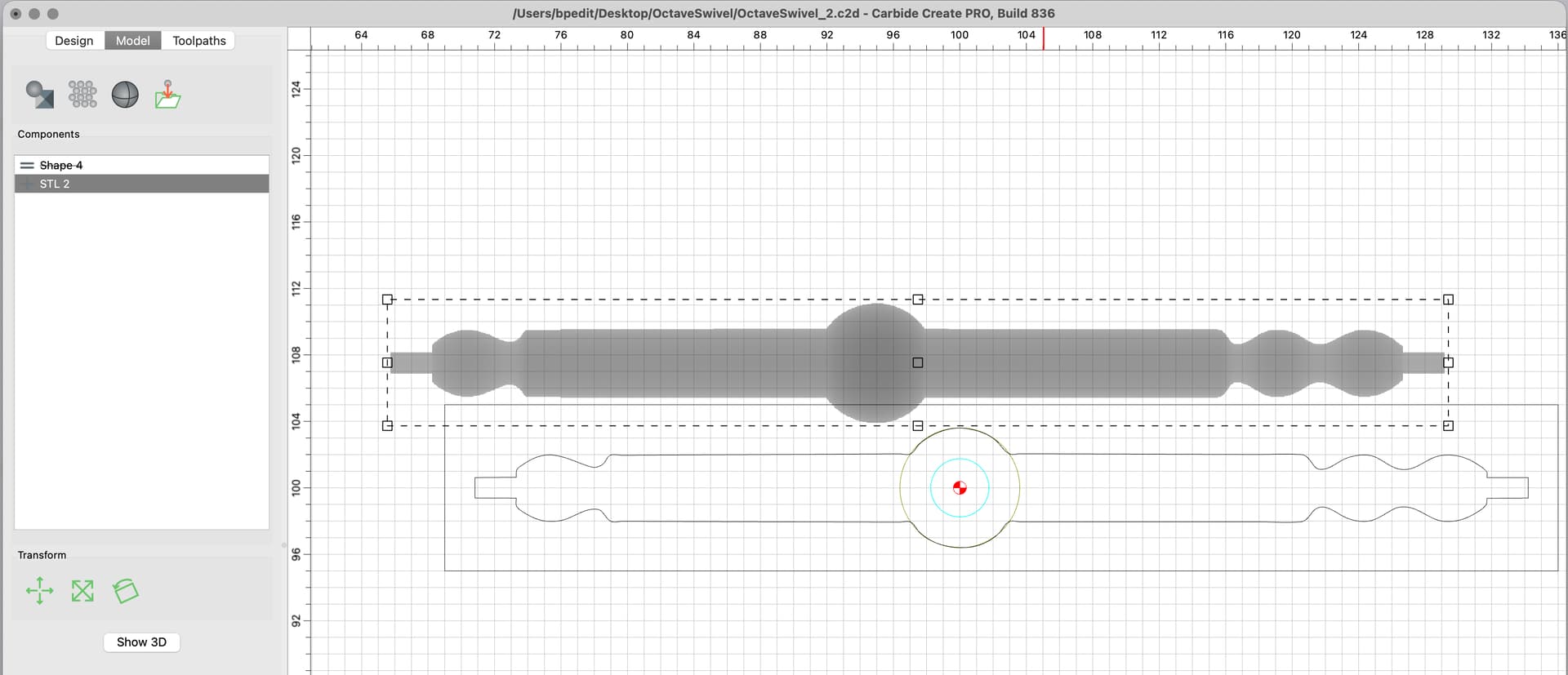

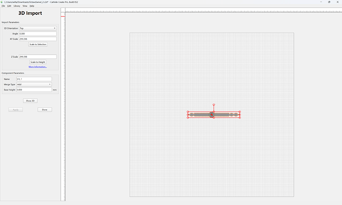

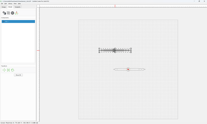

In the re-created file, if I move the STL:
It stays moved.
If I then edit the component it then moves back to the original position:
So, I guess my understanding is the behaviour is that any editing returns the model to the original position (which on re-reading seems to be what you are describing) but which I was having a hard time grasping.
