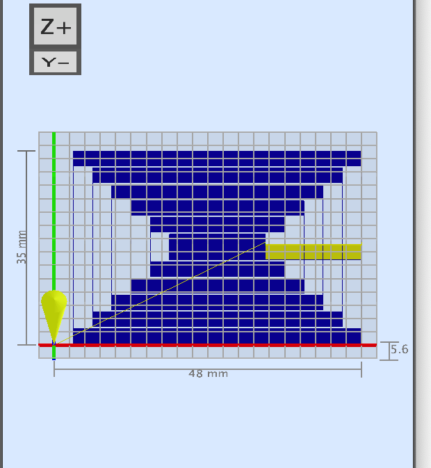

here is a snapshot of UGS
it is cutting outside the boundaries set in CC.
the 6mm bit cut 1/2" or so higher up (from zero than it should have)

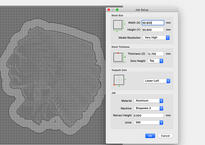

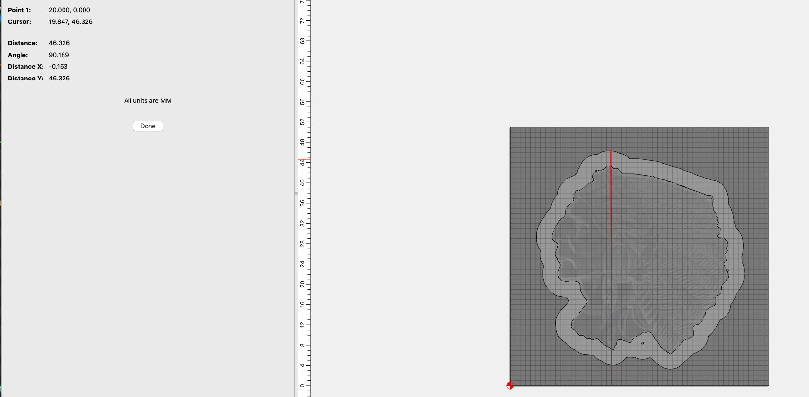

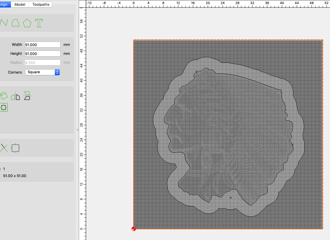

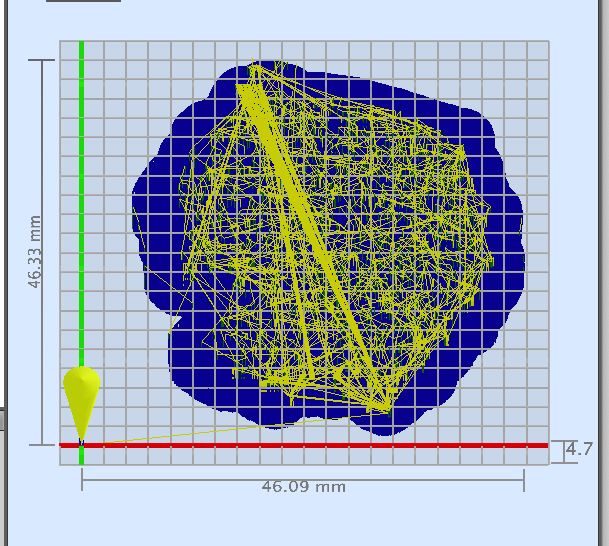

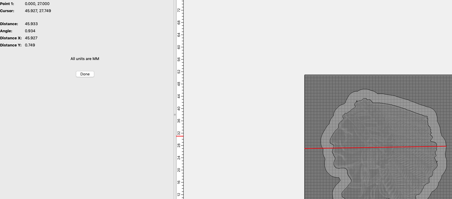

here is another project I ran with mismatched sizes, this one was all 3D. I didnt get to run the finish tool-path, but the rough came out OK, but still the sizes are off
On that indian chief however, I ran the rough from the offset vectors, not from the outside square where the measurement comes from

UGS visualizer is somewhat deceiving, the indian chief project measures correctly… UGS is measuring from the zero lines out to what it needs to cut, not the entire stock or boundary size. This dont explain however why the first project I mentioned cut out of bounds set by CC
