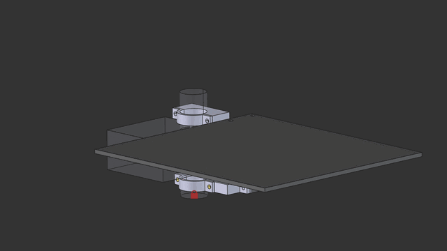

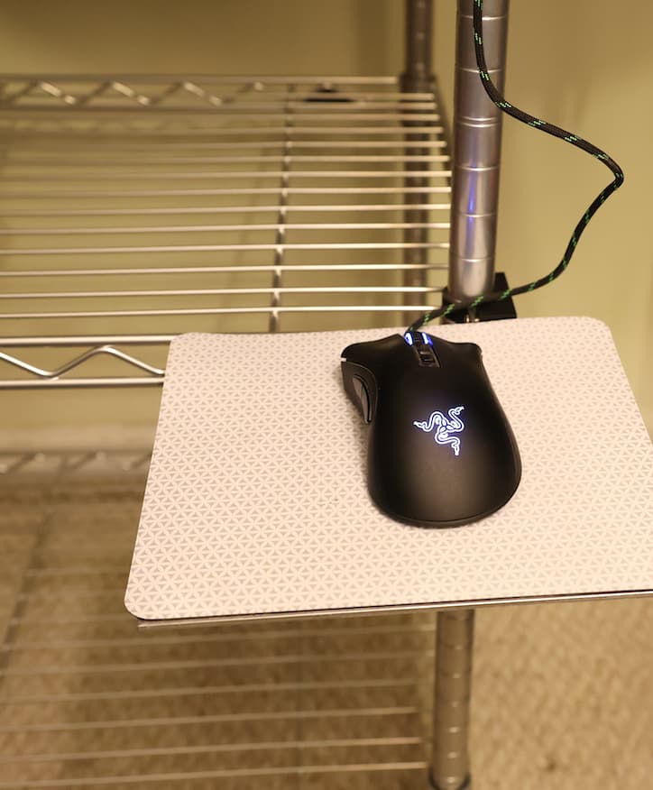

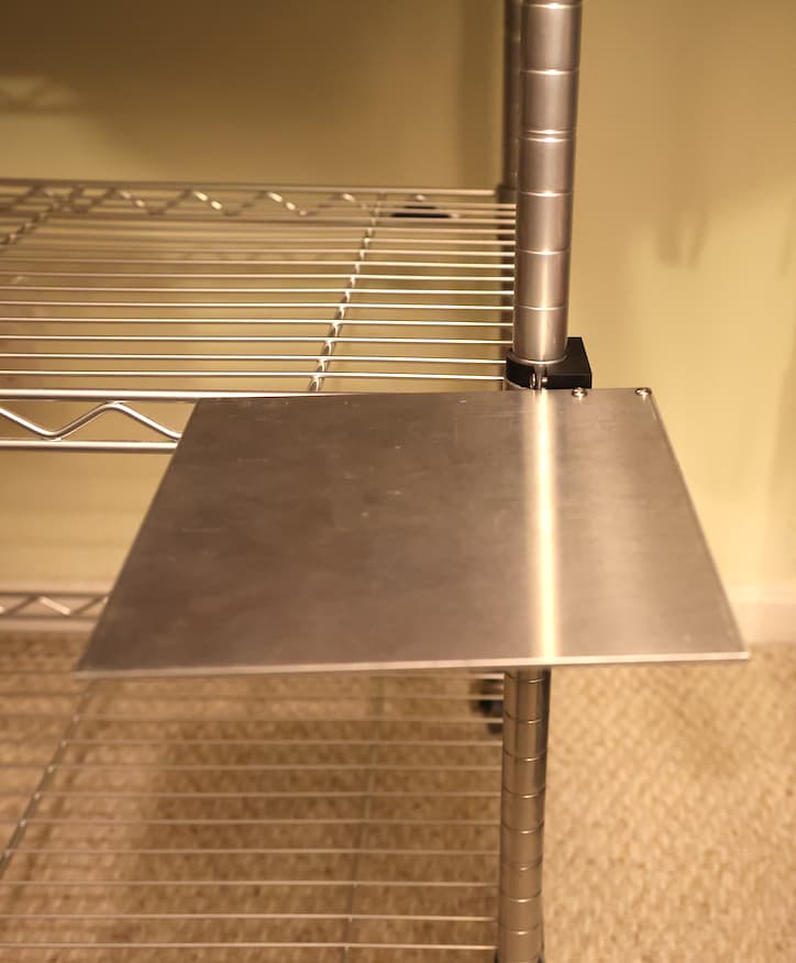

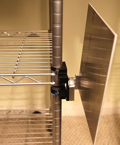

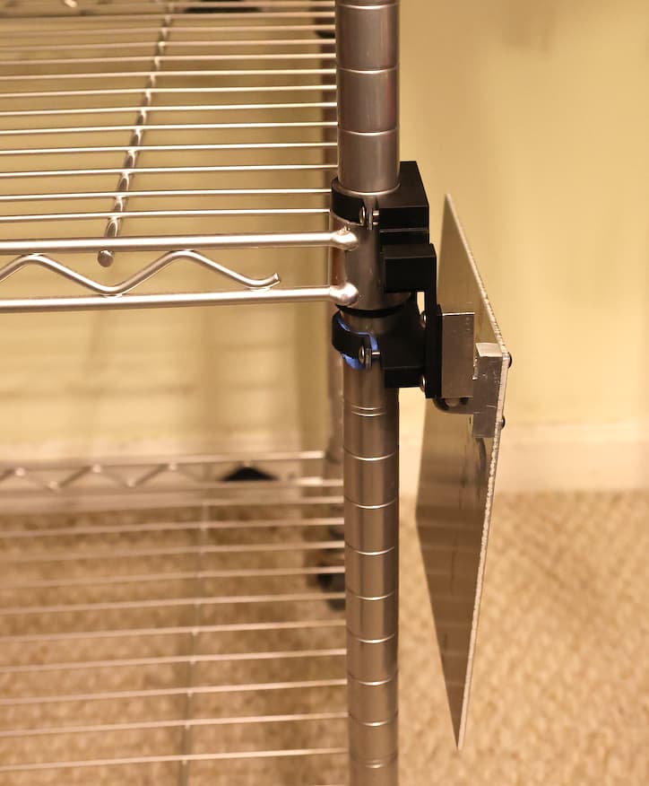

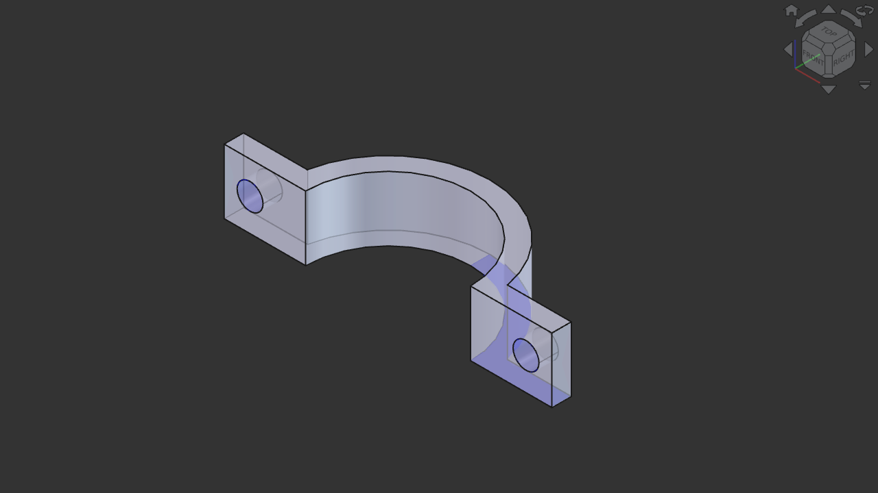

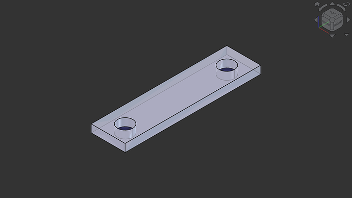

I designed and built a stowable tray for use as a mouse pad table on a standard wire shelving unit.
This is a hybrid design of 3D print (PLA) and milled aluminum (1/8", 1/2" and 3/4" 6061). Workholding fixtures are 3D printed.
Animation
Parts:
1x Bracket
2x Bracket Clamps
1x Bracket Shim
1x Table
2x Joint
4x Joint Bushing
1x Linkage
2x Linkage Bushing
2x Clevis Pins with Retaining Ring
8x M4 machine screws
Bracket

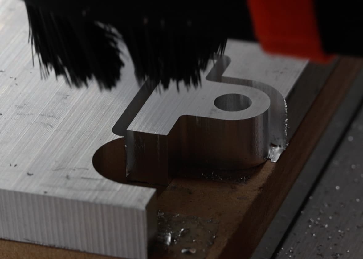

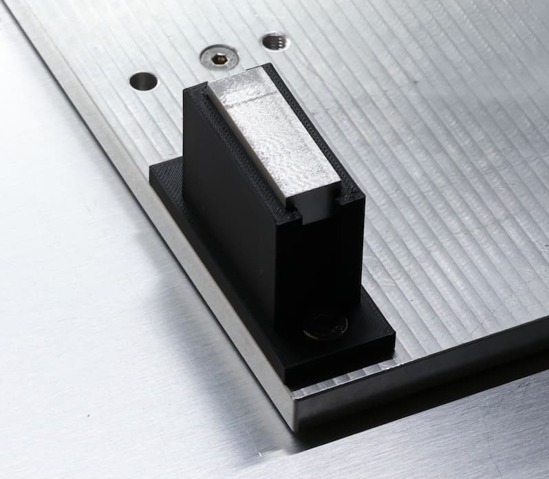

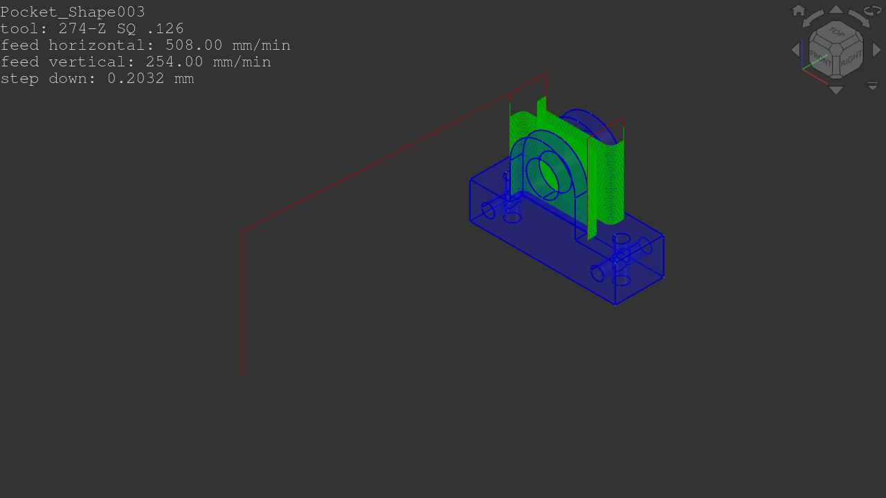

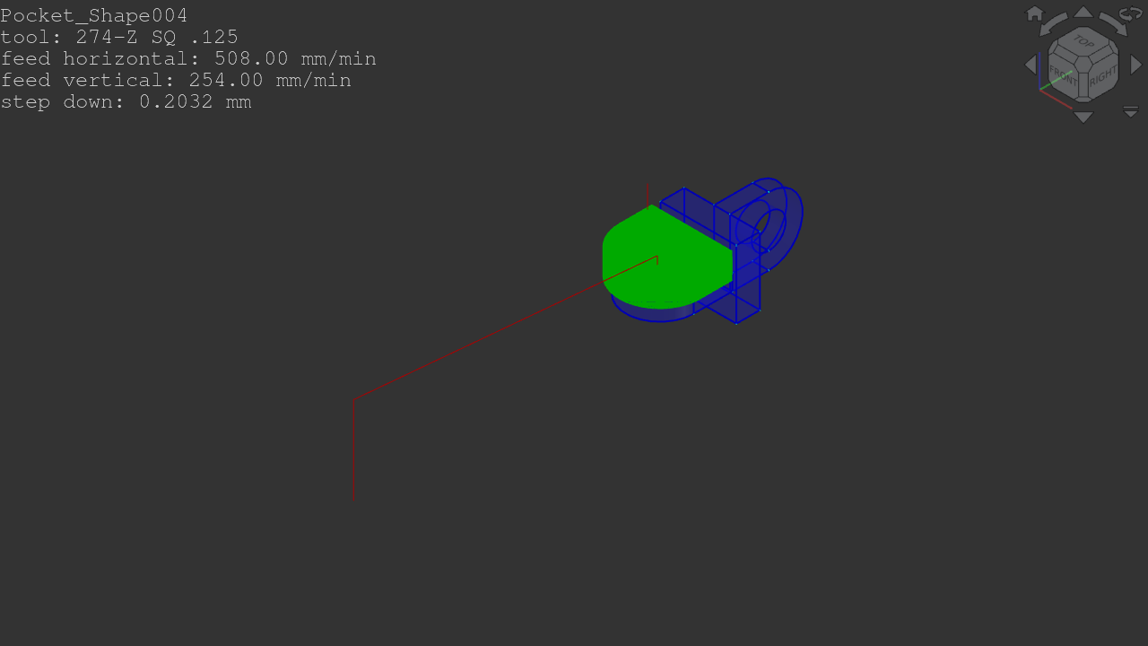

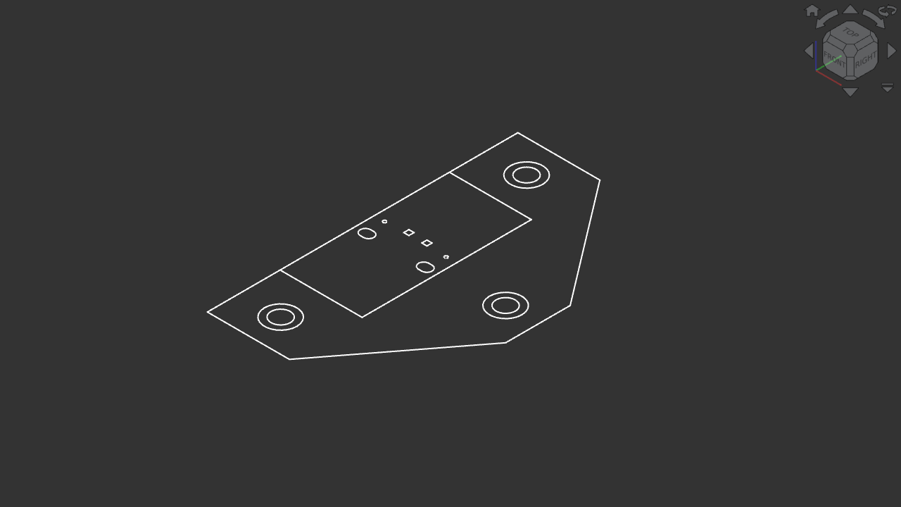

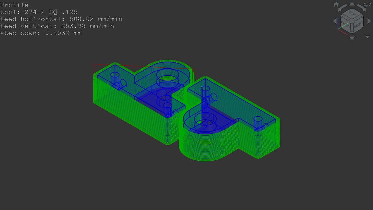

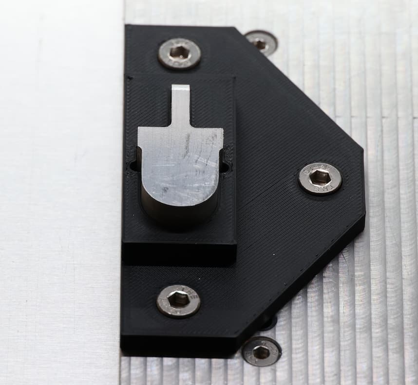

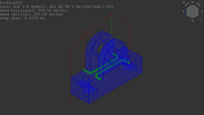

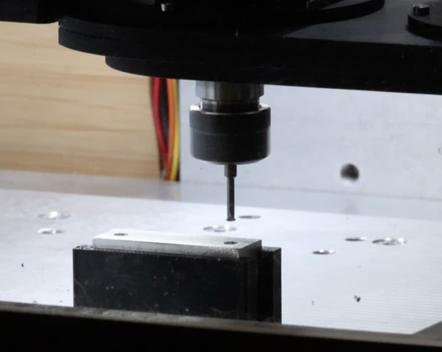

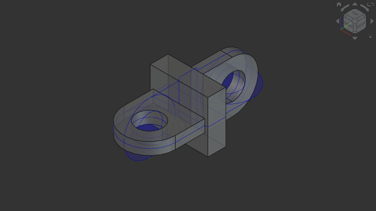

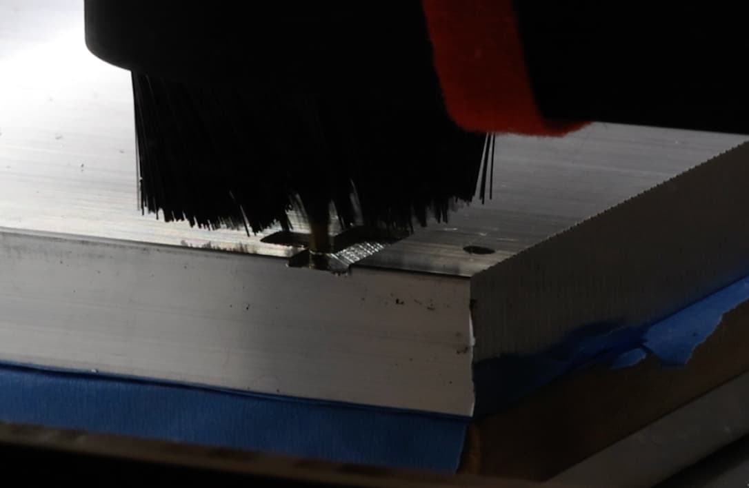

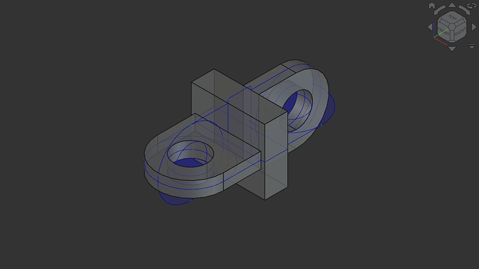

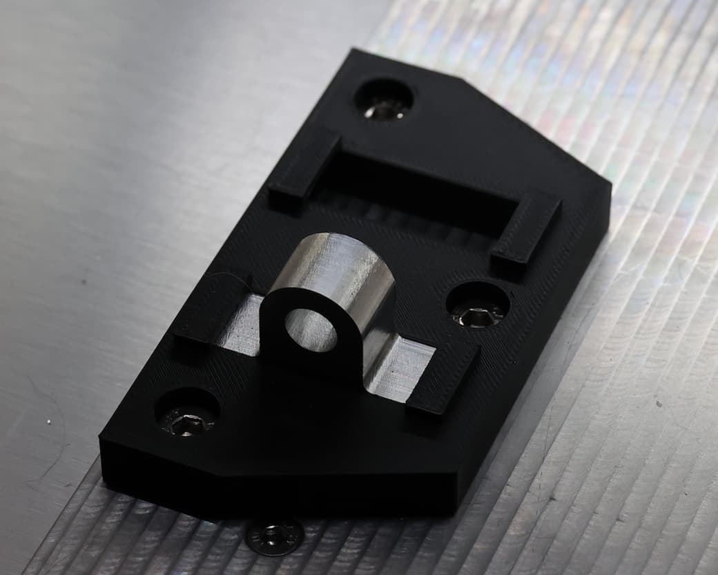

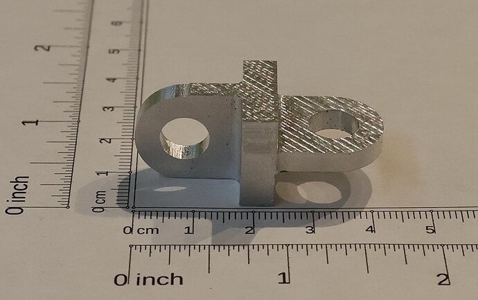

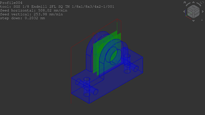

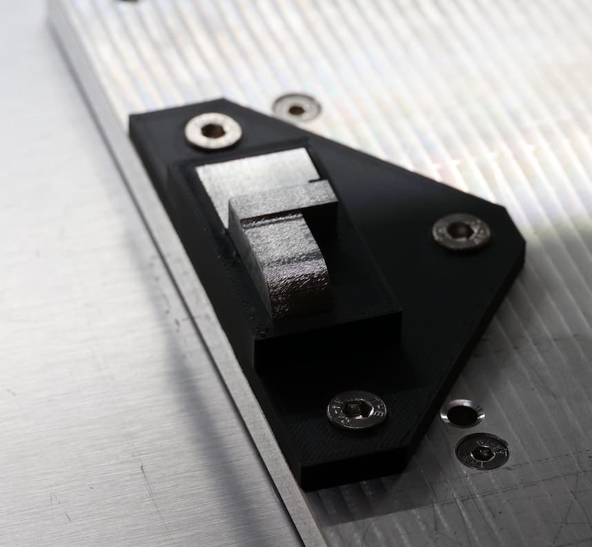

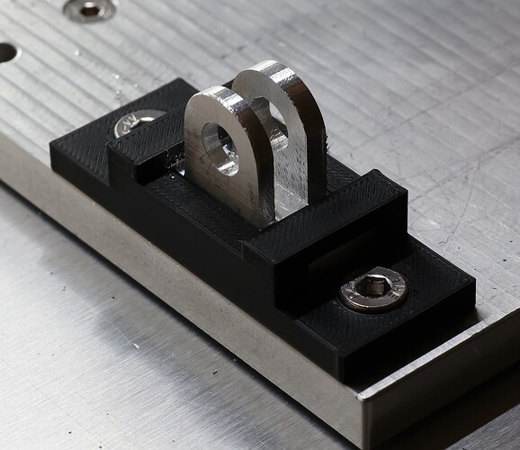

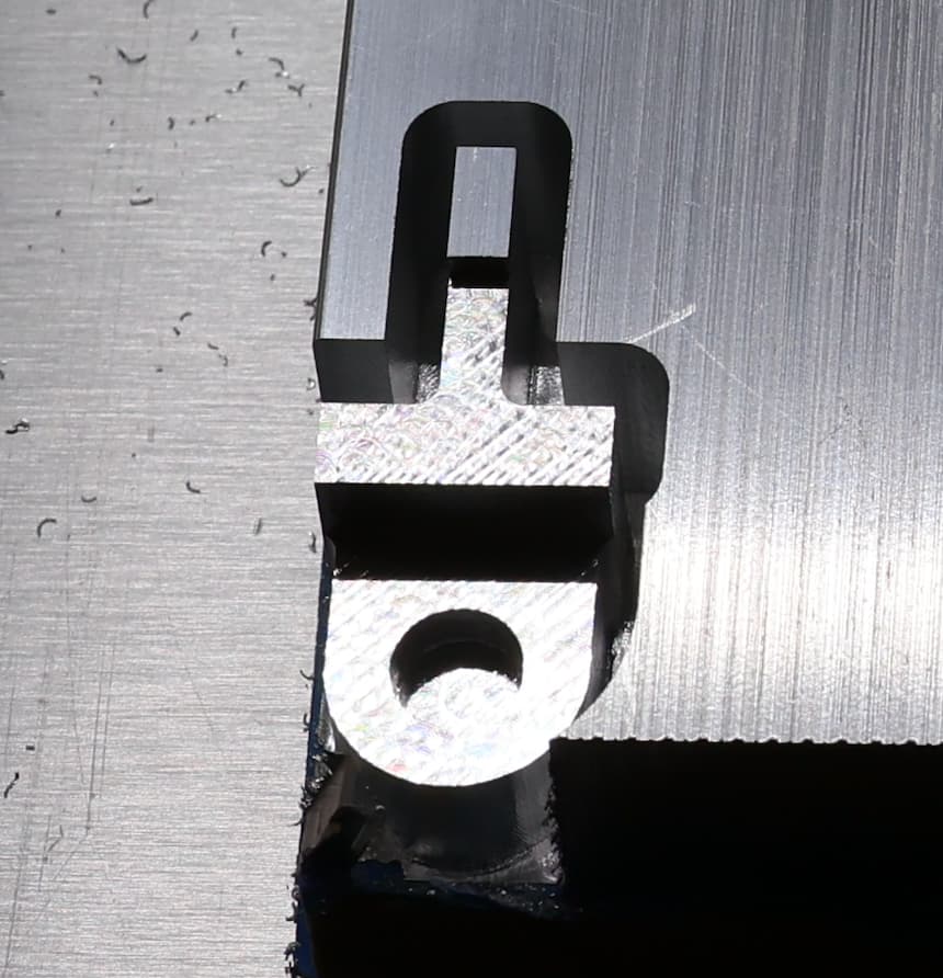

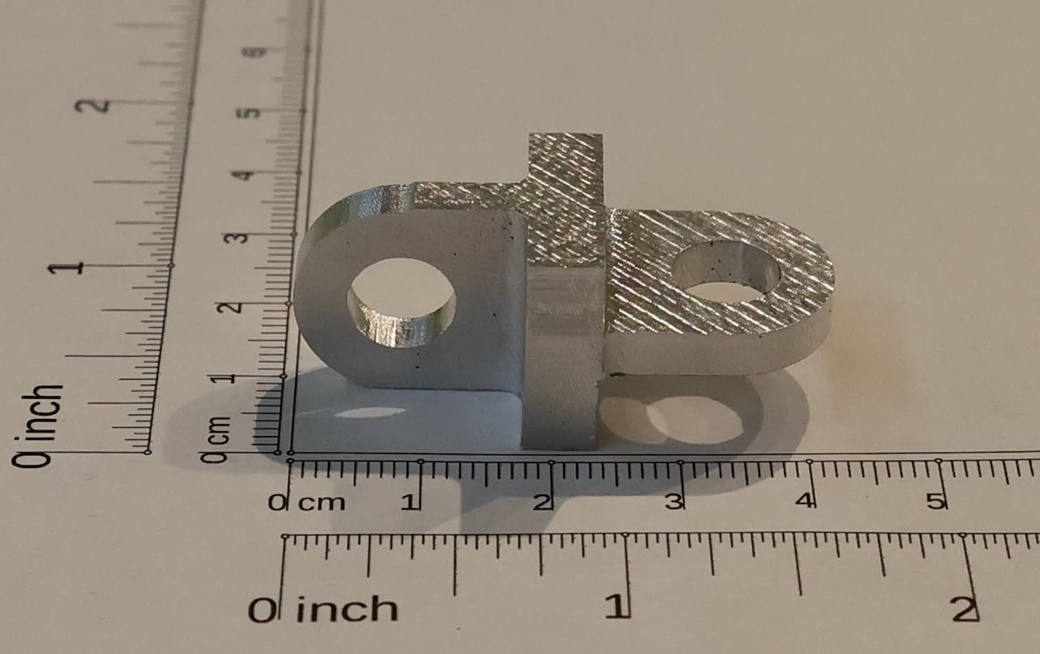

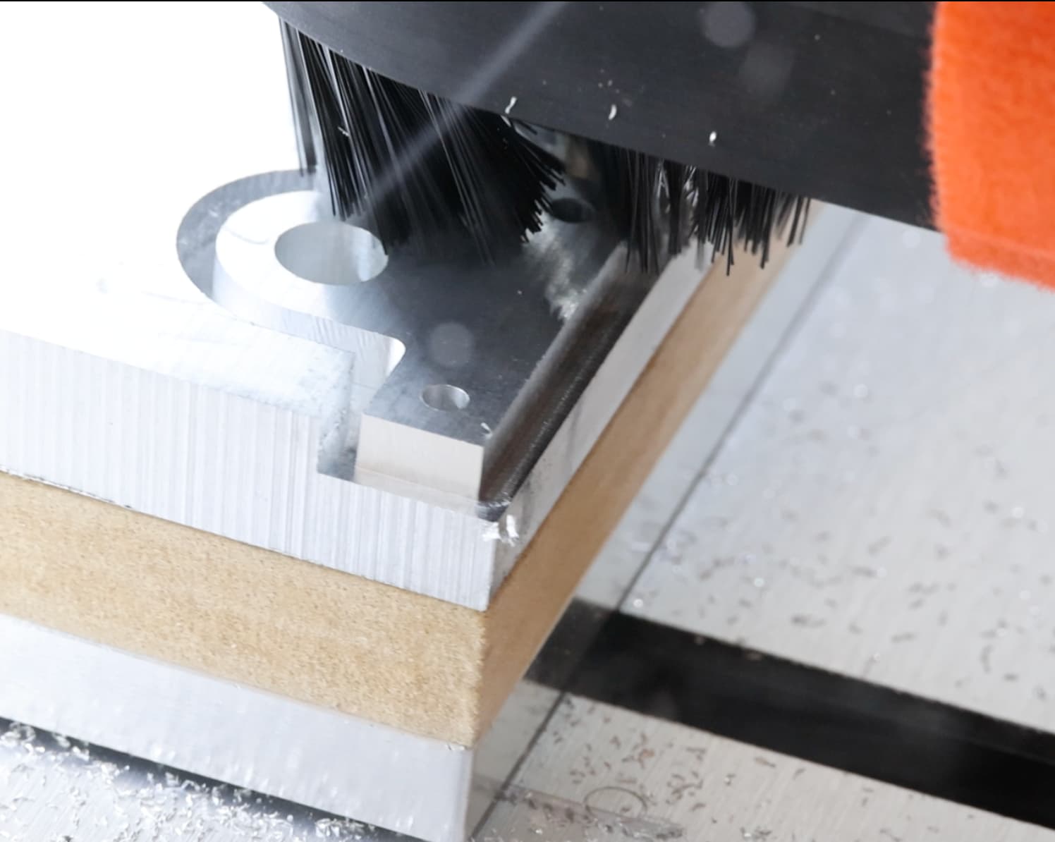

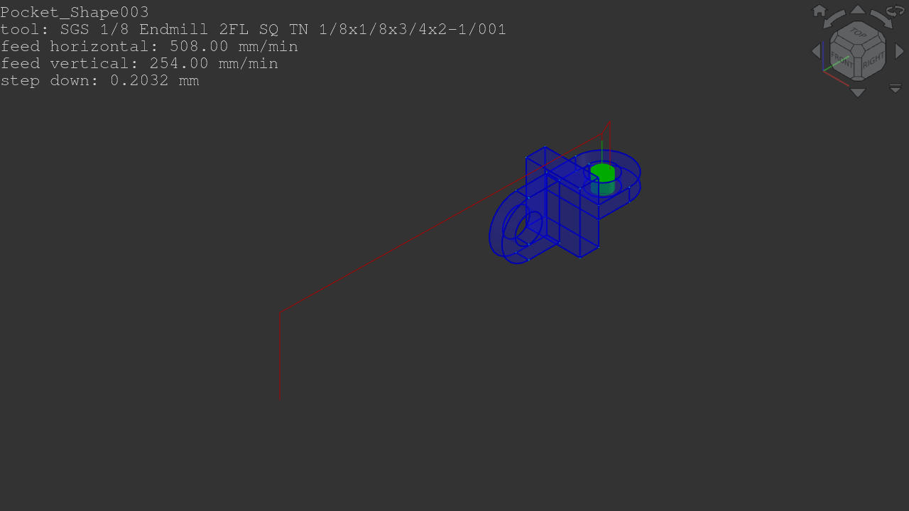

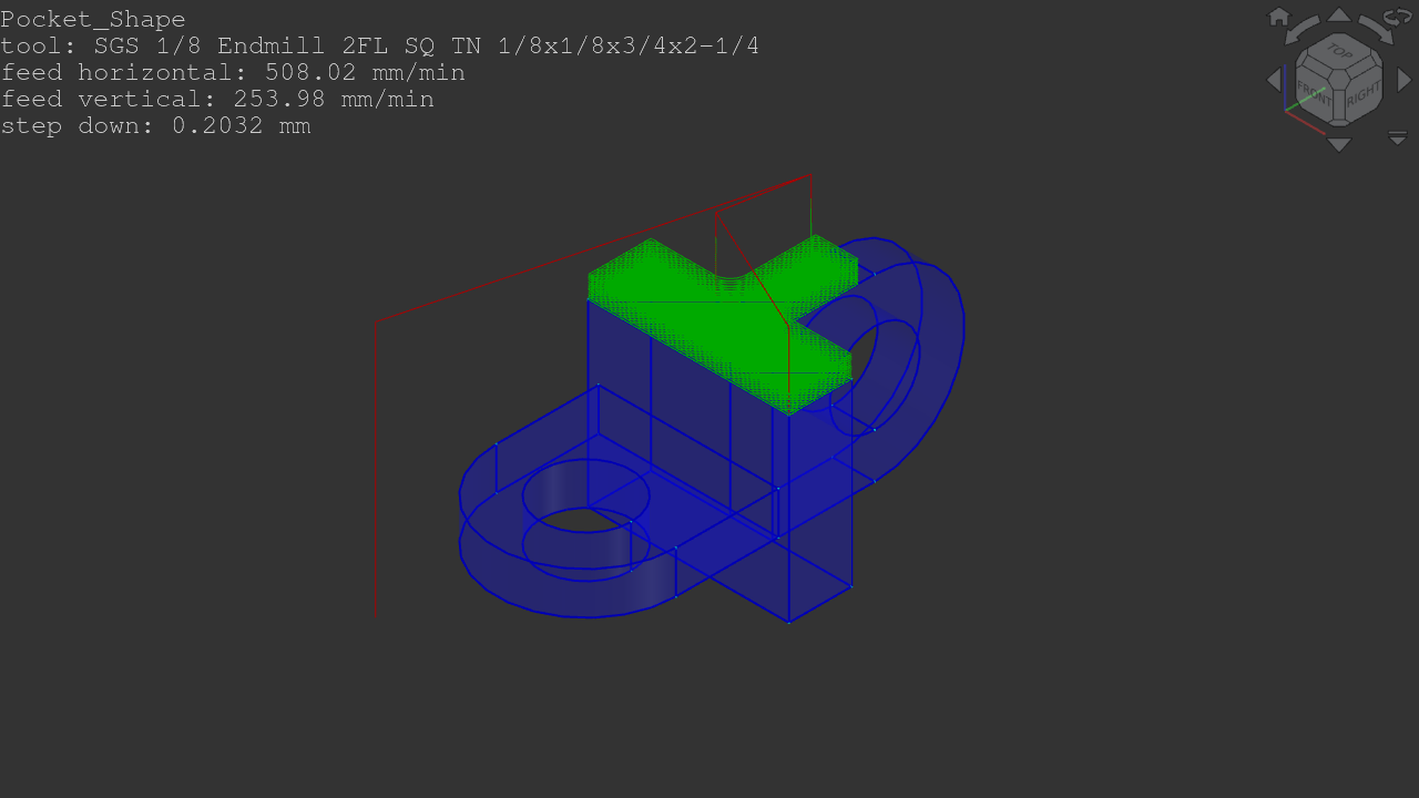

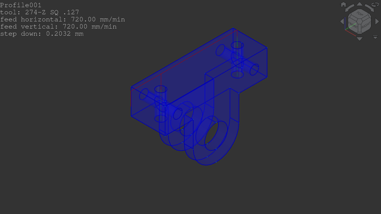

Joints are cut from 1/2" aluminum 6061. Initially I set up the jobs for two parts at a time. Subsequently I lost a part to a broken tap, and switched to single part cutting workflow.
Feeds and speeds are generally 20ipm/10ipm horizontal/vertical. Prefer the 1FL ZrN SQ.
Double cutout
This first part has pilot holes drilled for hand tapping. The second part will receive pilot holes in a different operation.
The fixtures are press-fit
Slotting

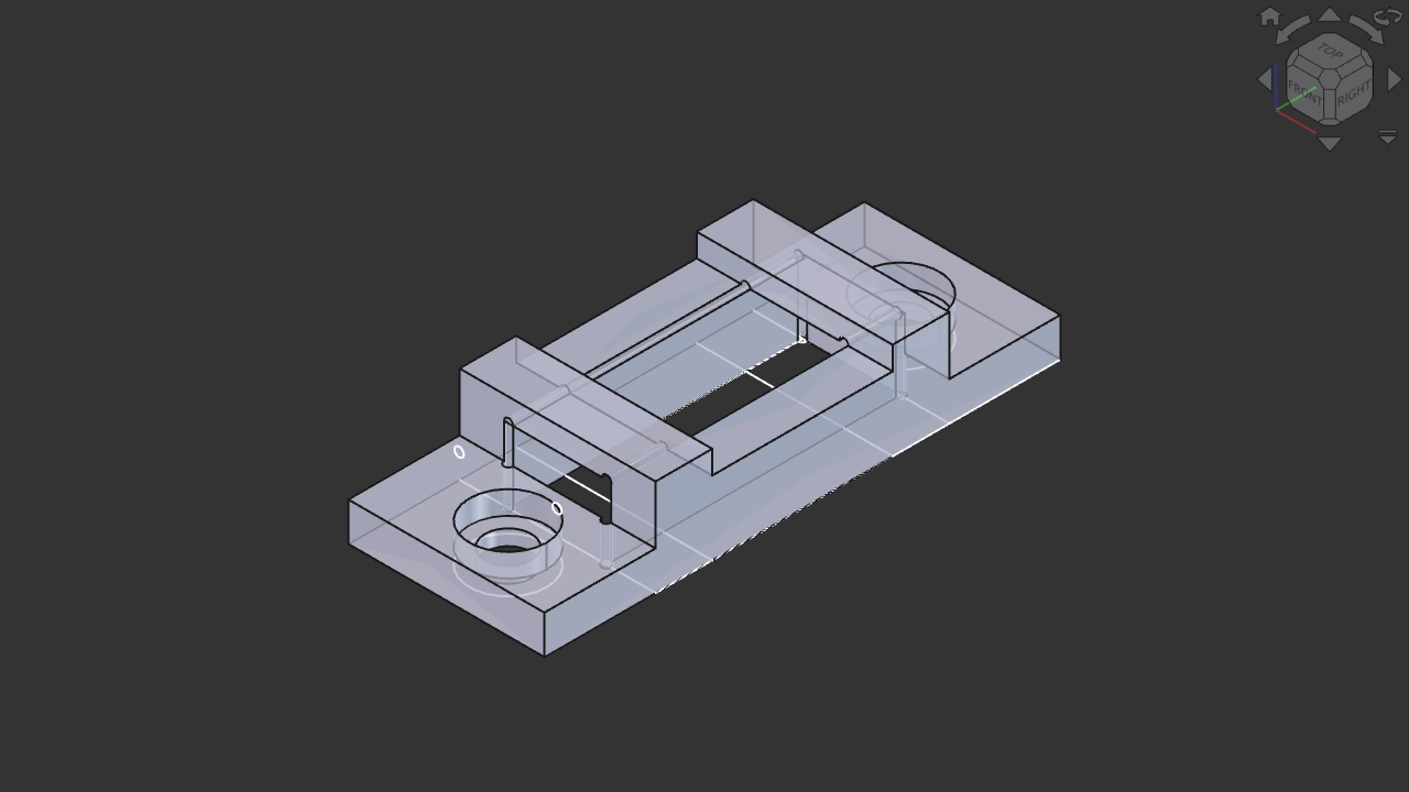

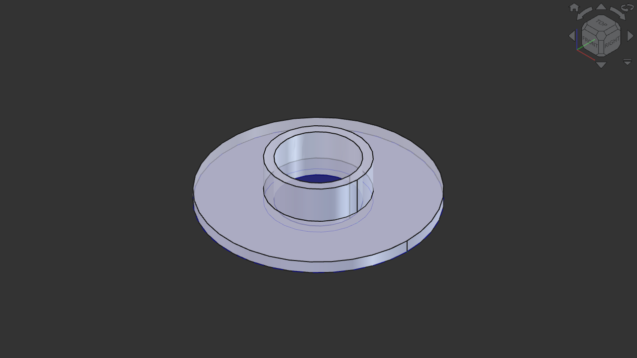

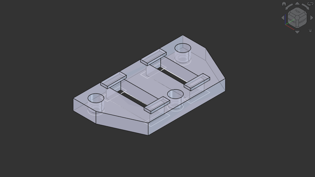

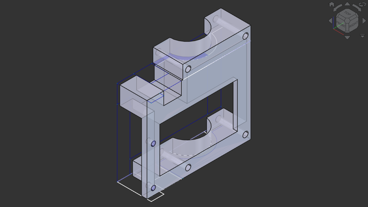

Fixturing Design:
CAM Paths:
Result:

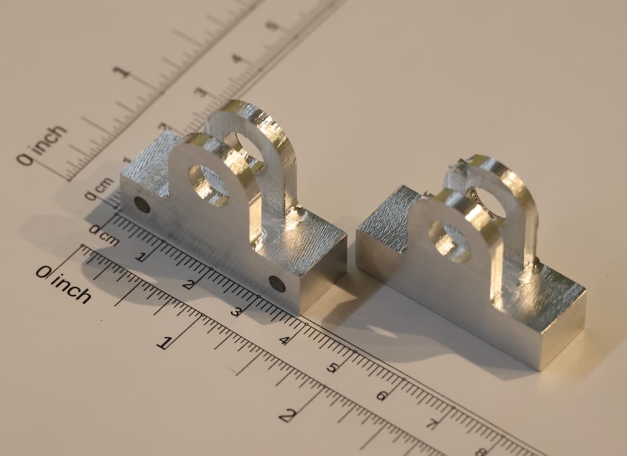

After slotting. The unfinished part on the right has extra material removed by an offset error, and was subsequently re-cut after the hand tap broke inside it.

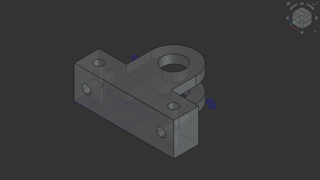

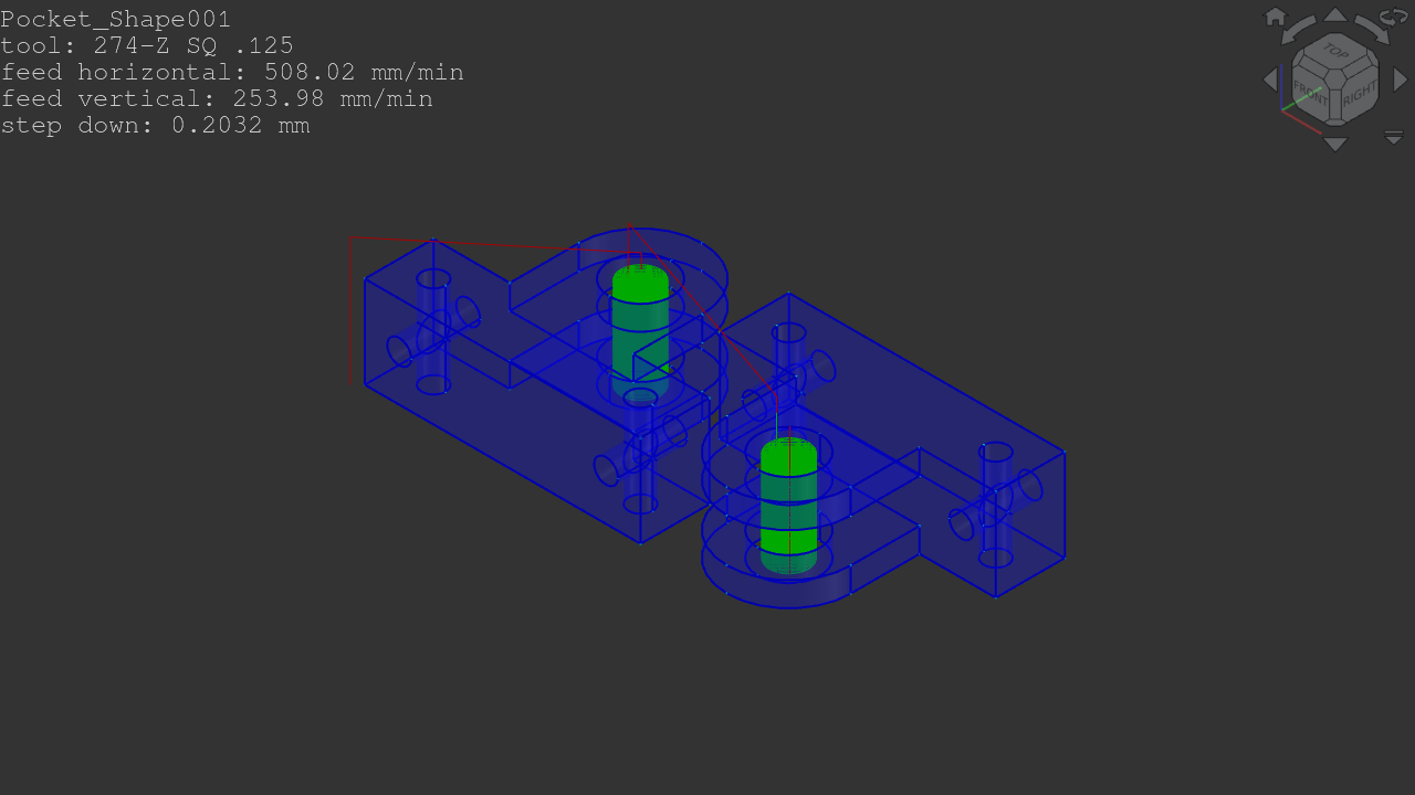

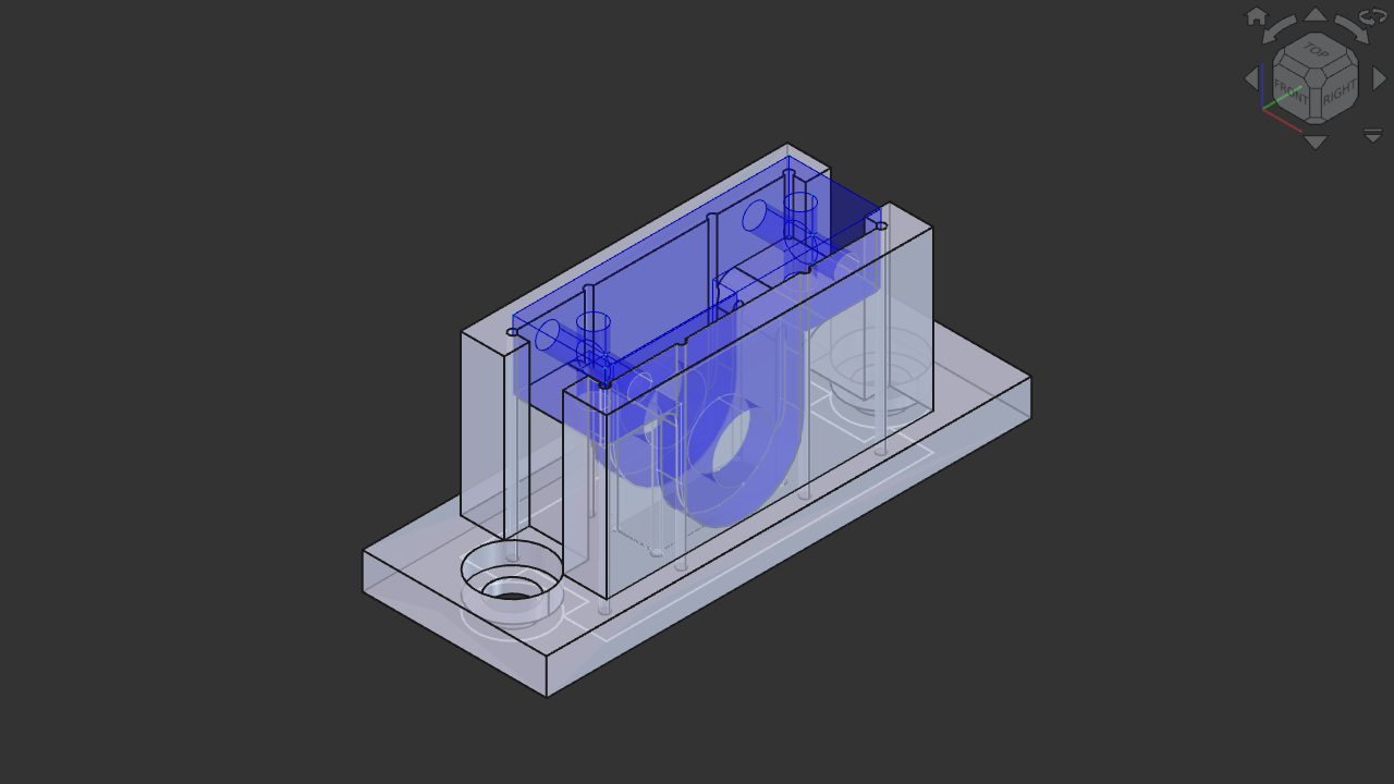

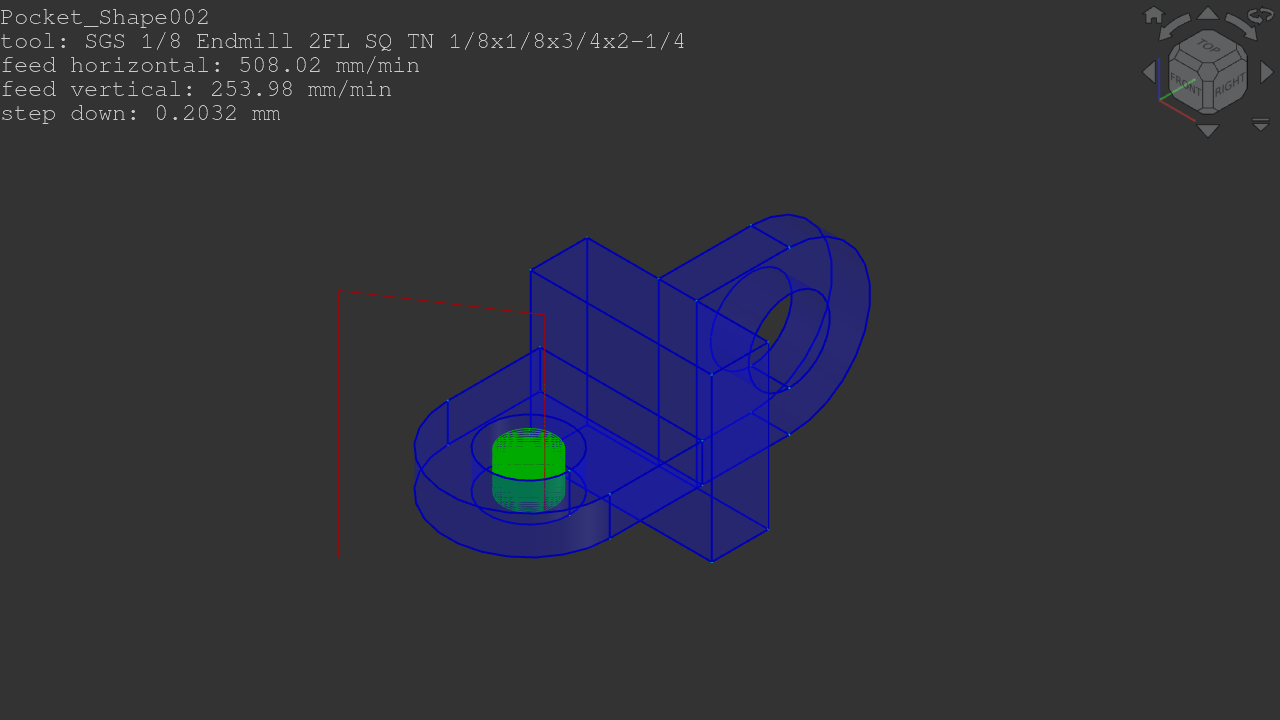

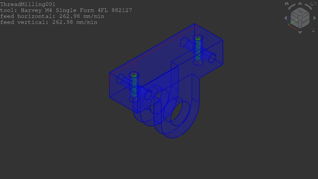

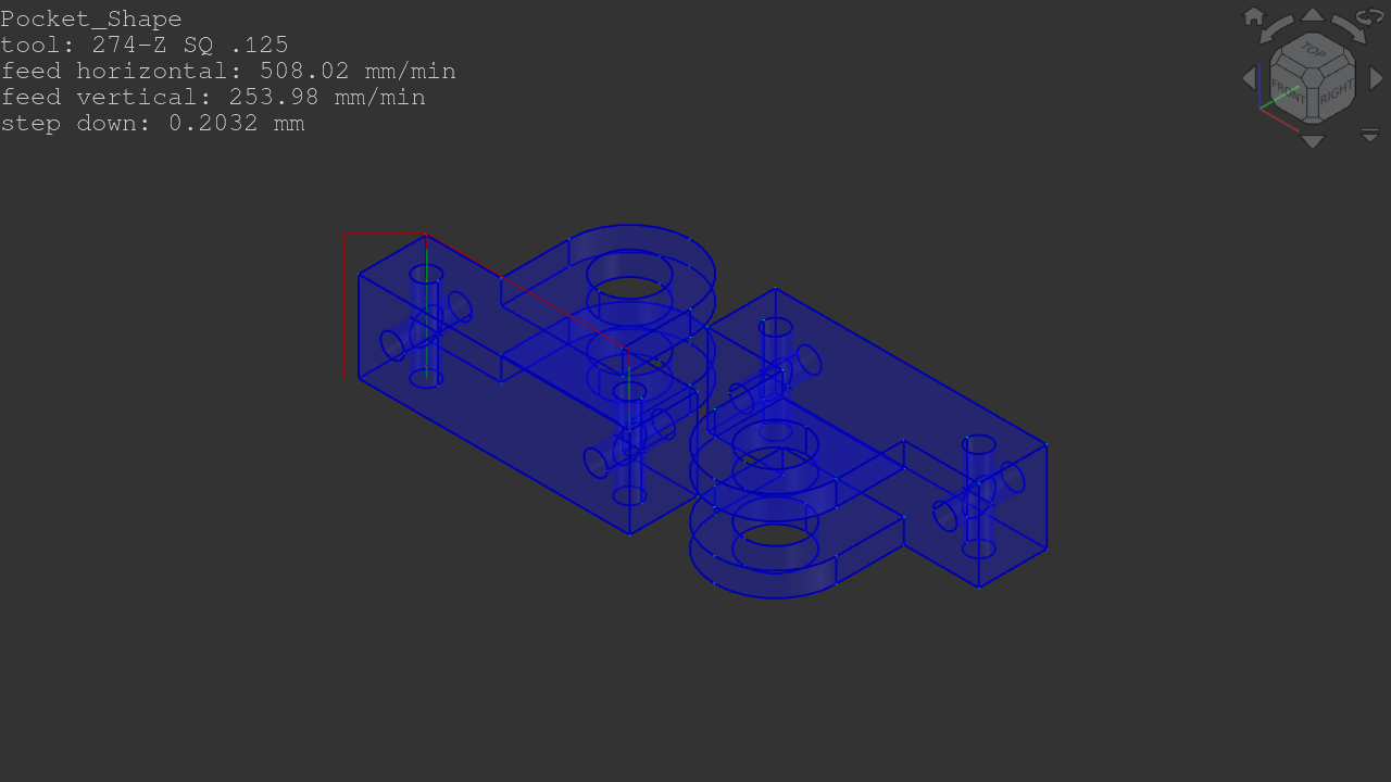

Drilling
Fixturing Design:
CAM Paths:
Threadmilling:

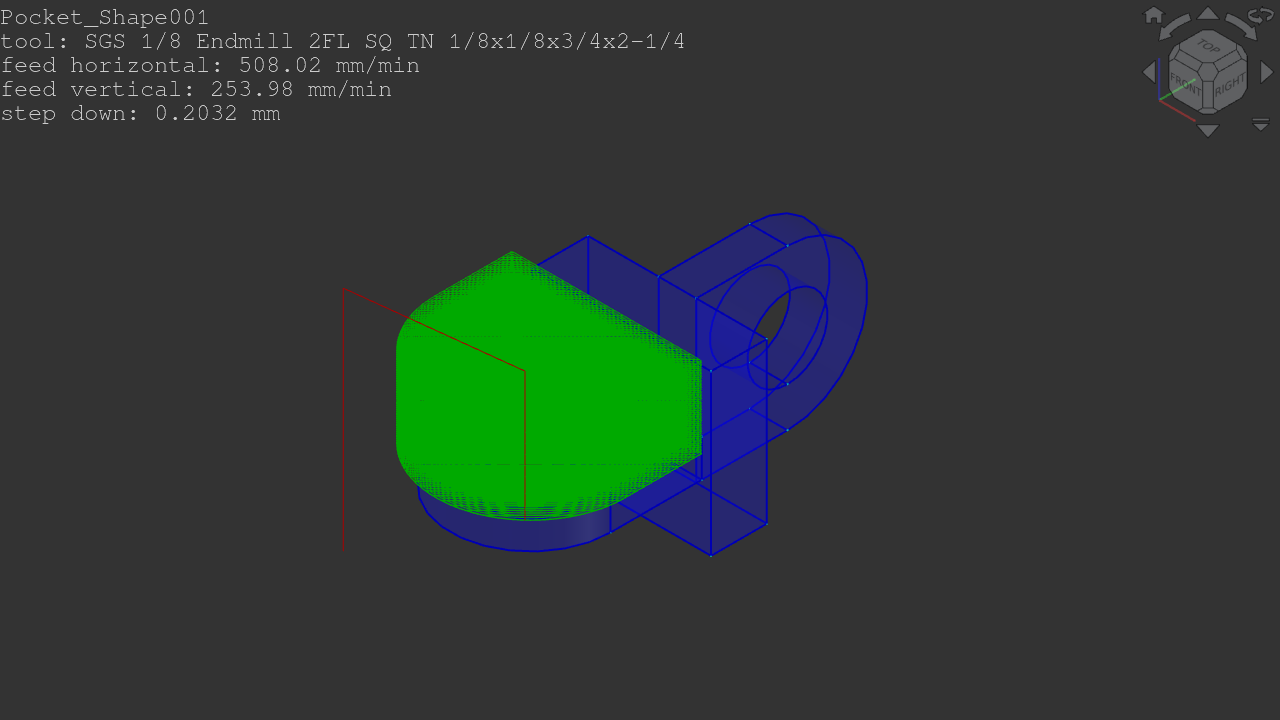

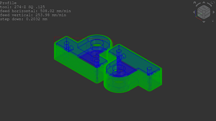

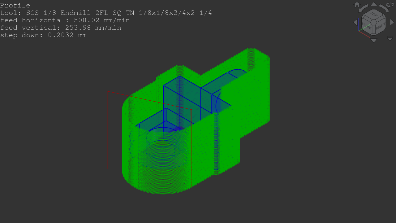

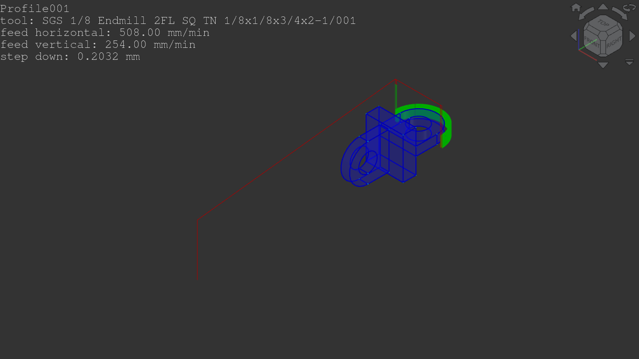

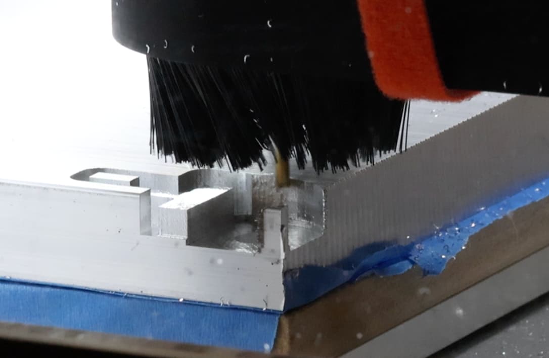

Linkage is cut from 3/4" 6061 aluminum plate
Cutout
CAM operations:
Photos:
Cut 2
Fixturing:
CAM Paths:
Photos:
Cut 3
Fixturing:
CAM Path:
Photos:

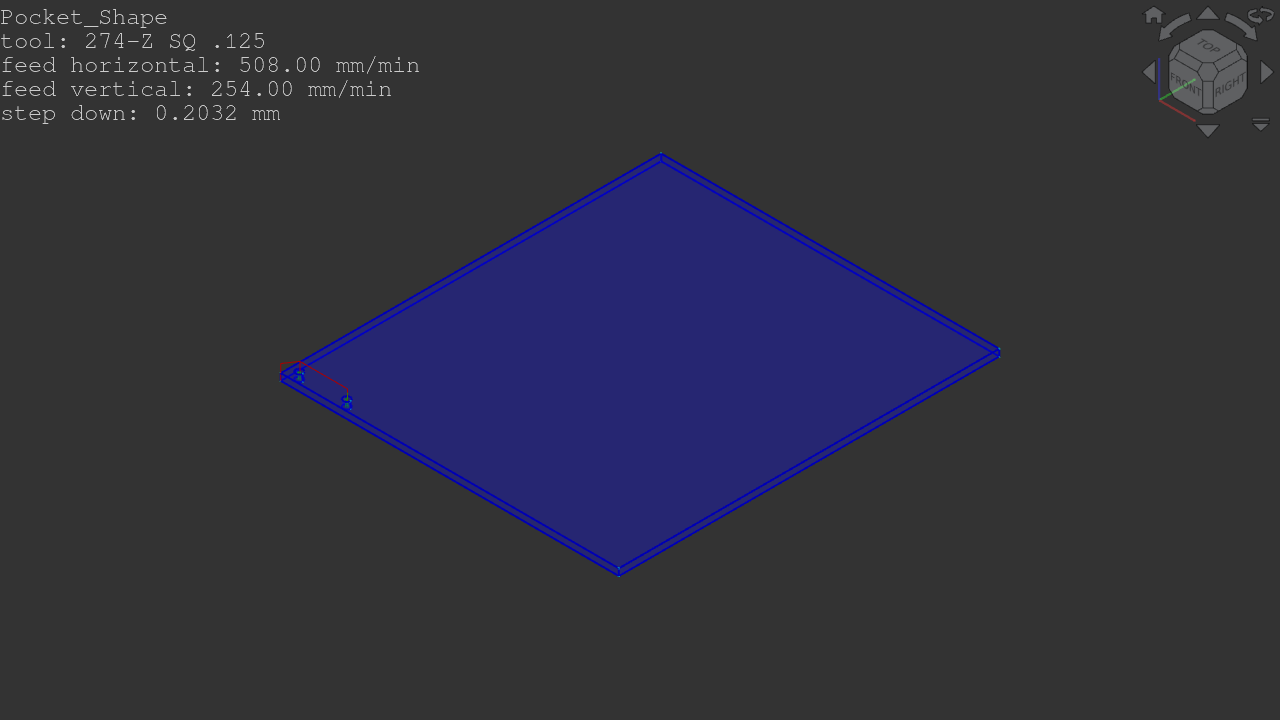

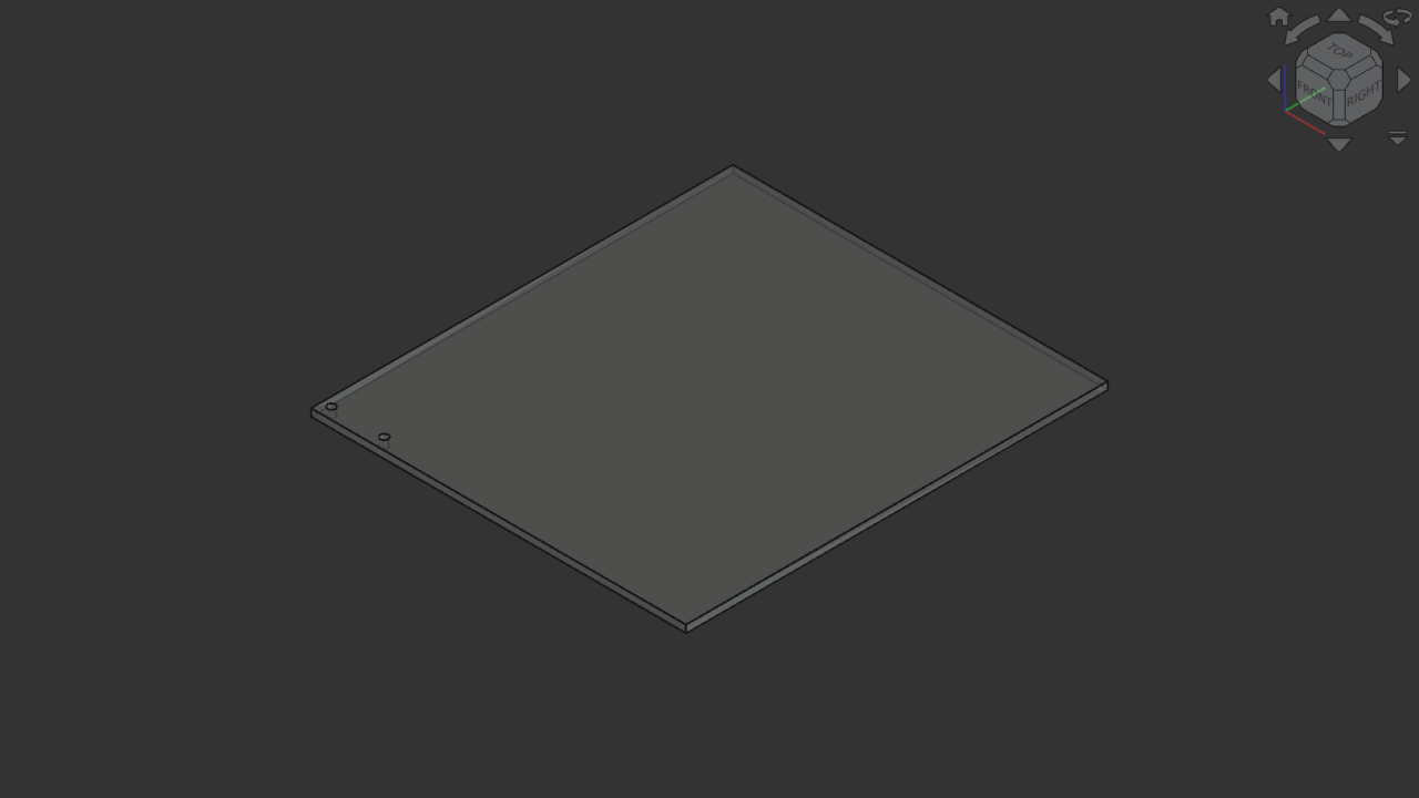

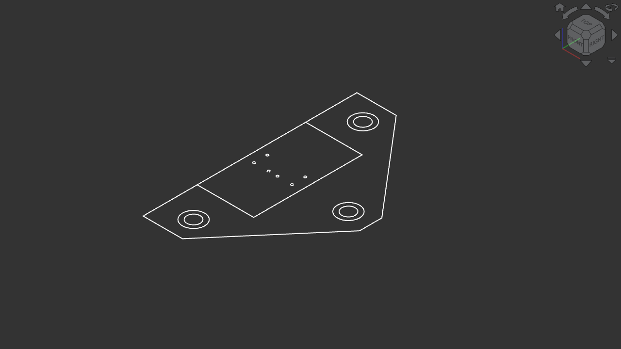

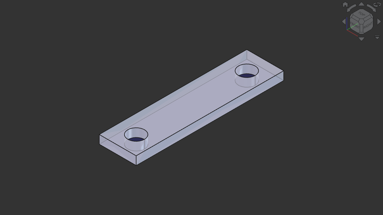

The table is 8x8x1/8 6061. Two milled holes.
