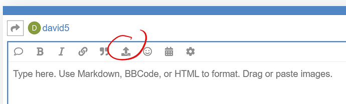

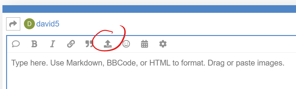

Where do I find the upload icon?
It’s in the toolbar when you make a reply:
