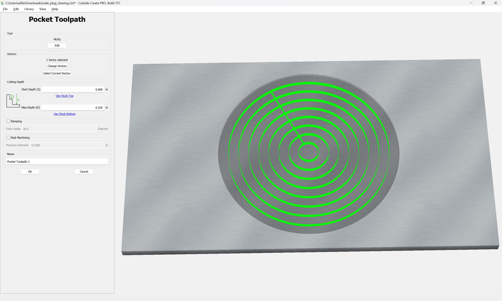

I upgraded to CC 756 and made a job to cut a plug off for an inlay. The simulation seems strange. Instead of a pocket I got a bunch of concentric circles.
I unchecked the tool path and expected to see the pocket.
Here is the c2d file.
male_plug_clearing.c2d (168 KB)
Did they change something in CC 756 or is this a bug?

How did you define the tool #6201 Fly cutter?

Here is the custom tool database for the #601 Whiteside Fly Bit.
number
vendor
model
URL
name
type
diameter
cornerradius
flutelength
shaftdiameter
angle
numflutes
stickout
coating
metric
notes
machine
material
plungerate
feedrate
rpm
depth
cutpower
finishallowance
3dstepover
3dfeedrate
3drpm
601
whiteside
6210
601 Fly Cutter 6201
end
1
0
0.25
0
2
3
0.25
0
10
80
16000
0.01
1
35
80
16000
WillAdams
(William Adams (Carbide 3D))
March 29, 2023, 11:46pm
4
Works fine when I change to a McFly:
check and see how that definition differs?
