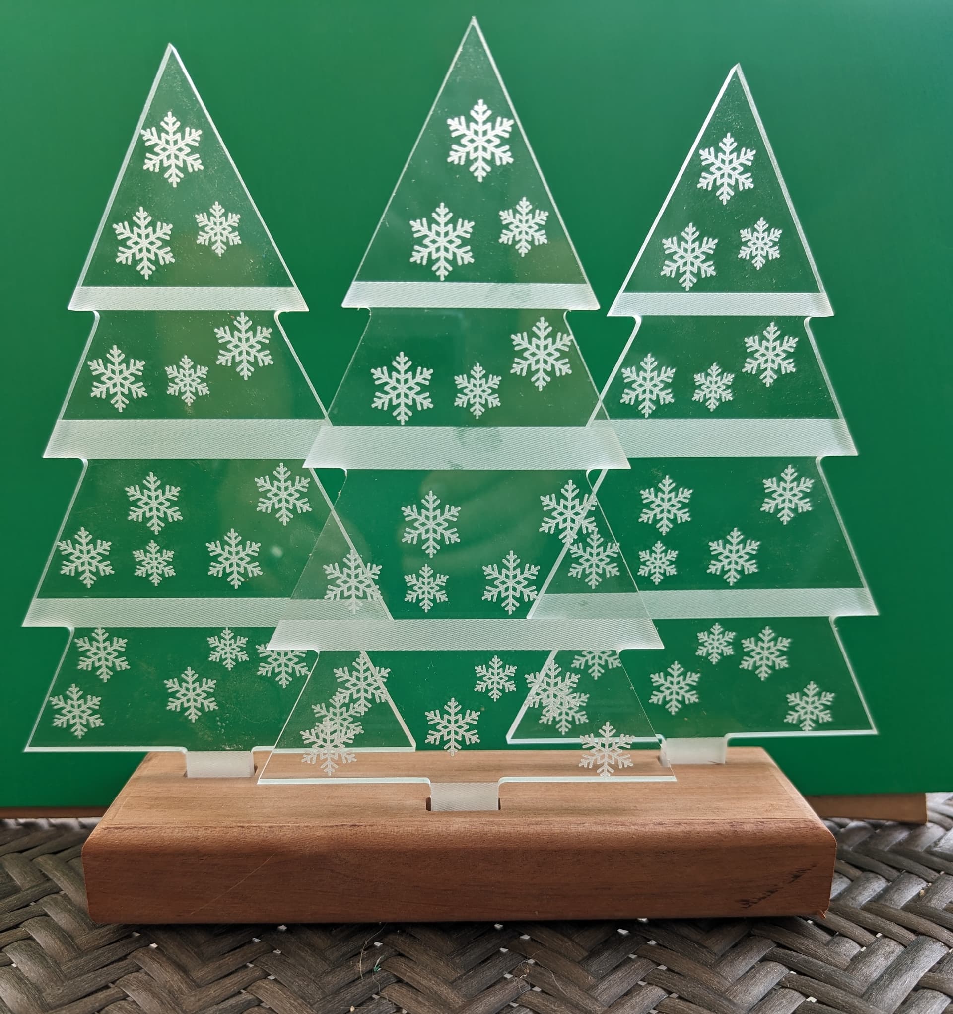

I haven’t tried acrylic etching yet. That’s on my short list.
Those trees
Look great.
Is that a lighted tree project with the base containing LED lights?

I tweaked the settings and finished the set.
Now I need to start cutting the plaques these will be attached to.
