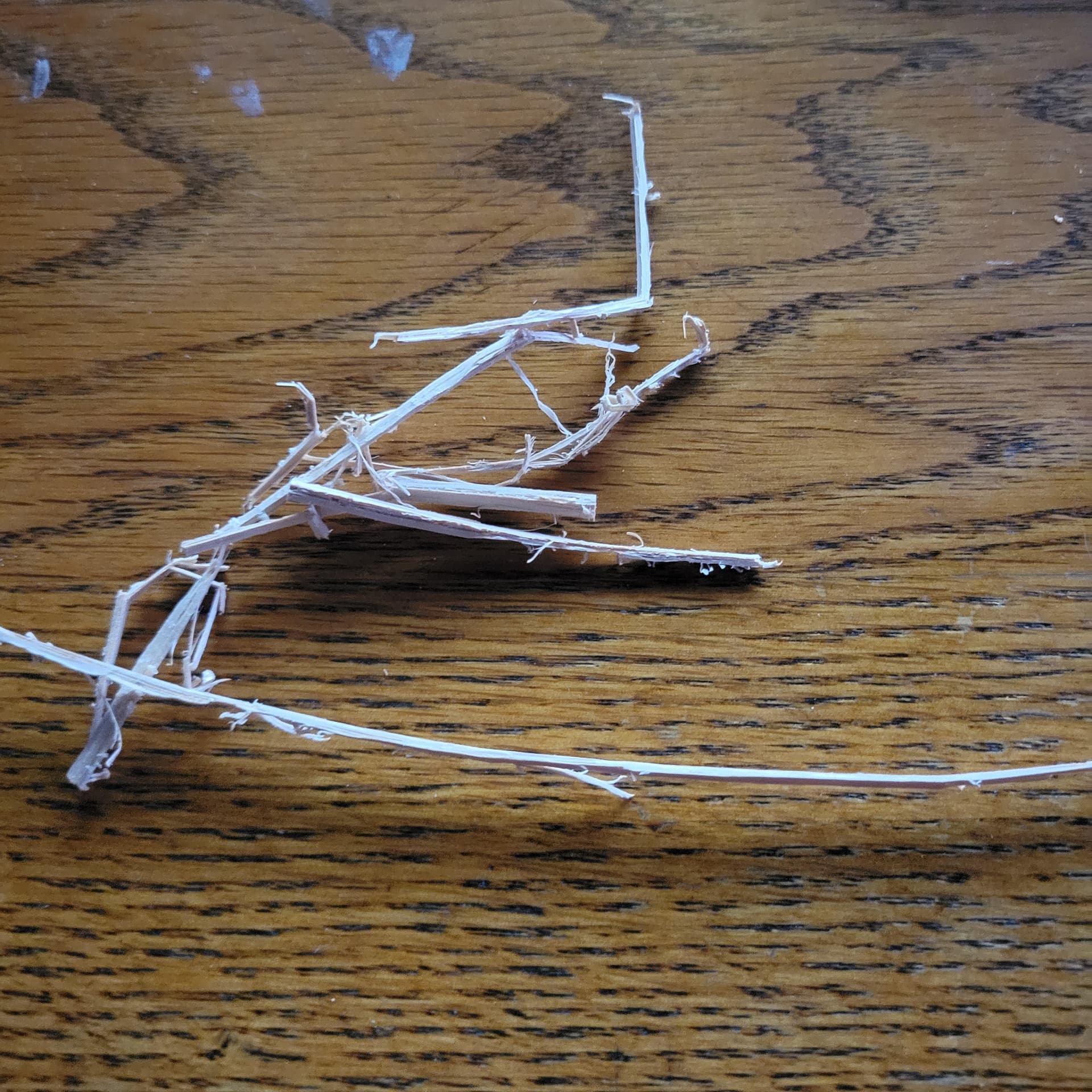

So I am doing a 3D carve on white oak. I am using a 1/4" upcut bit for the roughing pass.
When the machine passes along the grain instead of chipping, it pulls off strands of the grain—pictured below.
These strands eventually clog the dust shoe and I pause the machine, stop the spindle, and clean it out.
Any ideas of cause and remedy?

The cause is, it’s just really stringy wood. Lighter cuts can help. Do all of your roughing at an angle, or across the grain (Not preferred as end grain burns easily.)
Rough to within the thickness of the strings or more, then use a downcut to finish walls.
Soak the wood with a good penetrating sealer. Lacquer sealer thinned out just a bit will soak in well.
Look up impregnating if you want to get real serious. It uses resin & heat & vacuum to pull the resin further into the wood. If you can’t do the vacuum, heat up the wood & thin the resin.
I have been running a drilling pass with a row of holes 1/4" to 1/2" spacing between rows. I got some 1/4" carbide drill bits. Along the row the holes are almost touching.
I’m basically chopping up the fibers along the grain.

I’ve ran into this a bit. Oak is a relativly cheap hardwood, so it’s attractive to use. I’m in the camp that just roughs cross-grain, then finishes with the grain when possible.
And I also agree the Deep Sweepy helps. But it only helps so much
A fresh bit reduced the strings on red oak. I used conventional rotation as well.
