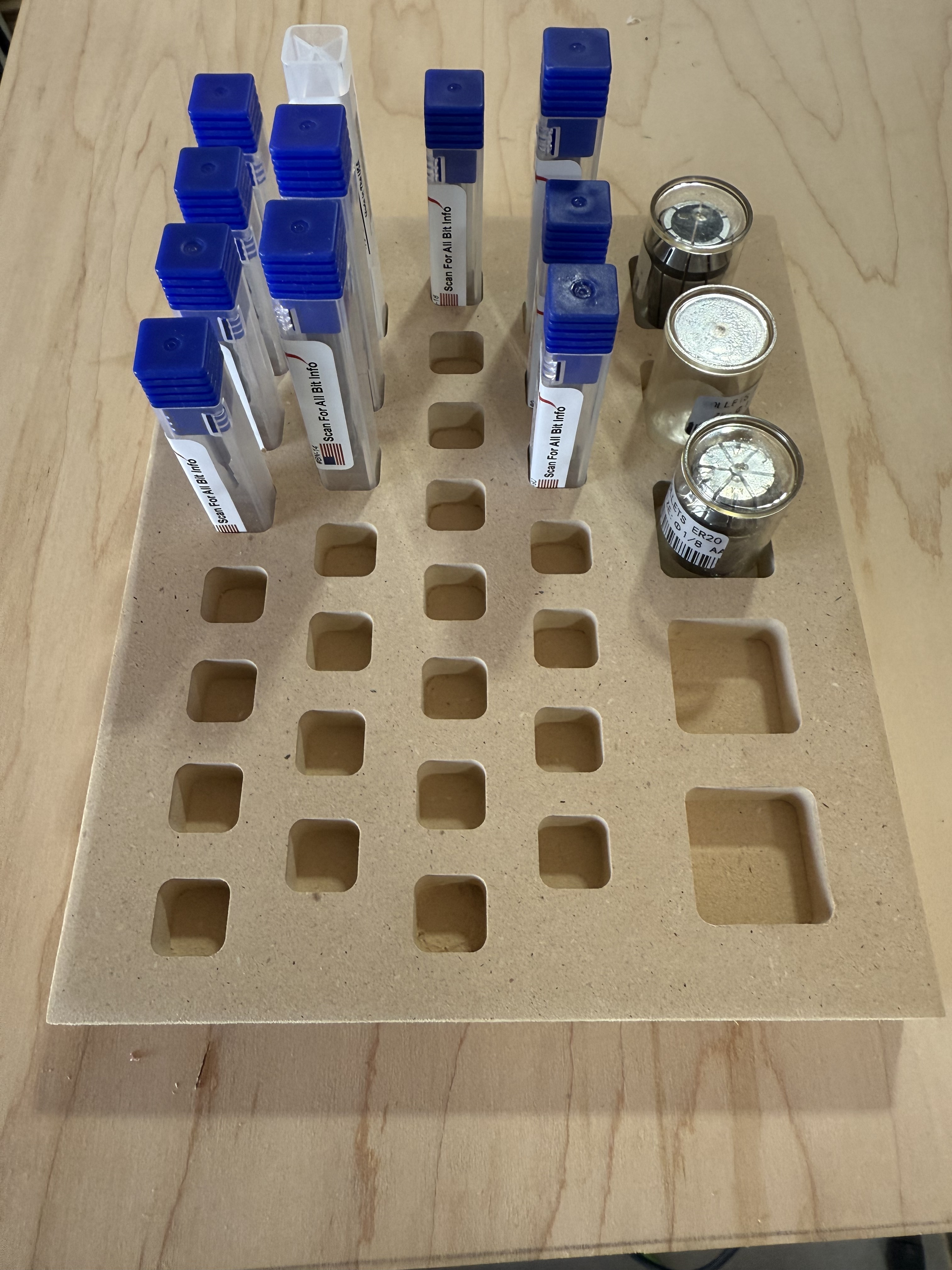

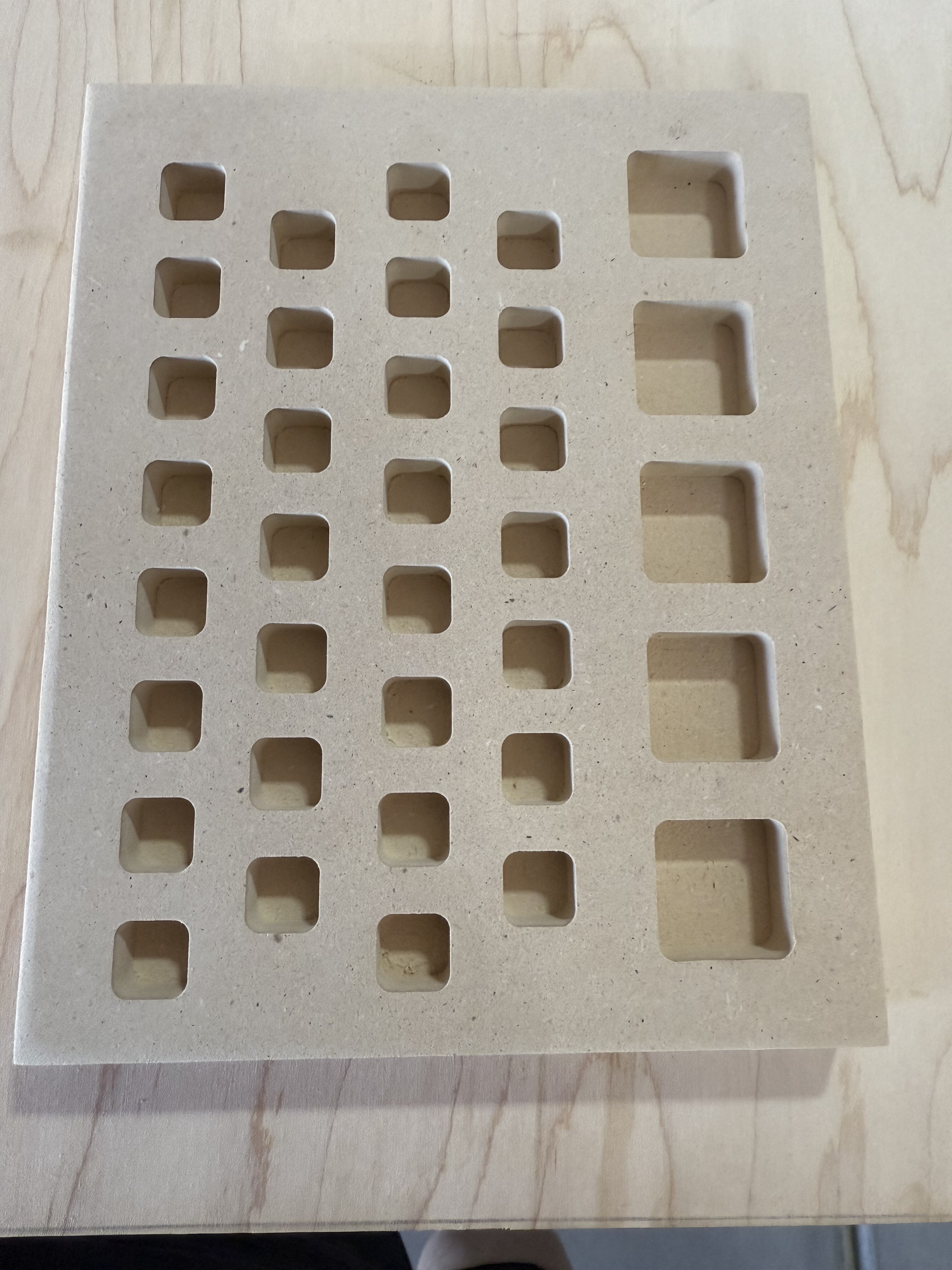

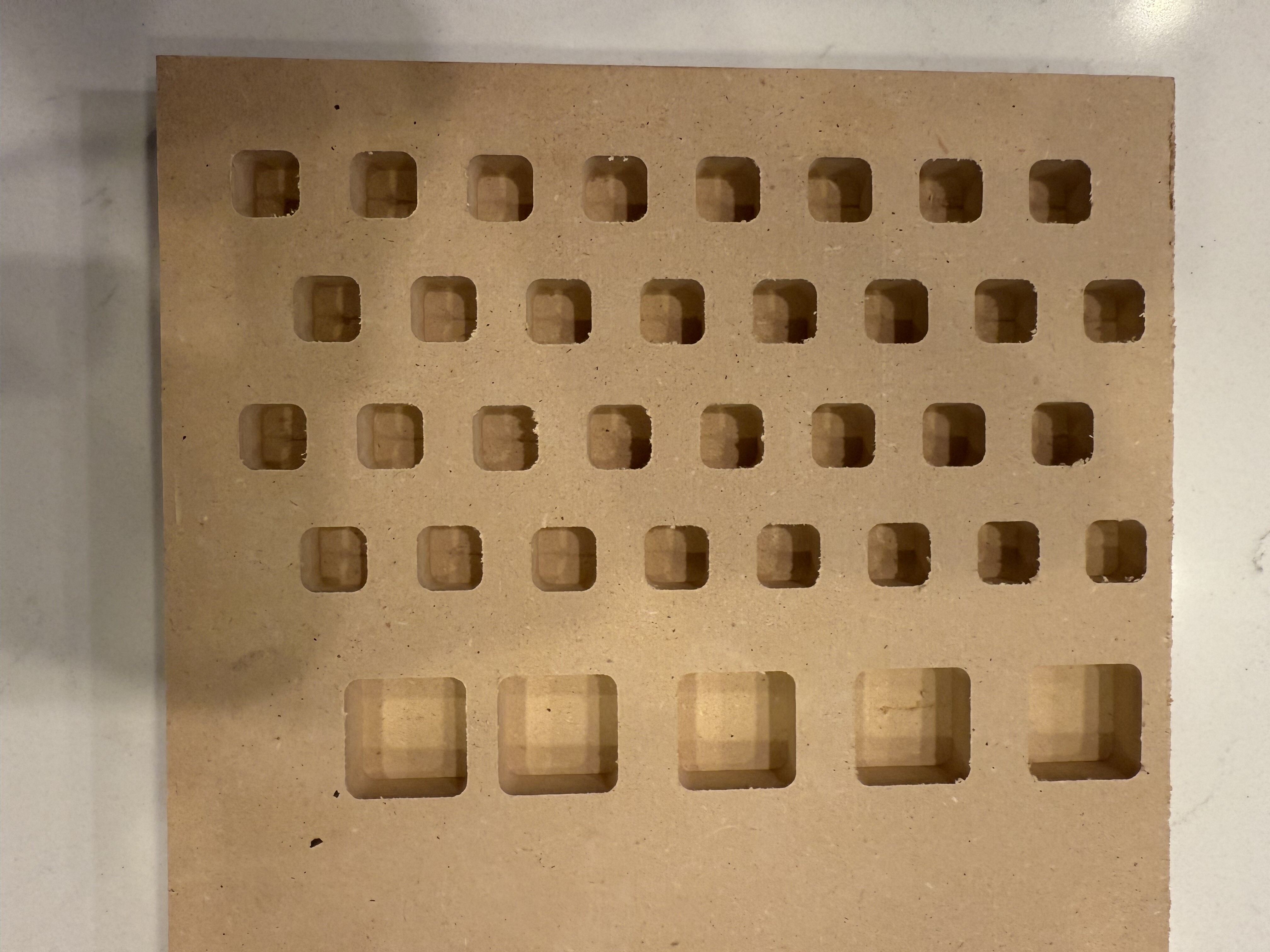

Completed my first project on 5Pro. It is just a simple bit and collet holder. I wanted the holes for the bits to be 13mm x 13mm but they came out at 11.88 x 11.88 mm. The holes for the collets also were too small. Expected = 24mm x 24mm and results was 23mm x 23mm. Please let me know what I did wrong. File attached. Thanks in advance.

Material = mdf
Photo attached
measuring with digital calipers
yes, used #201
I made some slight adjustments (including your recommendation) and got what I was trying to get. However I don’t understand what made that change work. I initially used the stock settings.
