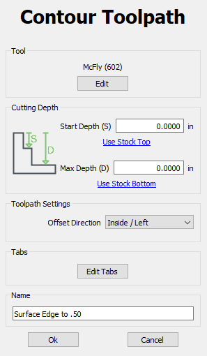

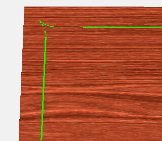

I have experienced a situation that sounds similar. But I assumed I stumbled onto a bug so obscure it wasn’t even worth reporting. Do you think you did the same thing I did…
I had a toolpath that had a start depth of 0.0000, and an intended max depth of 0.0001. But I had entered one too many zeros (0.00001). That cut may look stupid but this was my method of surfacing material that was slightly thicker than 0.50" to a precise 0.50" using Z set to the bottom of the material.
When looking at the toolpaths, Carbide Create draws that cut so there was no visual indication that I had done anything wrong.
But when Carbide Motion ran the job it slowed to a crawl while positioning for that first toolpath, when it finally got to that starting point it then skipped that toolpath and moved onto the next one and resumed normal speed.
