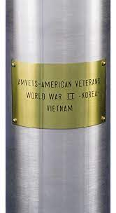

My first thought was something like this
But I think any trophy/plaque nameplate/engraving plate would work
