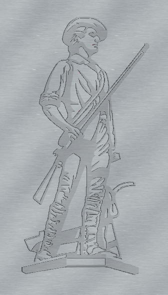

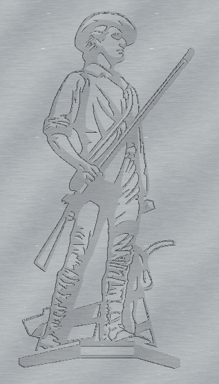

Hello- I was hoping someone could give me a suggestion on what tool path would work best with this logo. I have messed with several bits and after looking at the simulation they look OK, not great. I have used a 1/32 bit as well as a 30deg. engraving bit. Just looking for another option. Thank you as always

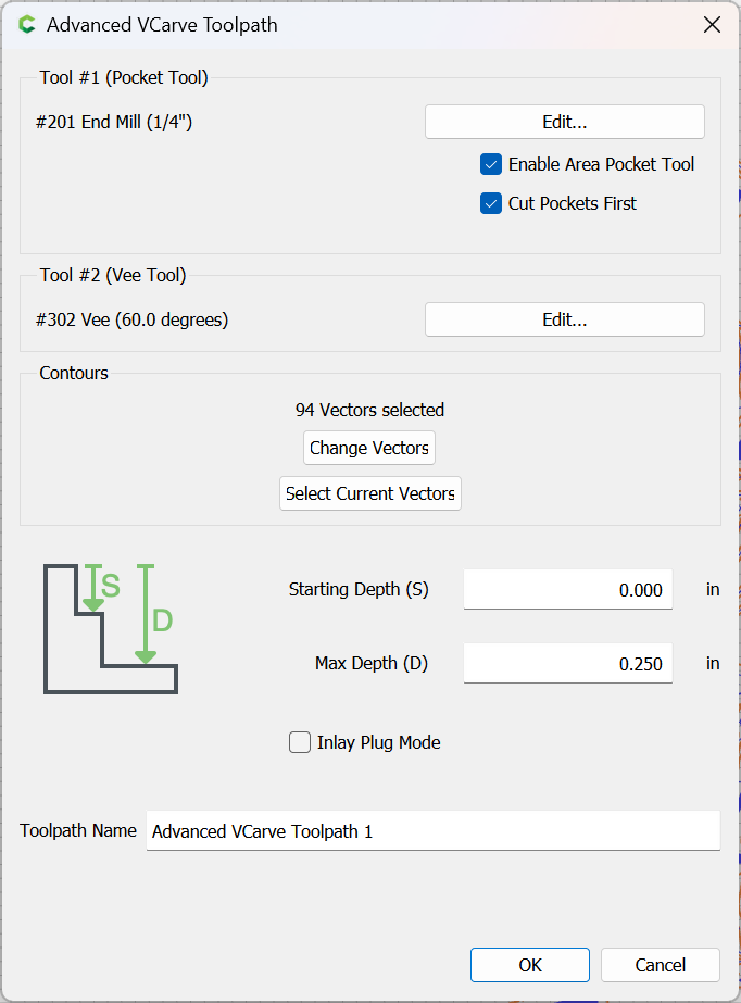

An Advanced V carving should work well:
Excellent. I will try it. Thank you.

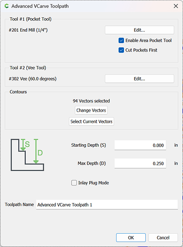

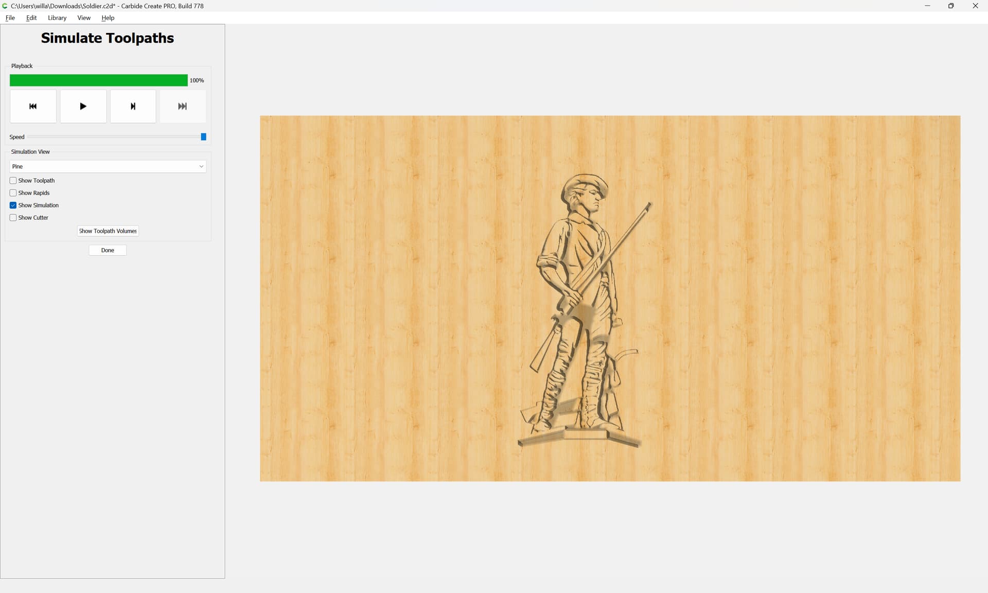

I downloaded your file and did an avanced vcarve with several different tools. I dont have a 30 degree vee bit but do have a 20 degree. I set the depth to .1"
Here is the #122 1/32" and a 20 degree vee bit and it would take 553 minutes.
Here is the #112 1/16" and a 20 degree vee bit and it would take 261 minutes.
Both of those are quite long. I did not try to go up to a 1/8" bit.
What I would suggest is you go in and edit a bunch of the pant wrinkles out. On a 12" figure removing some of the detail would help with the time and make your picture simpler.
That minute man has been standing for 153 years so you would think the wrinkles in his pants would iron out.
What I would suggest is to find another image or go in and edit this one to make it simpler.
