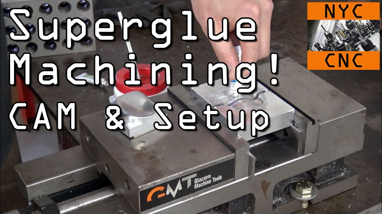

Superglue workholding, no tape?
Has anyone played with this? I’ve seen it on a lot of lathe videos. Heat is used to release the part.
Could have an alu base clamped down, then the workpiece glued directly on top. Once finished, remove both, torch to heat and release.
I guess the cleanup might be an issue but I’d imagine there is some solvent that will dissolve CA? Acetone?
Greg:
For CNC use I use blue painters tape and CA glue.
No solvent needed just peel the tape off.
Not sure what you are referring to that uses a torch. Not a good idea.
Bill
It does seem viable, as the strength of the glue starts to weaken at higher temps. I usually use glue/tape since I’m working with wood, and would like to have an easier clean up. Though good to be aware of incase I encounter a part in aluminium, sort of like this:
Use a torch to separate the parts (though be careful as the vapor from dissolving super glue is toxic) once machining is done.
Yeah I see how tape is needed for wood absolutely, and for metals it might simplify things, but if you’re removing it anyways you can easily heat it, it breaks around 100c (200f) so that’s not even that hot as far as metals go.
