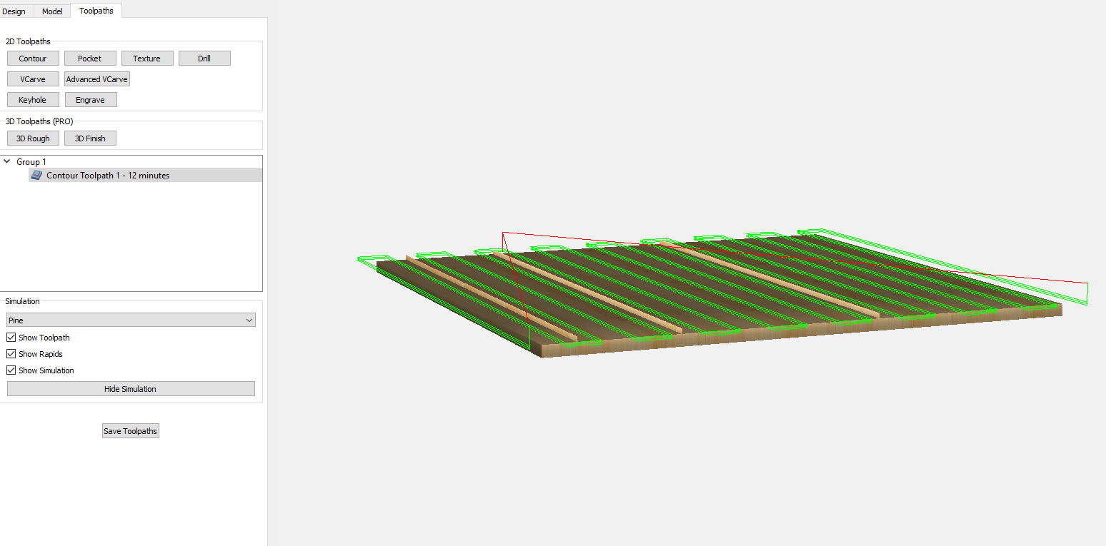

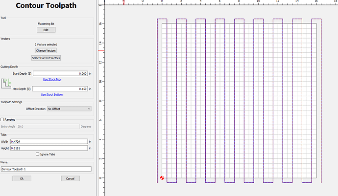

Hi. I used a shared Carbide Create file from the forum and adjusted it to hopefully surface misc pieces of oak and wood that I need leveled out. I plan on using a 1" diameter flattening bit on my Shapeoko 4 XXL. I haven’t ran the program yet because the simulation is showing 3 small ridges popping up. I just can’t figure out why?!? I know I can sand it down once I run the file but it is driving me crazy.

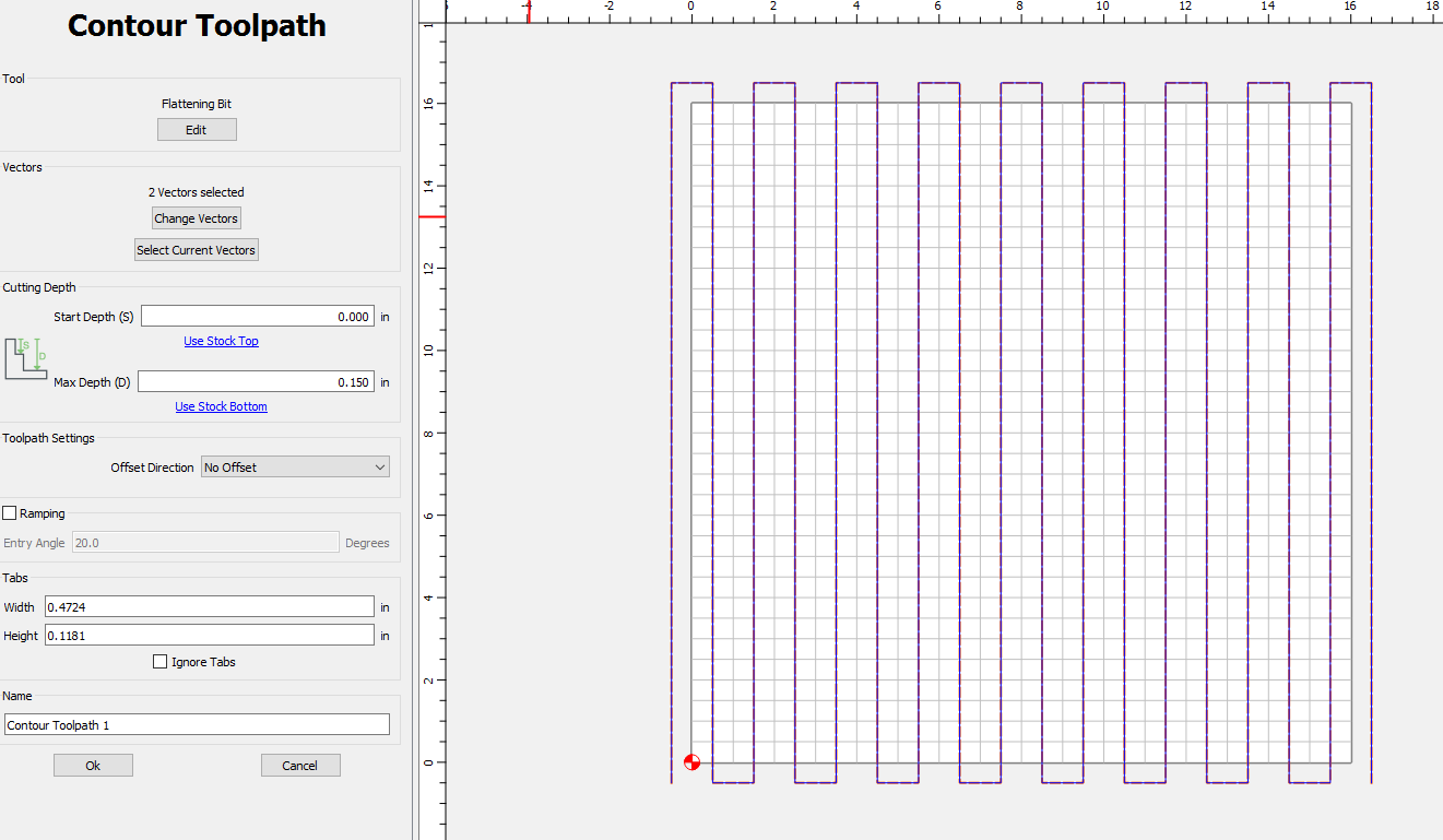

Scale it slightly horizontally, and draw in another line on the right.
OMG! I knew it should have been simple… I tried making it bigger and moving them around. Thanks so much! It worked! You are awesome!
