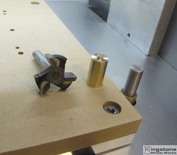

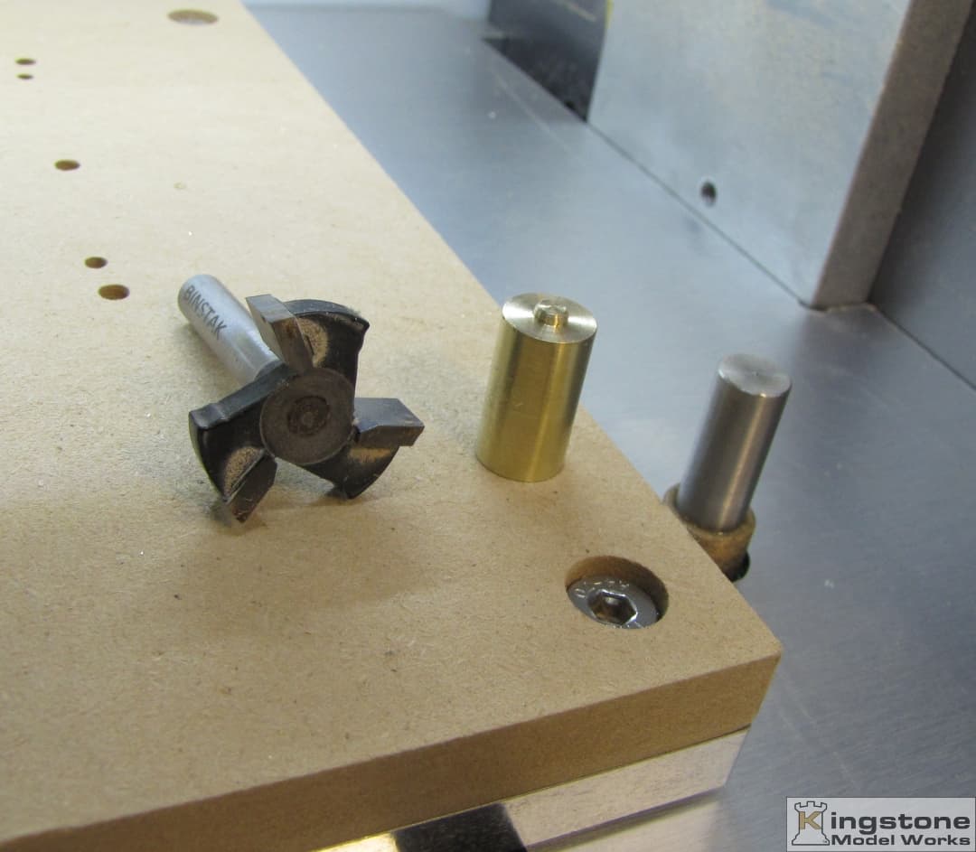

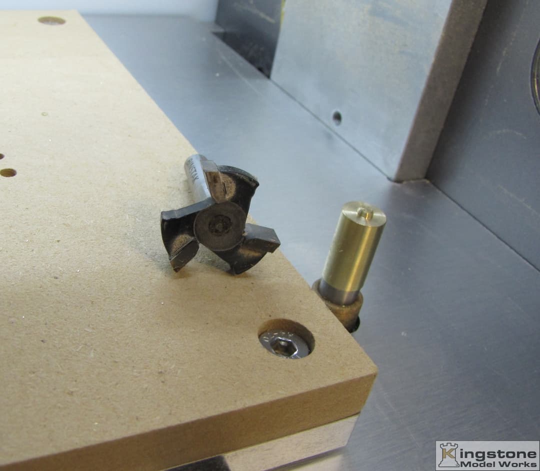

I spent Friday and all day Saturday on the Nomad 3. I spent several hours on Friday afternoon drawing up a surfacing CAD drawing, converted to DXF and imported into Carbide Create V8. I made a little part that fits over the bit setter so I could set the 3 bladed surfacing bit. After stalling the machine out twice on Friday toward evening I gave up and slept on it a solution. By Saturday afternoon I had it working. Had a very close call of almost surfacing the bit setter. didn’t realize I need to be careful with a larger round surfacing tool of how close it got to the bit setter. Probably had about 1/4" to 1/2’ clearance, The was a heart stopper.
Here are a couple of pictures of the part I made to fit over the bit setter. It’s a piece of copper tubing and a piece of brass rod with a nub turned on the end to fit in the center of the surfacing bit. The length of the piece compensates for the depth from the center of the surfacing bit to the bottom of the teeth. Worked pretty good. I was within .020". Couldn’t figure out why it didn’t cut the first time. I set it .020" lower and it skimmed the surface of the waste board giving a nice level board. So I’ll need to trim .020" off the end of that nub and I’ll be all set for the next surfacing.
Here are the two pictures of the part I made.

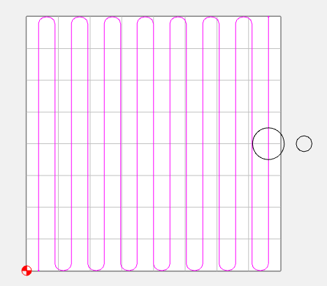

How far from the table is the side of the bitsetter? And how far past the edge of the table will the tool go in X & Y?
I think I might go with something like this. You don’t have to cut out to the edge. You can start in a bit (I went 3/8 so the tool overlaps just a bit) to make sure you’re avoiding the bitsetter.
18000 sounds a bit fast for a 1" cutter. If it burns, slow it down a bit.
@Tod1d,
Lets see if I can explain this. In the CAD program I drew a box 8" X 8". Then I used the first line at 0,8 and offset a lines to the right .8125. Ten of those offsets took me .0125" over the right side of the waste board near the bit setter. I then connected those lines with radius’ at each end. Imported it to Carbide Create V8 and came up with serpentine path. As I sated in my last post that it missed the bit setter by .250" to 1/2".
Had no burning at the RPM.
If you are leery of how close to the bit setter you are going to get. Just take a look at the G-code file when the cutter reaches that area and manually job over to that position. If to close then adjust your settings. I think that would work to determine if you’ll hit it or not.
Hope this helped.
Bernd
Ah, OK. So you have a good 3/4" between the table & bitsetter. Looked closer in the pic.
