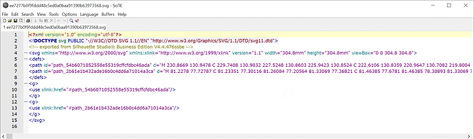

You need to either export from Silhoette in such a way that objects are not stored internally and used by reference:
such are referred to as “Clones” in most drawing programs:

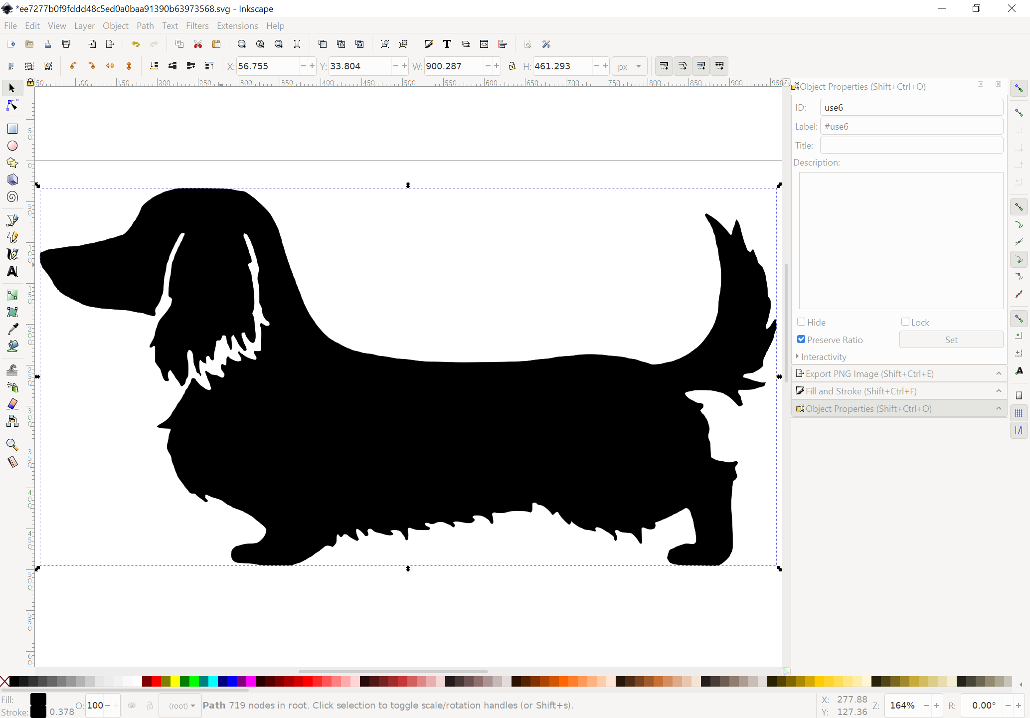

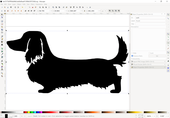

Or open it in a 3rd party SVG editor, ungroup until you arrive at the Clone objects, and then use a command to convert the object(s) into paths — Path | Object to Path in Inkscape:

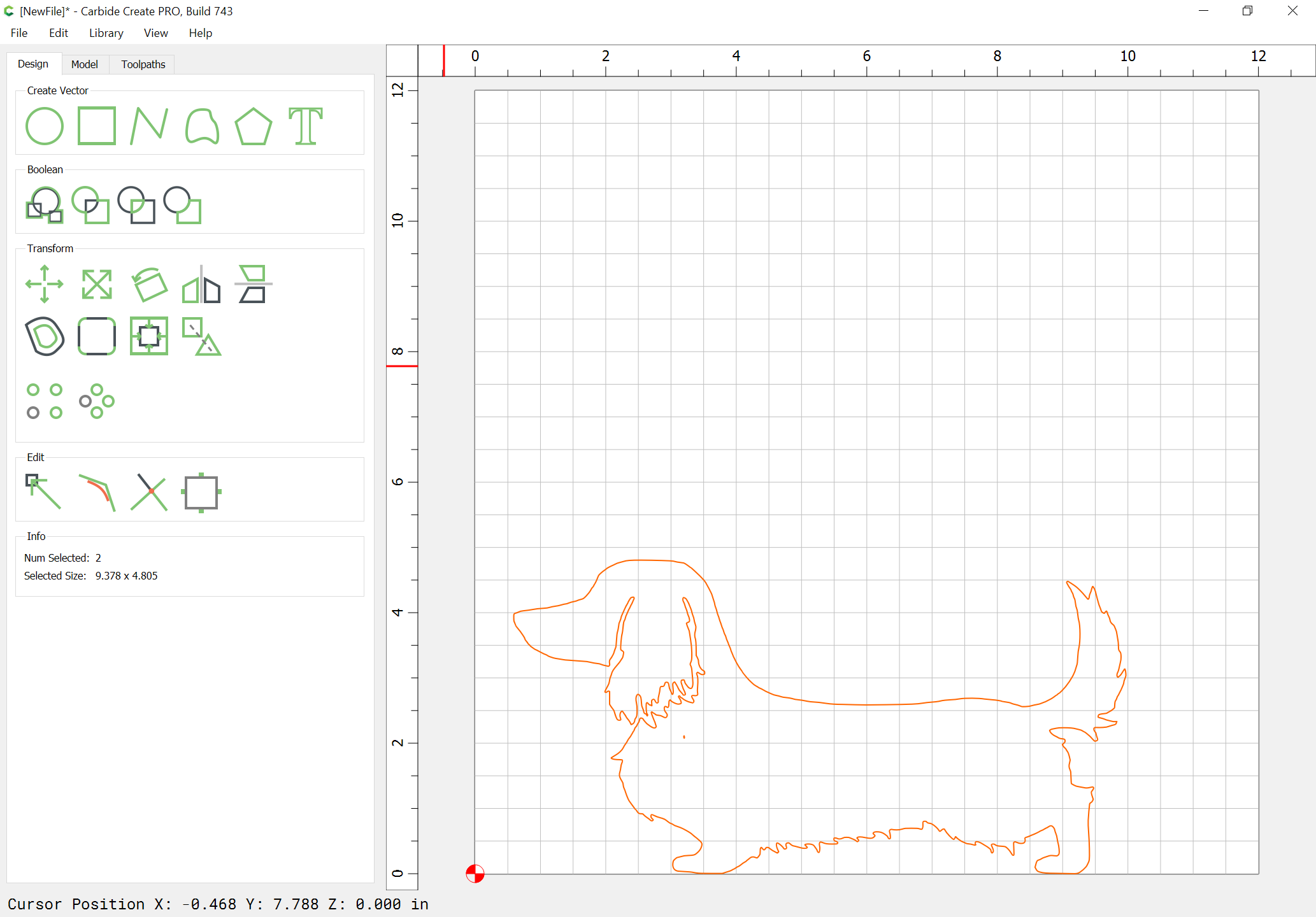

You can then save the .svg and open it in Carbide Create:
Attached as a v7 .c2d file:
dog_v7.c2d (124 KB)
