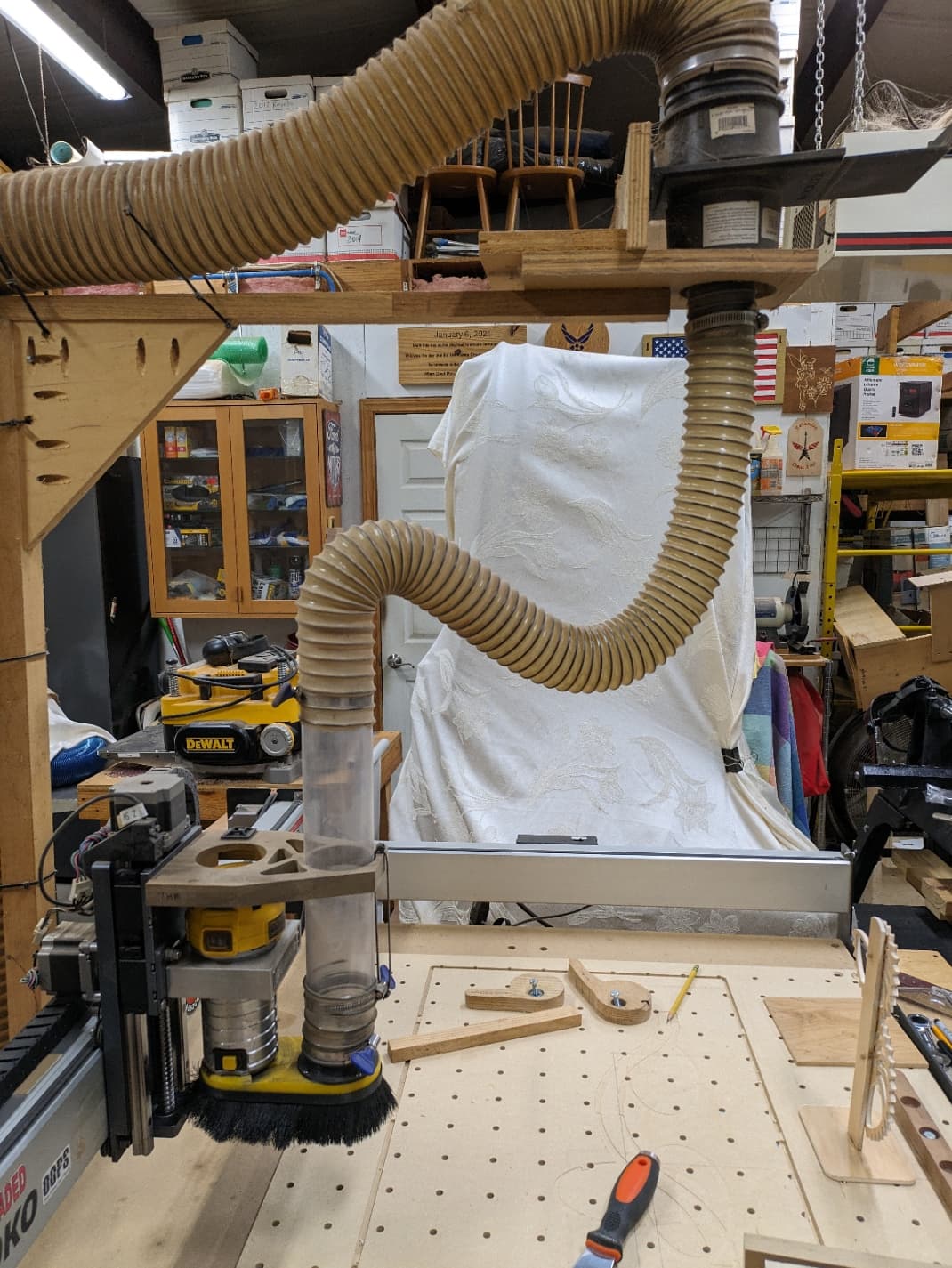

Have a Harbor Freight 2HP that will be dedicated to just my new Pro5 when it arrives that I have piped to above the machine. I have heard that there is not enough room to hook a 4” hose directly to the included Sweepy with an adapter.
Two part question-
Has anyone found a suitable dust boot that can directly support a 4” hose that will work with the Shapeoko spindle?
Also, I saw the below in an earlier post, but did not see if anyone had success with it.
Any feedback is greatly appreciated. I lose SO much flow when I reduce down to 2.5” so would like a better solution.
I have an SO3 with HDZ. I call my setup the diving board. I have a Jet DC1300 with a 4" hose. I leave the 4" hose permanently on my Shapeoko and attach another 4" hose that is connected to the DC. This way I can move that hose around to other tools.
I made the bracket to attach to my HDZ to hold a 2.5" tube and a 2.5" flexible hose to connect to the 2.5" to 4" connector up top.
Here is a picture of my setup.
I do not have the sweepy but that setup would work fine. I will attach t he bracket I made to work on my HDZ 3.2 version. You can measure your SO5 and HDZ to see if anything has changed. You can modify my design to fit your SO5.

Here is a screen shot of the cc design. The original idea came from a Z-Plus from Jon Eckels
