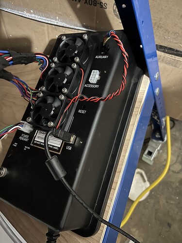

If you have a SO5 and you want to leave your machine on for extended periods of time I strongly recommend that you put a fan unit over the heat sink on the controller. That heat sink gets way too hot and the stepper drivers it is cooling will start to over heat and cause undesired motor behavior. The fan you hear spinning in the control box is for the DC power supply and does not do any good cooling the rest of the electronics. If I leave my machine idle for too long my motors will start clicking and moving without being commanded to due to the drivers overheating.
I use three 24V 50x50x20mm fans mounted onto a 3D print that is then VHB taped onto the controller to cool the heat sink. The fans draw power from the AUX port so they turn on when the controller does. With the additional cooling, my drivers no longer overheat and cause bad motor behavior.

Another option that might work if someone wants an off the shelf cooler is the M.2 SSD heatsinks that are becoming popular. I’d be interested in knowing more about the power output of the AUX port. Nice work!
They have a 2.6A fuse on it.
More than enough. Is it 12V or something else?
It is 24V which is why I used 24V fans.
