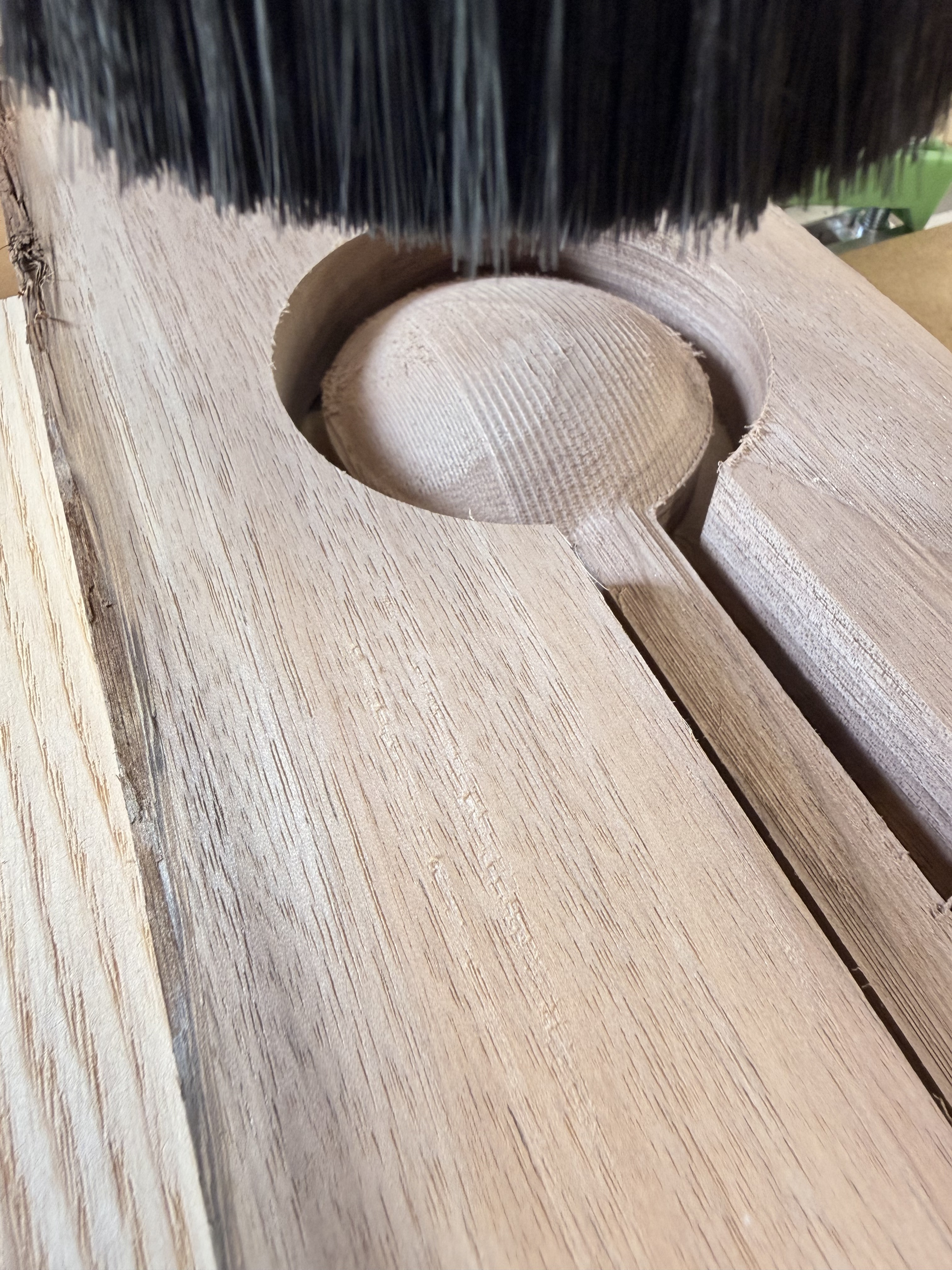

Ten percent step over vs fifty percent
The left side of the spoon bottom was run with a 10% step over and the right side was run with 50 % step over. Clearly a huge difference. These were also run with just end mills. I’m sure ball nose bits will make an additional difference.
