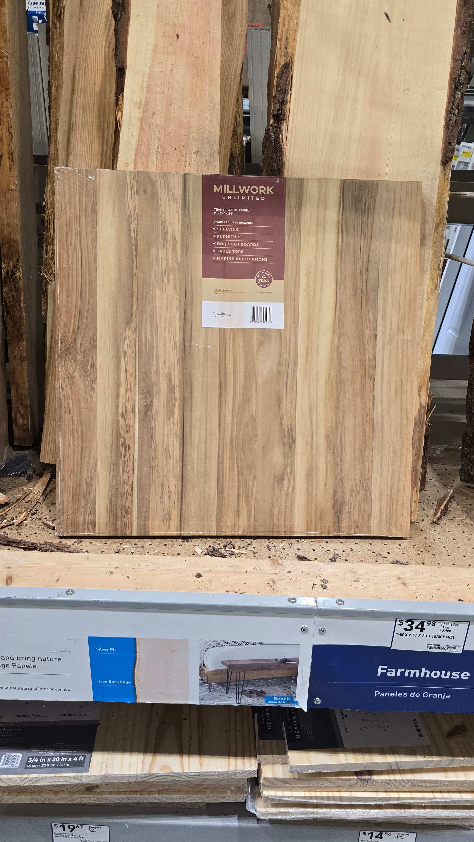

So I have something that I want to make, and I have a 24x24x.75 teak project panel. I know teak is very hard, and is high in oils and silica. Are there any special precautions I should take? I have been running bits at the recommended speeds and feeds assigned to them in CC, which from what I gather is pretty conservative to start with. Should I dial them back even further to work with teak?

Depends on where you got the Teak? I have purchased some panel from Lowe’s about the sam size you mention and although it is Teak allot of it had sapwood when laminated together and was not that hard to mill. Always start with the default speeds and feeds until you get some time with the machine cutting a new material you’re not familiar with. You will want to use down cut bits for simple carves as you showed on you practice run. Watch you step over on softer material as it can leave fuzzy’s if it’s too large.

I got mine at lowes as well.

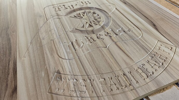

Too late. :rofl: I am already halfway through a big sign/plaque.

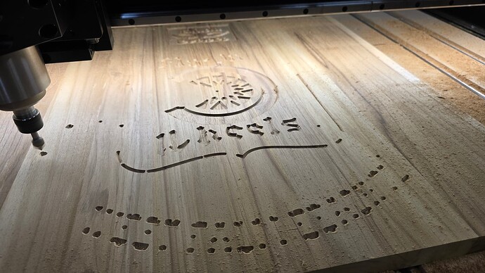

Im using the hardwood speeds on this teak, and the machine isn’t even breaking a sweat. No squealing or chatter. No burns. Could probably push it a little harder but I am content to be conservative.

Will, thank you so much for all of the resources you’ve provided. You have been awesome. Thank you again. Also, I would like to say that V bits are amazing.
However, I have some flaws in my design that I can probably figure out how to eliminate naxt time. This is taking waaay longer than it should. It looks like it thinks there are a zillion little details but really it could probably do this in half the time. I think I need to make sure my designs are super duper clean before running them.

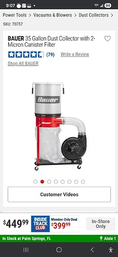

Any idea what the CFM should be for a dedicated dust collection system? Ive looked at a few harbor freight ones, including the big Bauer one, as seen here:

Yes, stick with the vacuum you currently have. The dust collectors you show operate best on a high air flow to remove dust vs a suction pressure value. It’s hard to get the needed ais flow thru the small attachments on the router/spindle. Im not saying it will not remove dust, but my vacuum with the 5 gallon cyclone seperator worked better than my dust collector did (what you have shown).
