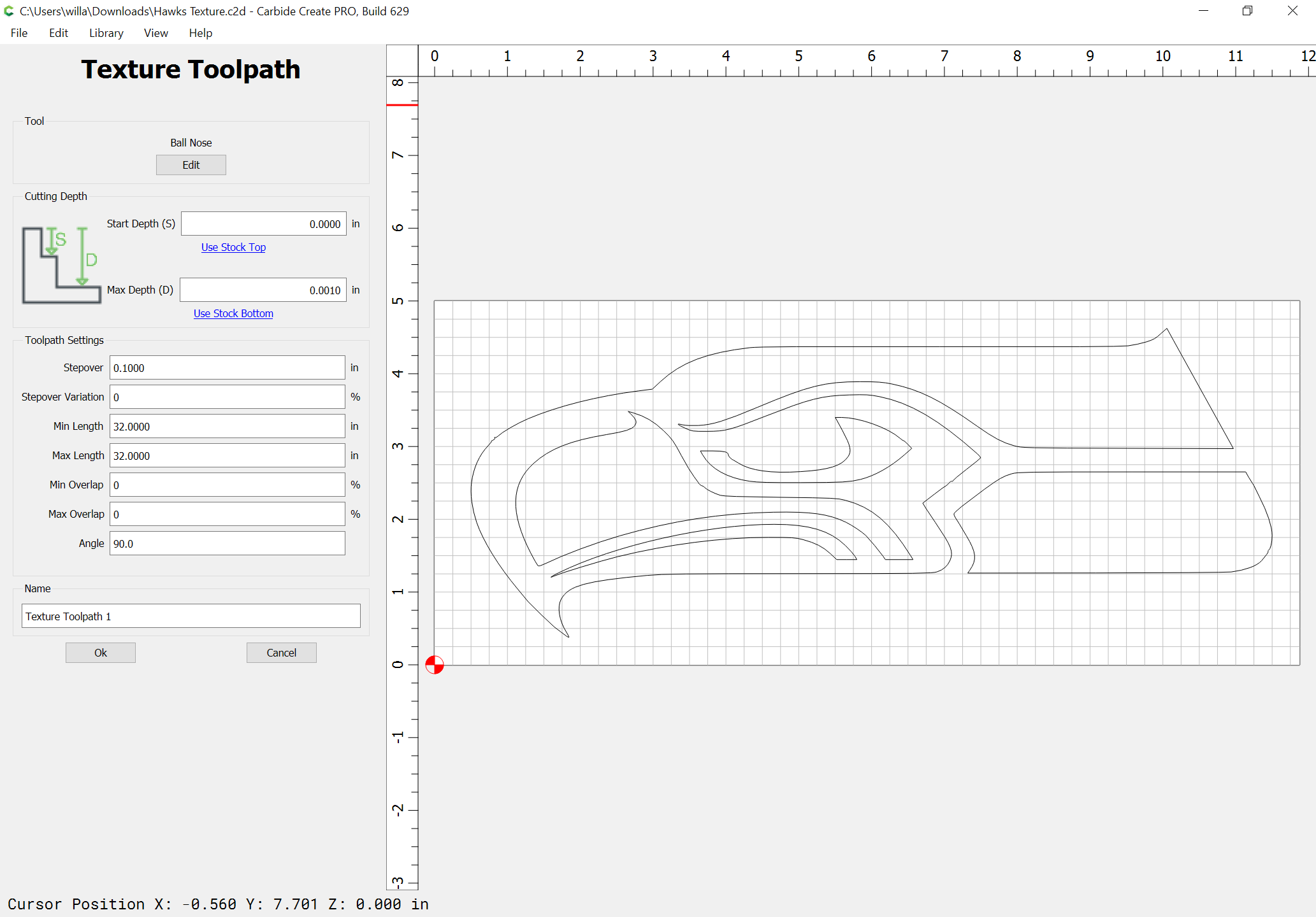

I have been trying to accomplish Texture in CC 628. All I am getting is straight lines. No I don’t have pro.
Is there a bug in this build?
I have tried many variations of Step Over, Length, Overlap and Bits. Currently trying an .125 ball nose
Trying to Texture cut Polycarbonate
Here is the current file.
Hawks Texture.c2d (71.0 KB)

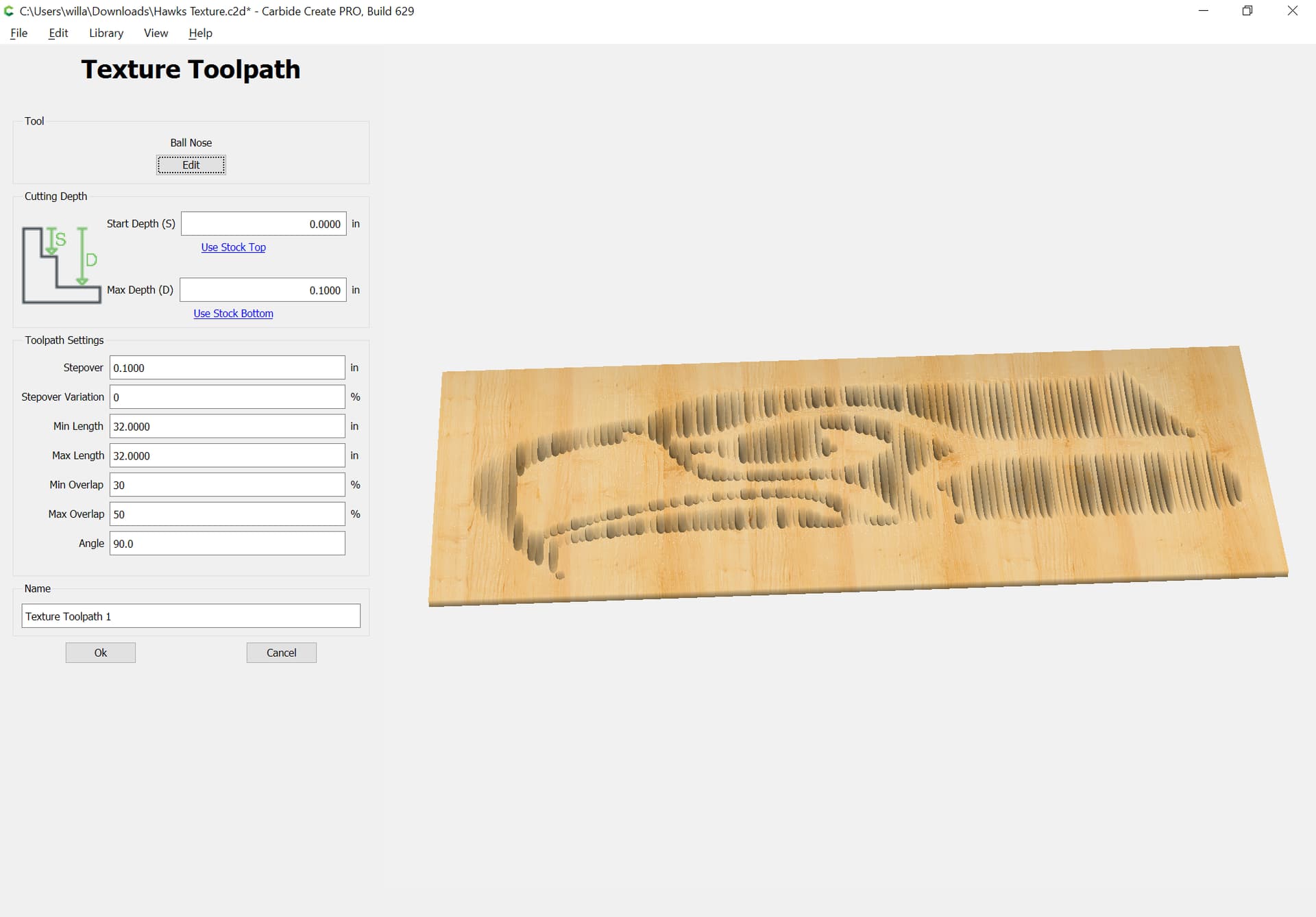

Looking at your file, you don’t have any geometry associated w/ the Toolpath in question:
If you select the geometry:
and max depth and increase min and max overlap so as to actually allow a cut:
it then becomes possible to experiment w/ the settings to achieve a desired result.
