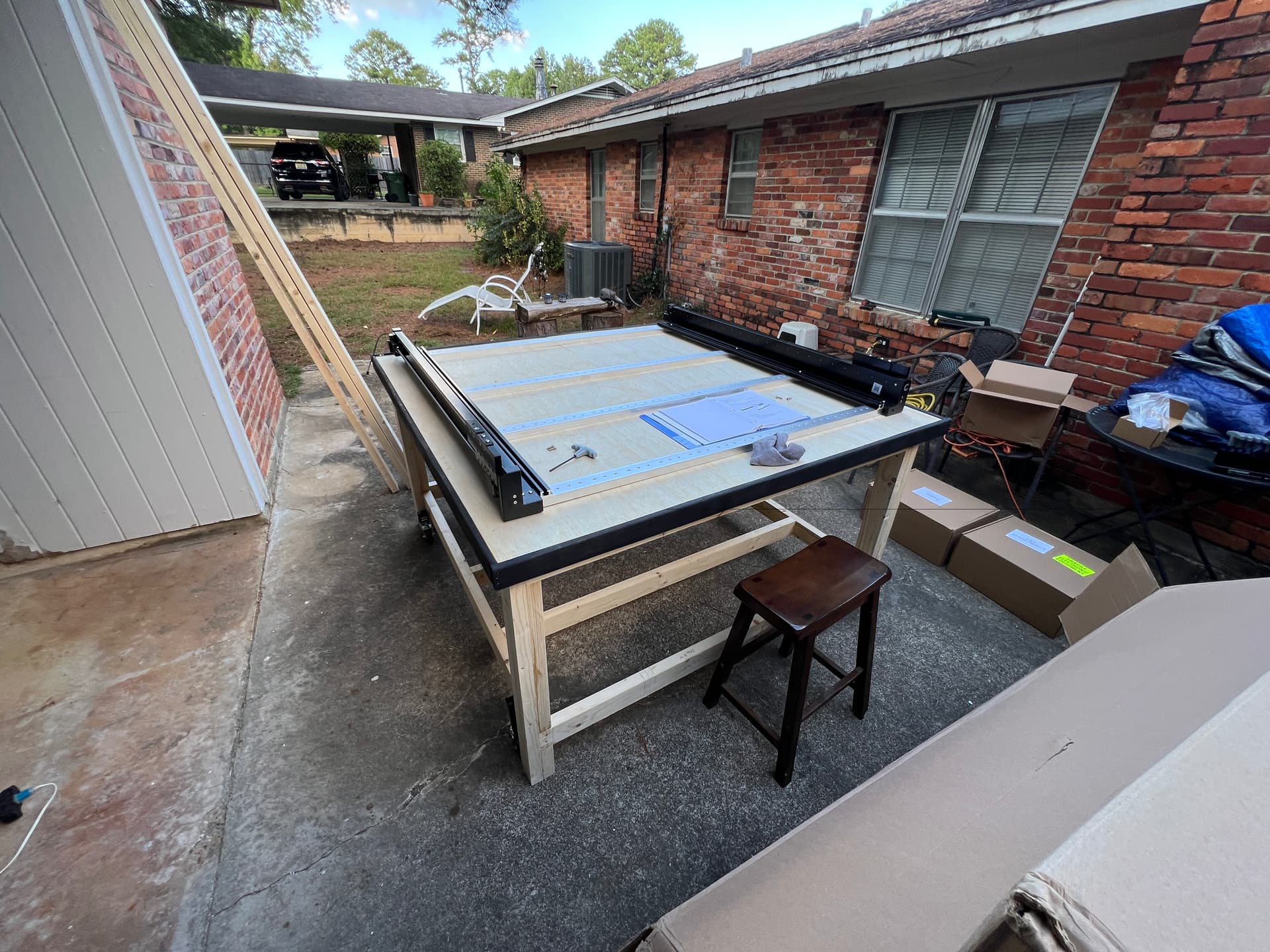

I’m almost done with my CNC table–one to rule them all in sturdiness and eventual function.
Today, it’s to the point where I’m going to begin assembling the 5 Pro 4’x4’!!!
Table Features
In the meantime, I need to add some drawers, and cabinet enclosures on both sides and trim around the tabletop that’s about 1/4" proud of the deck so bits and anything else I might otherwise knock over the edge, will not.
Yes, that’s a torsion box assembly for the top deck! This thing doesn’t shake at all.
In fact, I tell others that an Aircraft Carrier itself could land on the table and it wouldn’t budge!

I know lots of software, but I do not yet know SketchUp. So, I do not have the plans for the table, YET!
If you’re interested in them, I’d be happy to exchange the sketches with someone who knows SU in exchange for the SU plans to list for sale and a perpetuity arrangement for 20 percent of all sales of said plans.
So here are a few pictures to whet whistles!

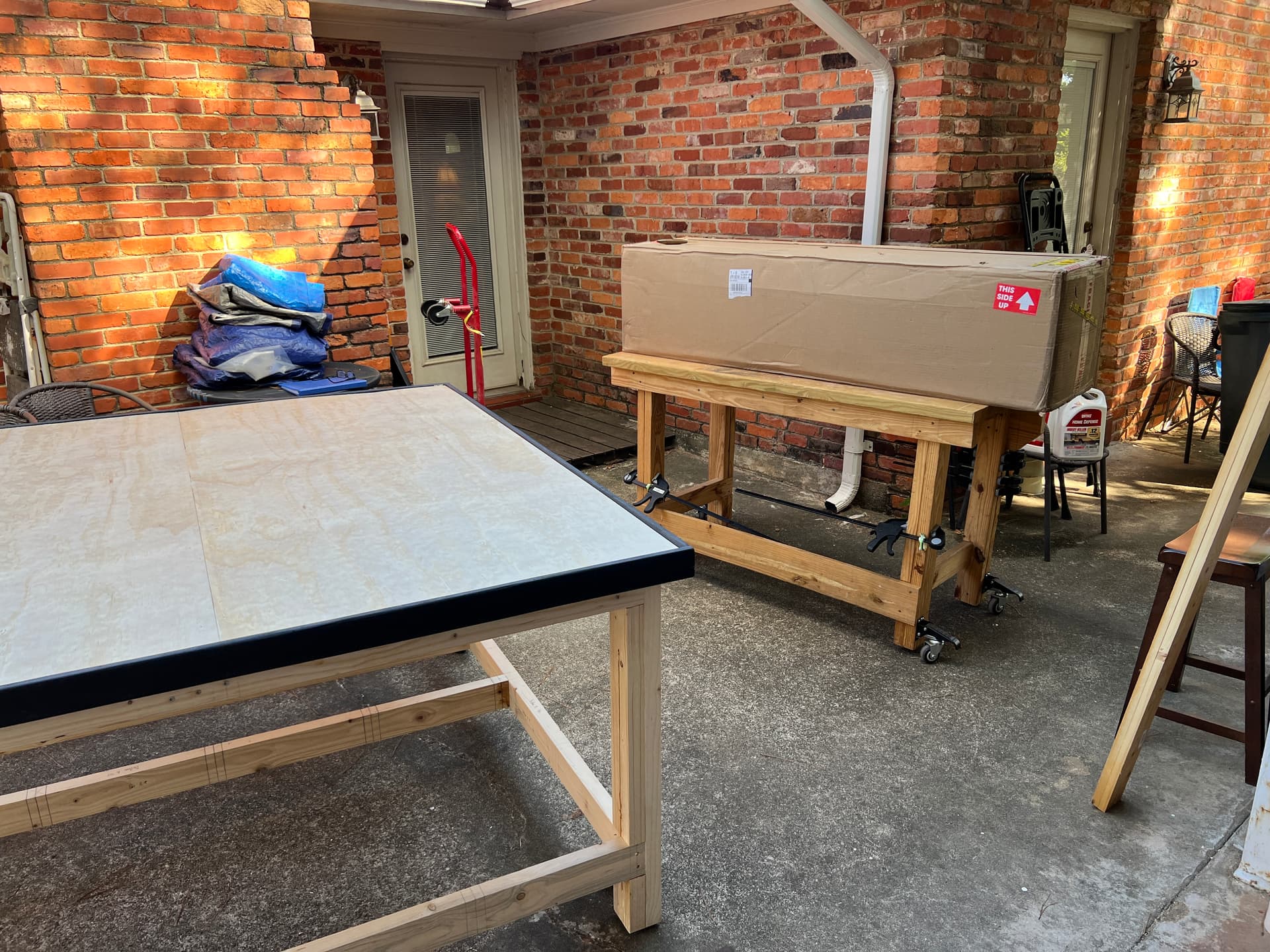

Not that your table doesn’t look and act sturdy and flat, I don’t see a “torsion box” top on your table.
Well, bless my heart, I must’ve misspoken.
You’re right—it’s a solid frame design, not a traditional torsion box.
Sometimes we get caught up in the excitement of building things that last longer than the patience required to explain every detail.
Weight wasn’t my concern here—maximum durability was the goal, and this configuration has that covered.
Tex, since we’re both Texans, I’m sure we can agree that getting the job done right matters more than semantics.
Y’all take care now.

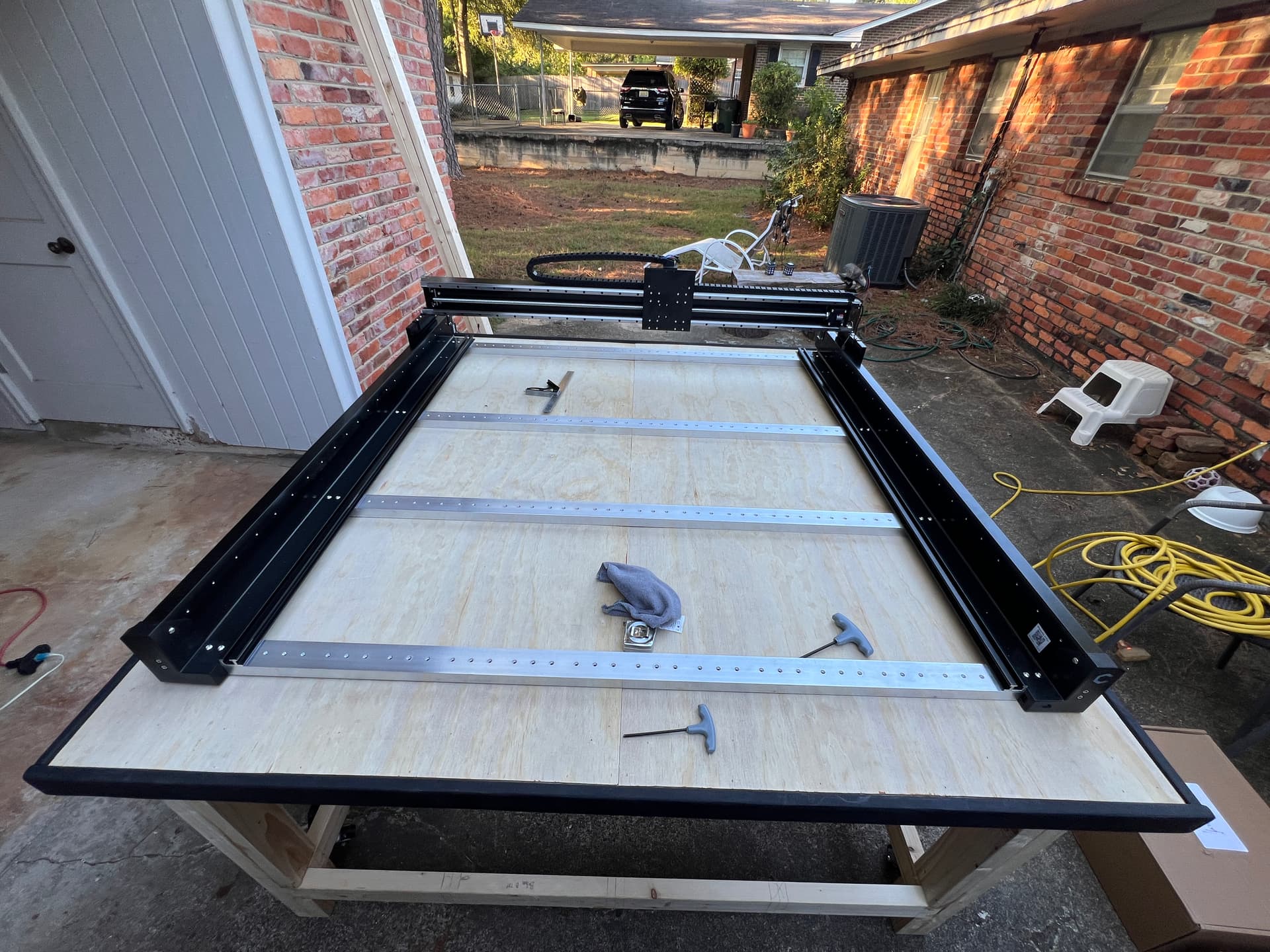

You might want to consider some diagonal pieces ( 1" wide metal strips) to connect the top to the legs. I found that reduced the wobble while running.
Thanks, James. Those ones that have a top in one direction and the bottom 90° turned?
Yeah I’d say either 45 degree struts on the undersides of the top and support rail or get some nails instead of screws in there because the torsion the machine will put on them is quite high.
Well thank you for the input!
Looks like I have some more work to do before assembling the machine.
I’m so thankful for the support and advice.
It’s great to know that even what I have built needs some more strength to it.
I can definitely add the 45s. And looks like I need to get to a box store to get some of those structure ties.
I’ve worked with others in the past who didn’t want anyone looking over their shoulders cos they were too proud not to see issues they didn’t want to see.
The stronger I make this thing on the front end the better.
Thank y’all again for the words of experience and wisdom!
Donald J. / Donny

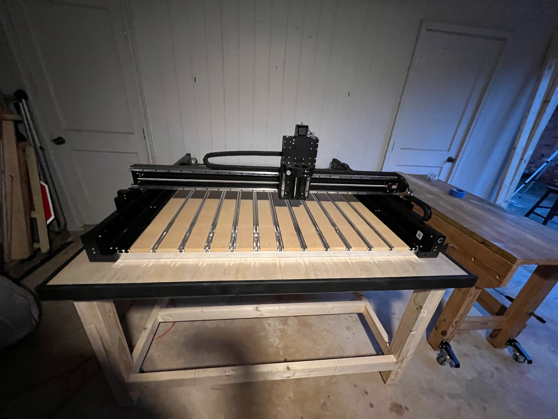

Here are pics from the progress I’d made as of yesterday evening.
Today I’m into the:
"96 screws on the table, 96 screws on the table!
"Tighten one, you’ve only begun
“95-screws on the table!” bit.

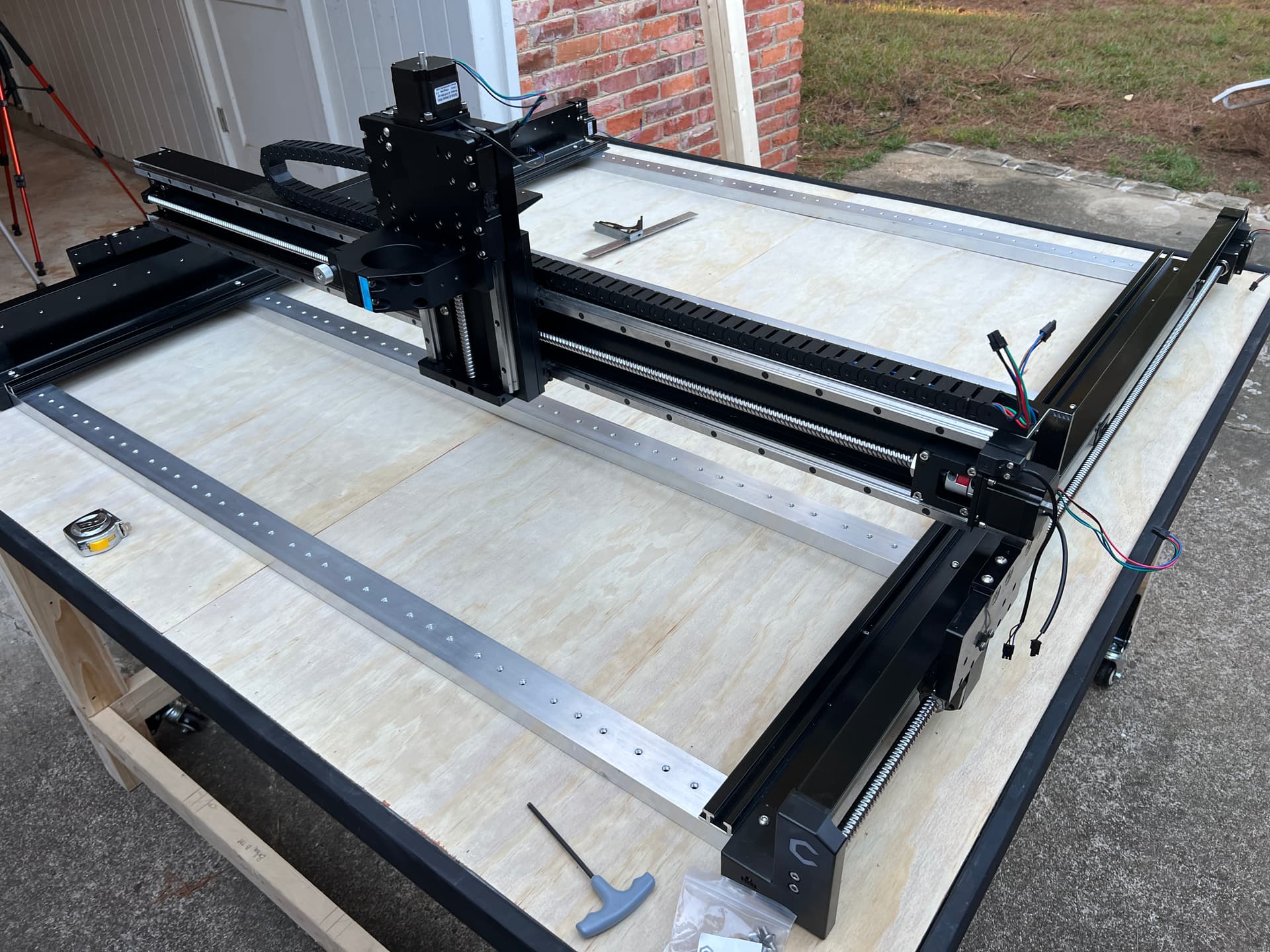

I’m kinda anxious, to be honest, about getting into the wire harnesses and all, but the manual makes it look pretty straightforward.
Thank you all for the comments and advice.
I’m going to get this part done and then add some drawers and shelving to the under-deck.

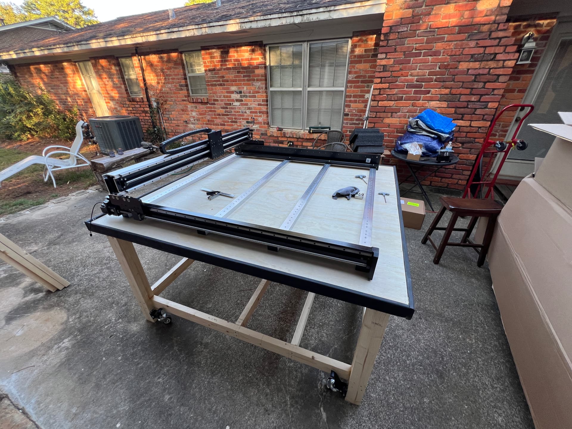

go back and shim those gaps under the hybrid table bars if you have time, might seem sturdy but if you intend to do some really good faster harder work with it you want every bit of rigidity you can get. just press against the bar and watch it flex 10-40 thou. Some people would say that’s rediculous but the z axis motor itself can put a hard enough point load on that people have observed frame flex.
Especially because I like to cut in the front left corner and I can see your front left looks very proud.
Yikes, this is the image I took tonight before calling it quits for the day.
I now see what you’re saying, more so to the center line, but definitely will check it out in the a.m.
From carving basswood figurines I know to trim the bottoms to make a shadow appear between the bottom of the carving and whatever it is standing on, but I sure missed that in the photos and I don’t want it there!
Great catch, sir, and thanks for an obvious observation that I totally missed.
