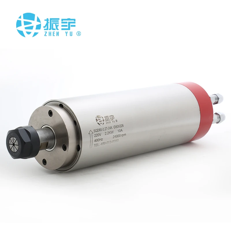

I did a bit of research and ended up importing it directly from the manufacturer. One has to be a tad careful - there are a lot of spindle manufacturers, but only a handful that really know what they are doing, or care much about the product.
Here is a link to their store on Aliexpress - it’s not exactly the same model that I bought:
The company that owns Aliexpress has the same thing but on a grander scale (called Taobao or Tmall) - and is entirely in Chinese. On Tmall, the Zhenyu company’s shop is much more extensive - here is the link to my exact unit:
To look at Tmall links - I use Chrome, and turn on auto-translate to help make sense of it all.
If interested, its easy to communicate with the sales department at Zhenyu in english - and I just arranged them to send me the unit directly from China, had it in a couple of days.
I have no connection to this company - just a happy customer.
Re the software question: I use Estlcam to generate my threading G-code (and a lot of other stuff). It’s cheapish at $59 USD. Can’t recommend it highly enough!!
Wow, cool, thanks for the spindle recommendation. I will keep that handy for when I want to buy one. You need to buy the spindle, frequency converter, and more, right? What was your whole bundle you bought? I wanted to know where you got your threadmills too.
Yes I bought everything I needed from Zhenyu - spindle motor, variable frequency drive, water pump, tubing, ER20 collets and nuts, dust collection head, and probably other things I’ve forgotten!
That shop has a bunch of thread mills - that link above is for those designed to cut Aluminium. They have others for steel. Mine is made from tungsten carbide - not sure what would happen to it if you tried it on steel.
