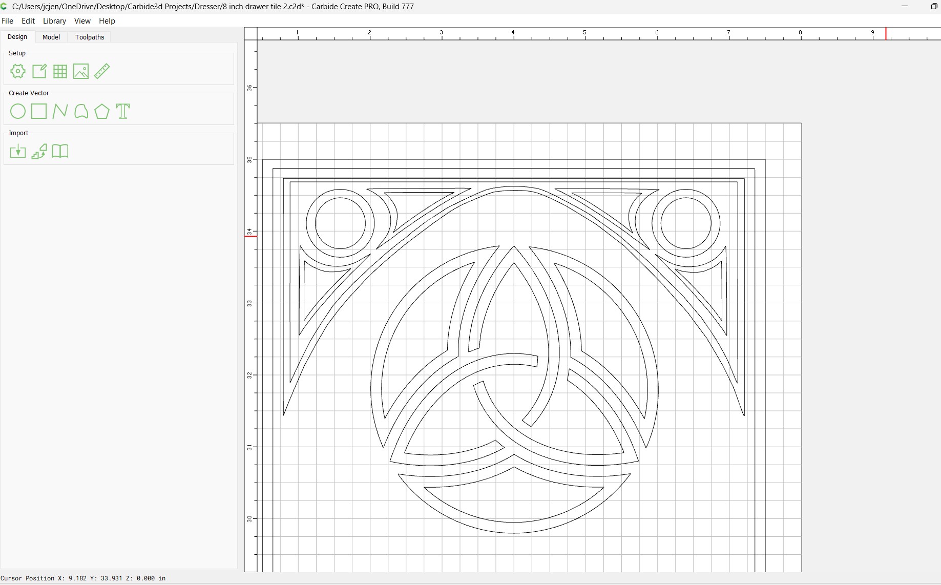

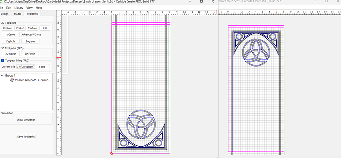

I’ve encountered a tiling malfunction I can’t seem to correct. Project size is y35.5"x- x8". I set up for v-varve and selected the tiling function and reset the overlap to .25". Tile 1 for the bottom half and tile 2 for the top half. Set up and manual zero machine. tile 1 cuts perfectly. Tile 2 however, cuts the perimeter patten .25" inside the set parameters from the top edge. I have it set at .5" from top edge in design and the sim shows it correctly but it’s cutting it at .75" from top edge.
What am I missing?

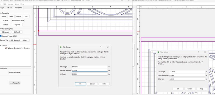

What is your tile size? And how far are you moving the stock? (They should be the same)
17.75" x 8" I marked the centerline on the stock and moved it down to that mark for tile 2

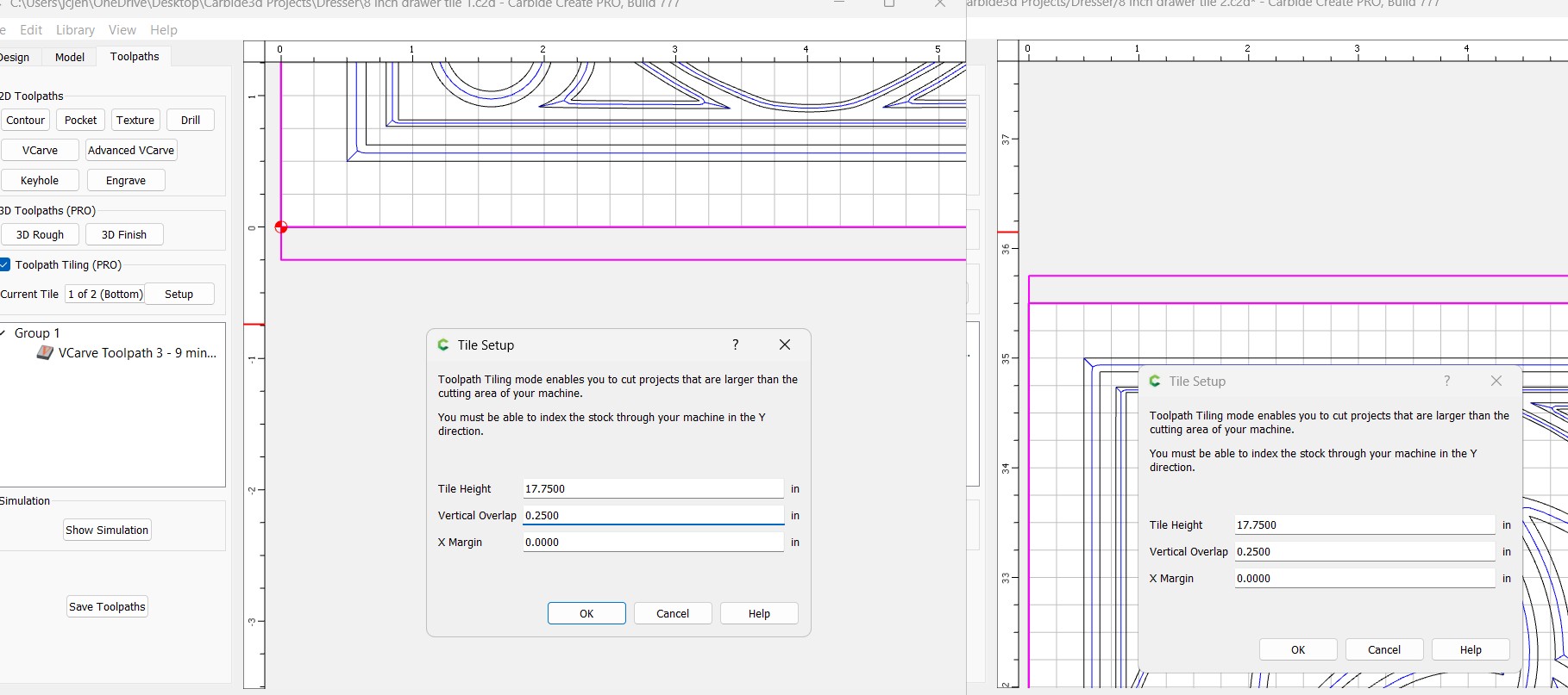

OK, what is the “Tile Height” in the tiling setup screen, and how far are you moving the stock?
If your centerline isn’t EXACTLY the same as the Tile Height, it will be off.
So rather than marking centerline, make a mark EXACTLY the tile height from your first Y zero. Don’t include the overlap.
Is the tile height not also the centerline?
Only if your workpiece is EXACTLY 35.500" long And you’re precise it marking it. :wink:
I changed the overlap margin to .5 on tile 2 and it solved the problem…
