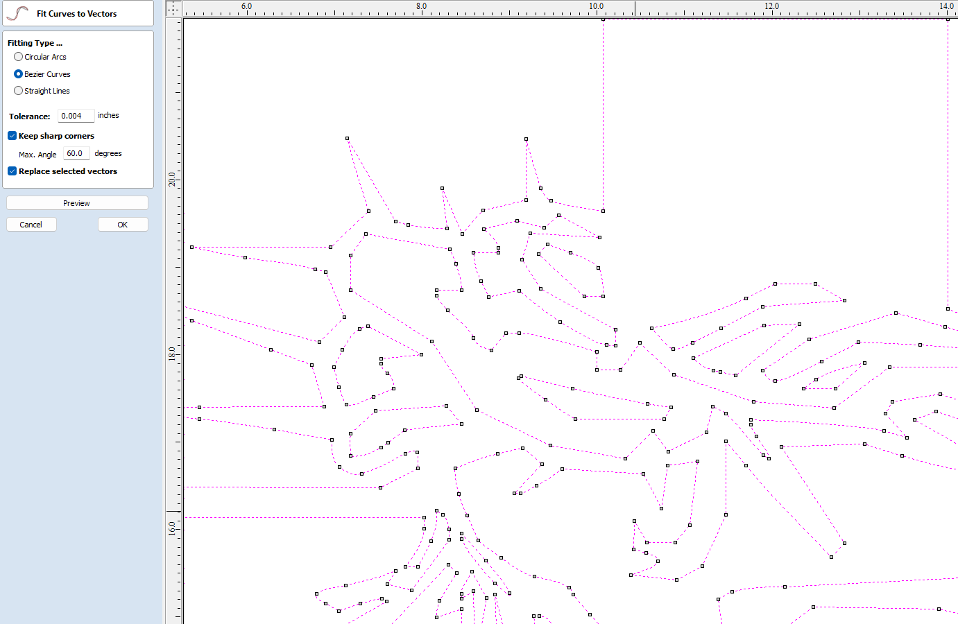

is there a way to simplify the exported G-code file? I am using carbide create pro and the Gcode file is very data heavy, so much in fact that the Cnc machine slows to a grind for every corner… potentially overheating the bit as the feed speed is no longer relevant as its labouring through the data… I use Openbuilds Black box, and the TOUCH controller. I have a 4.5MB nc file that’s taking forever as the CNC is slowing down for every rounded corner… My 3d printer uses a plugin called “Arc Welder” which simplifies the arcs without quality loss… is there something similar for Carbide Create???

Post the SVG. I have Vectric and can reduce the number of nodes with fit curves to vector function.
Original
Updated:
It makes a big difference in the file’s size and the carve’s smoothness.

its not the SVG file as the vector graphics are nice and simple… not thousands of nodes…
