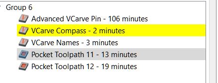

I thought I had seen an answer previously, went through Git Books, and searched the form. After an hour I was unable to find out why my Tool Path shows green in CC.
Can someone enlighten me? I don’t see an issue in the simulation.

Green or yellow?
In my experience, a toolpath will highlight as yellow when there is some problem with its calculation and sometimes that highlighting will not clear during a session.
Usually saving, quitting, and re-loading fixes it.
If you get a file where that doesn’t work, let us know and send it to us and we’ll look into it.
That picture you posted has a bright yellow bar on the second line. Either your monitor is dying, or you may be colorblind. ![]()
As Will said, that will happen when you get an empty toolpath but after fixing the issue the coloring doesn’t clear at least in that session. It may clear if you save and re-open the file.
