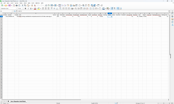

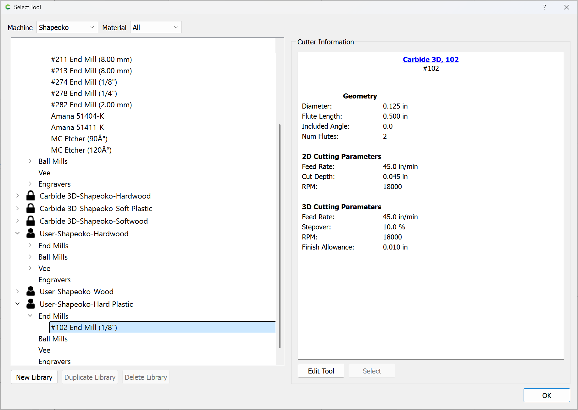

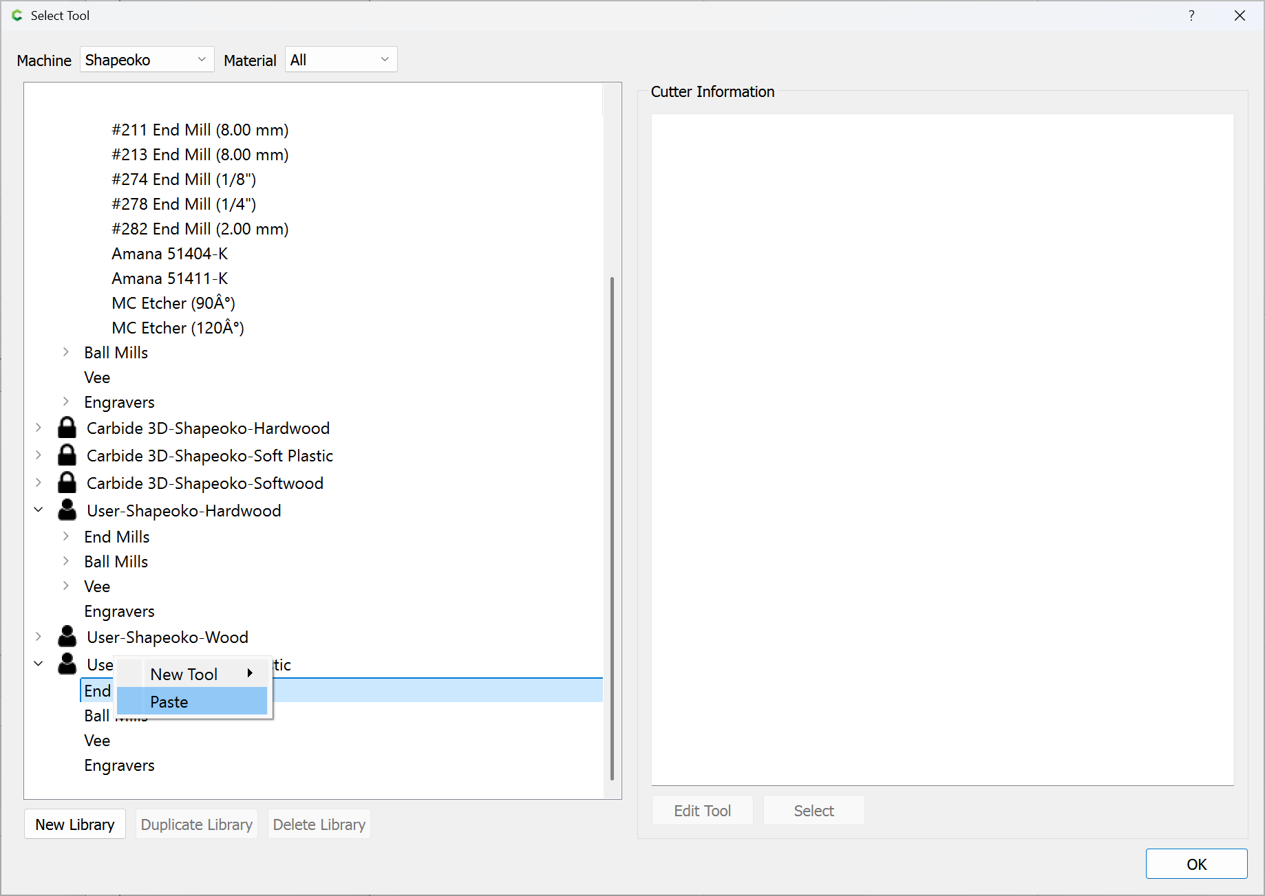

Note that the tool databases are stored in .csv files, and one can duplicate a Tool from an existing Library:
create a new one:
and paste it:

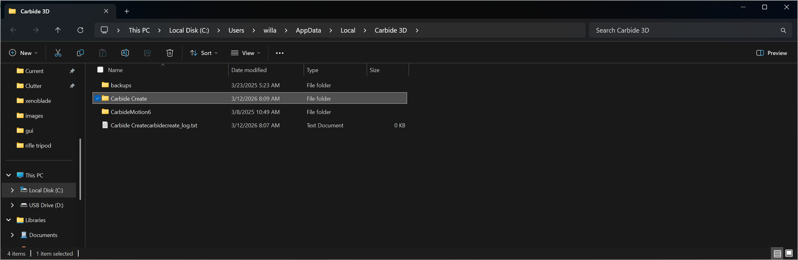

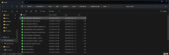

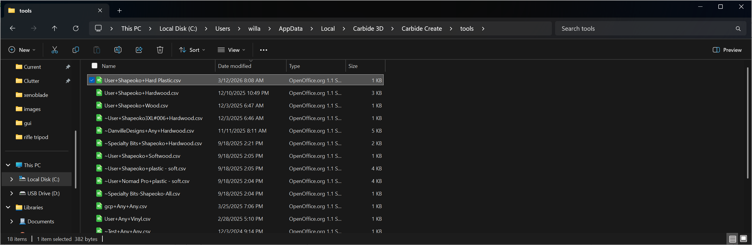

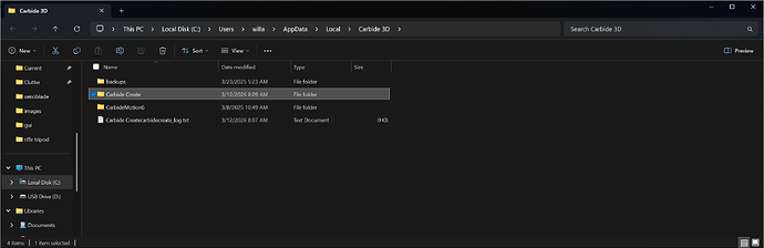

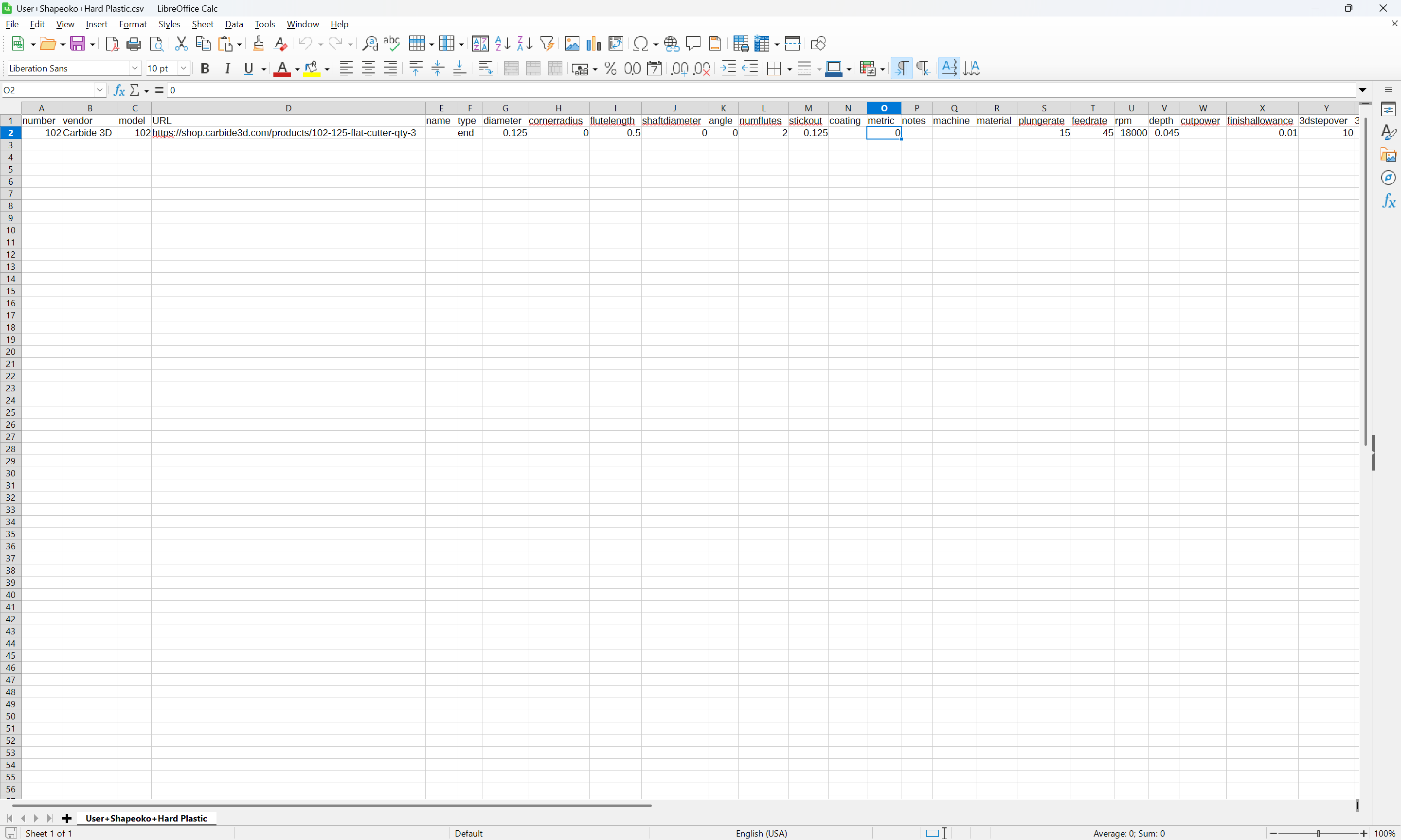

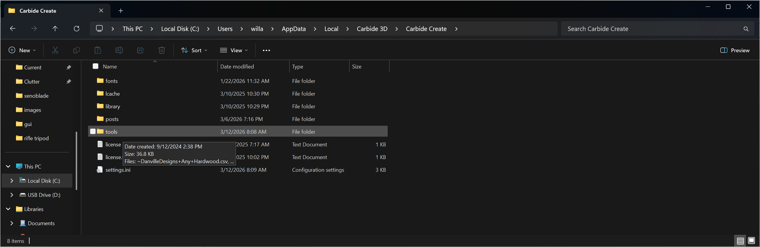

Note that the units used for a given tool are specified on a per-tool basis, so one could then do Help | About Carbide Create | Open Data Directory to get to:
and then edit the .csv file for the tool:
loading it into a spreadsheet, and editing as desired:
esp. note the metric column, where I believe toggling to 1 will allow one to redefine a tool using suitable formulae as metric values (just be careful not to miss any).
