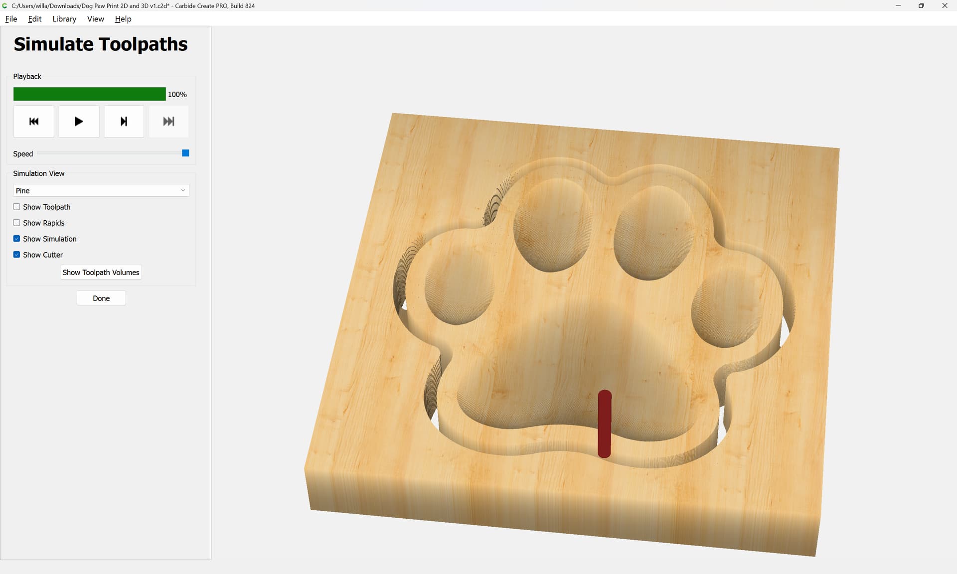

I’ve created a 3d model inside Carbide Create, the “Show 3D” option as shown in the screen shot looks great.

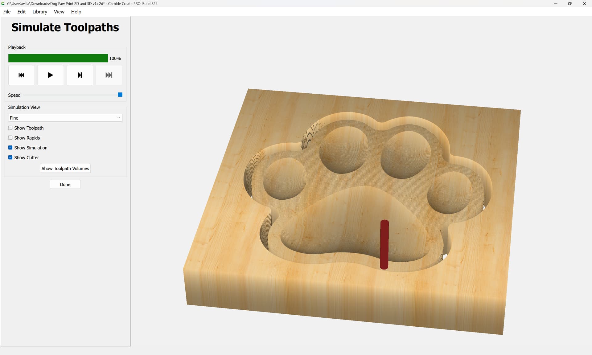

However after creating tool paths, both rough and finish, I have these ugly steps at the top of my gradient in the show simulation section.

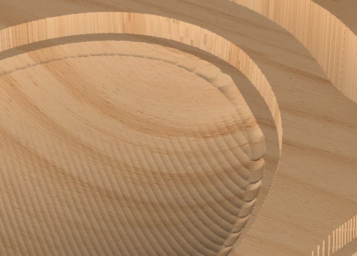

Here’s a closeup of the cliff and ledge at the top of each toe.
I had hoped this was just a weird rendering quirk but when I cut out a test, the same ugliness showed up in the actual carve.

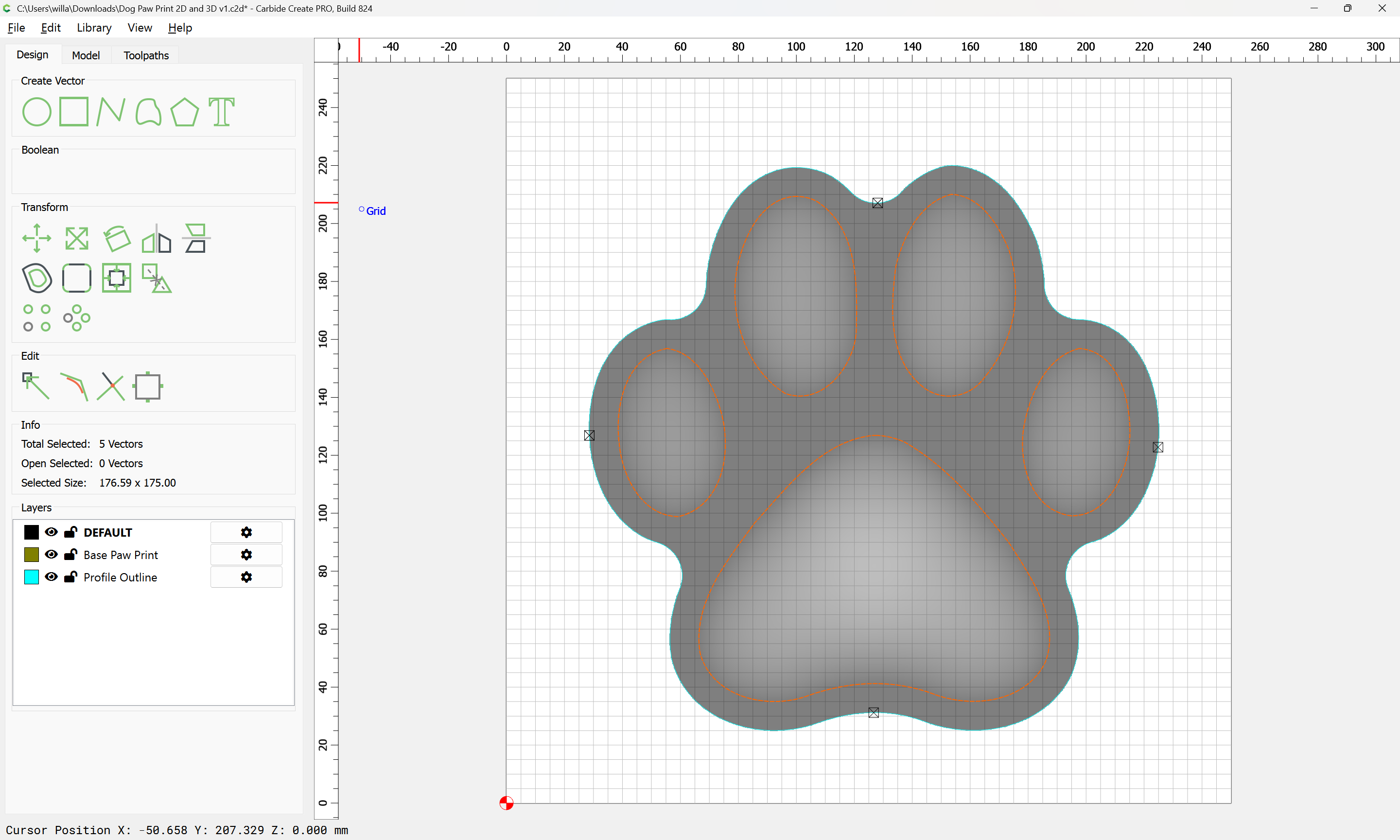

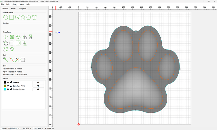

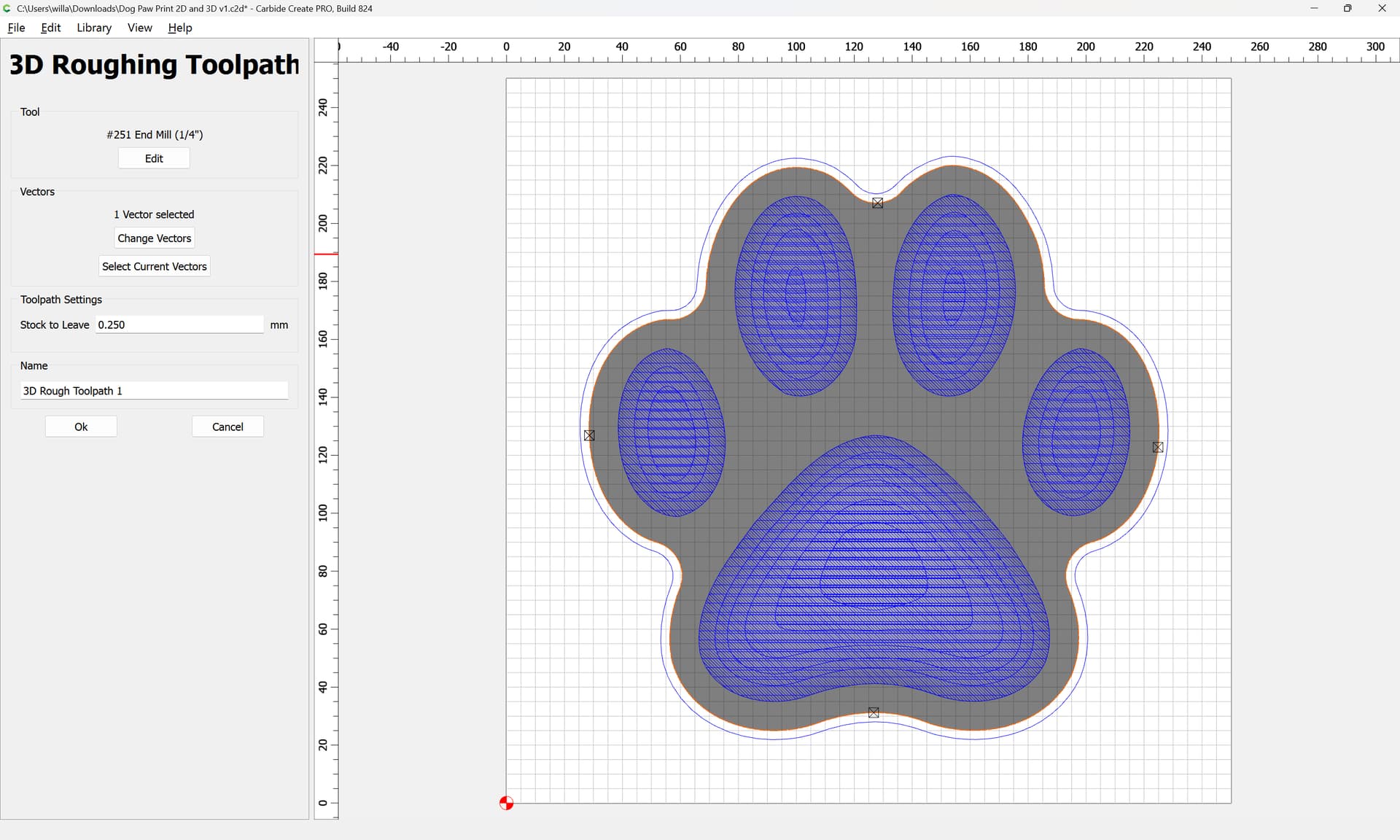

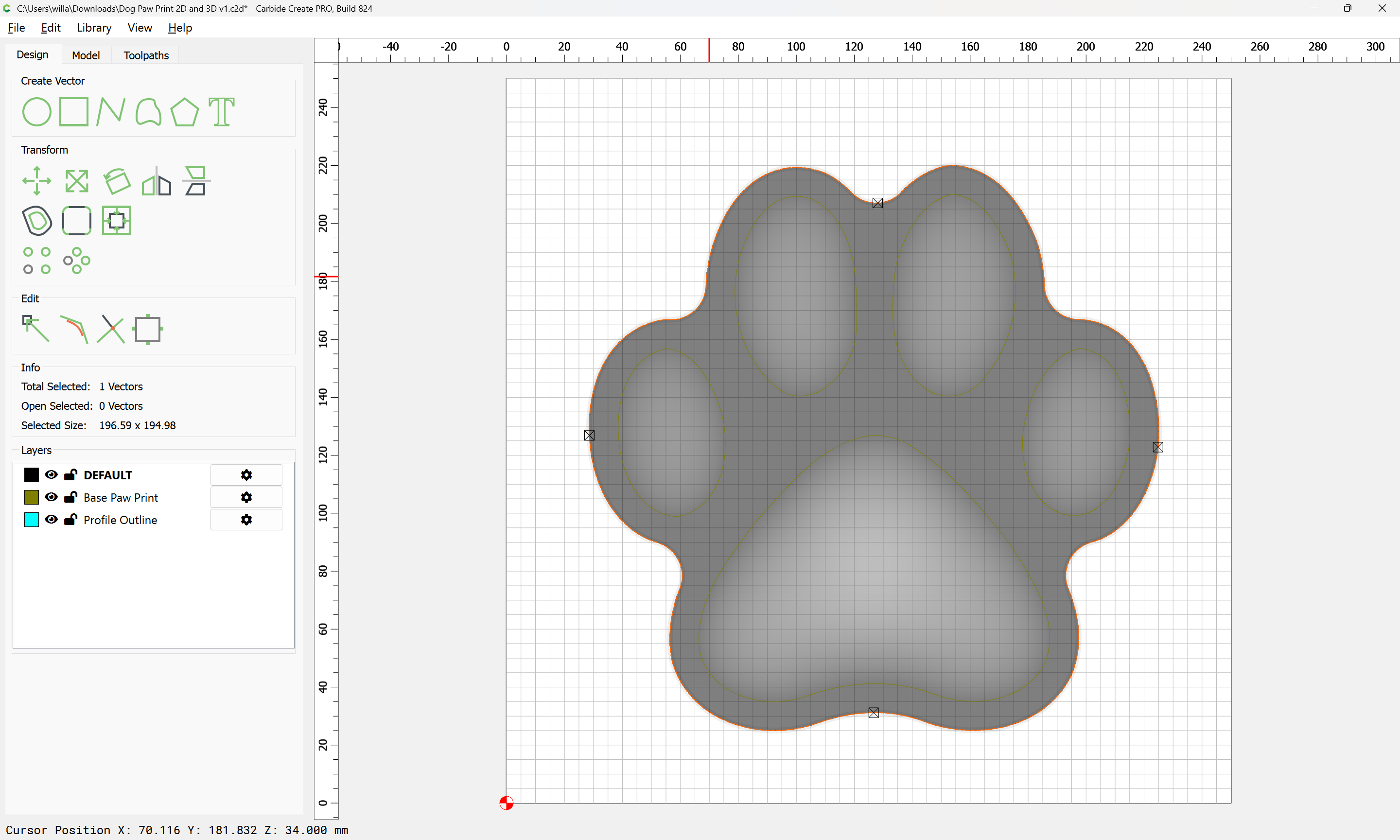

You are selecting limiting geometry:
Instead, select the outer geometry:
and change the vectors associated with the toolpaths to that geometry:

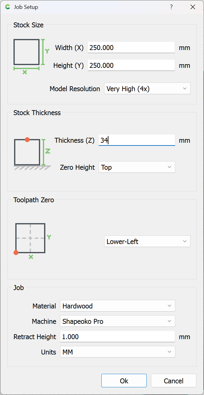

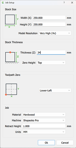

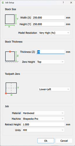

The reason for the ledge is that the top of the model does not match up with the Stock Thickness:
Thank you, that worked, but I’m not sure I understand why. I get that the model was set to be slightly thinner than the stock, and setting it to the correct height brought the overall object to the surface. But I don’t understand why selecting the outside of the 3D shape vs the individual sections changed the way it cut. Is there any documentation on how that sort of thing works that I can refer to?
If the model is thinner than the stock thickness, then there is material above the model which needs to be removed — the 3D toolpaths only interact with the 3D model.

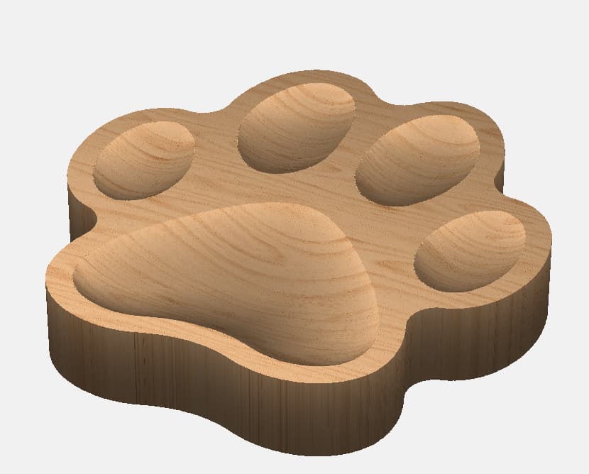

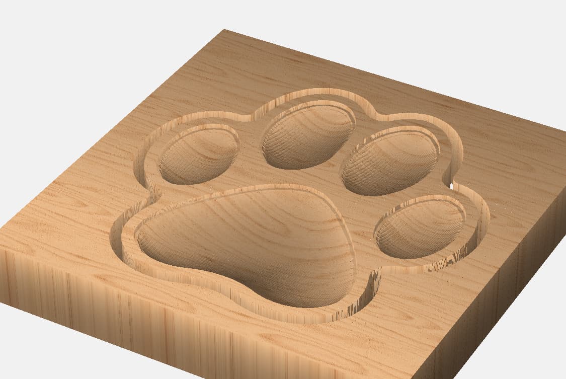

If the stock was the same thickness:
then the cut is as expected:
since there is no uncut material above the model to be removed.
