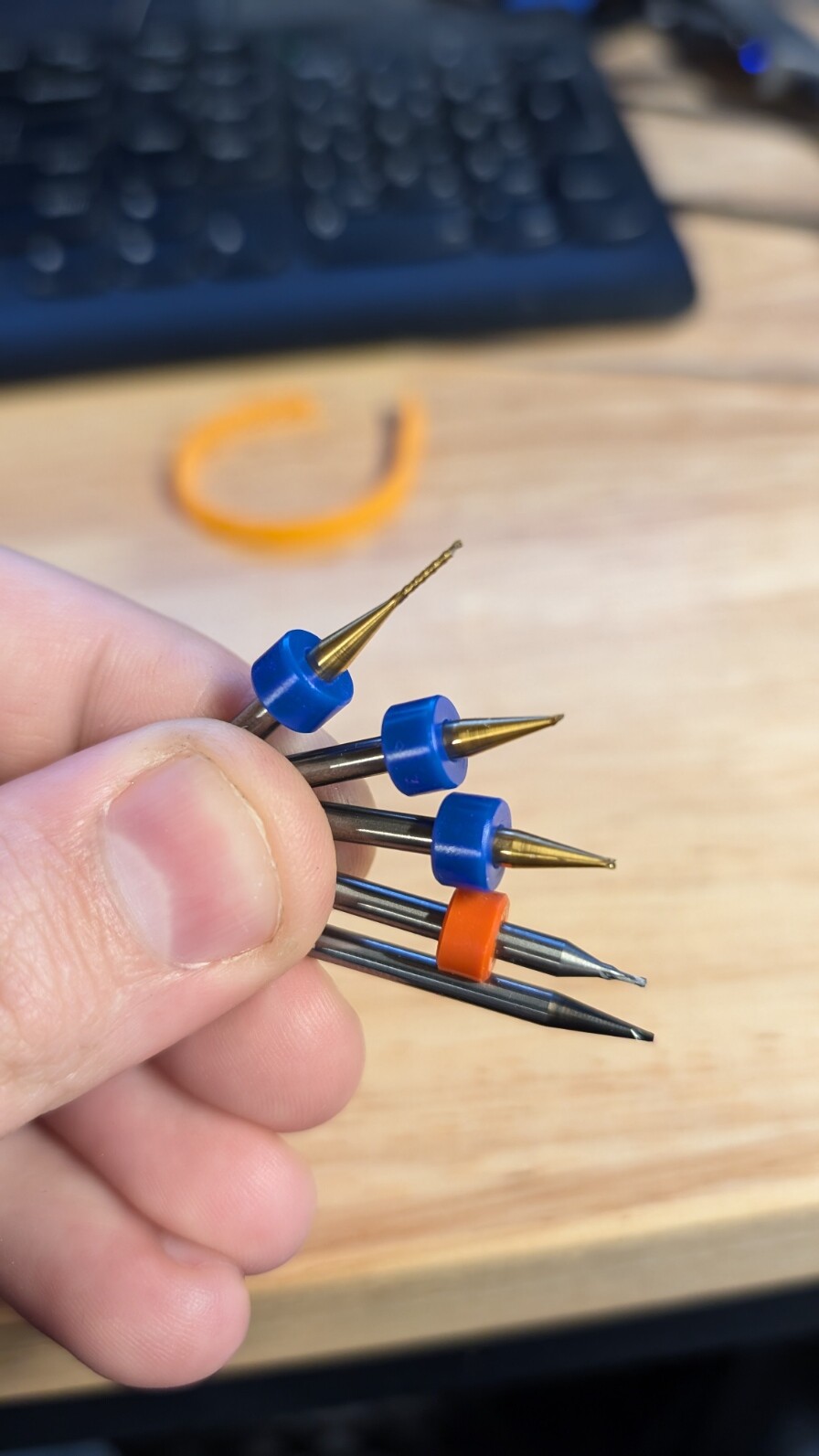

I’m cutting on the Nomad 3 and I realized my bits have been getting duller much faster than when I was using my old Roland MDX40. Then I realized any time I would run a 1/32" bit the tip chips before the cut even starts?!?! I took a closer look and it’s breaking on the bit setter!! This machine has eaten 4 $65 bits and I got a client on my backside asking for there parts. Is there a way to set the bit manually and skip the bit setter?!?! I need help I like this machine but I’m about ready to get rid of this thing for a bantam or carvera just to keep my client happy.
We have your ticket on this and will respond as quickly as we can.
Which tools are breaking? What is the geometry of the tools which are breaking?

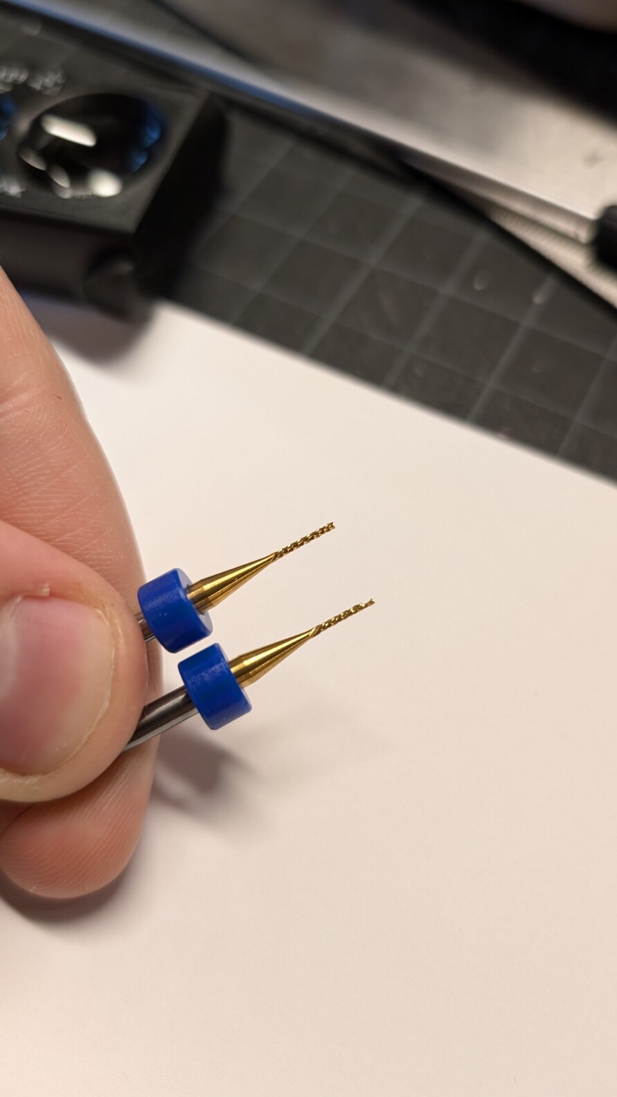

Could you take photos showing an undamaged and damaged tool?

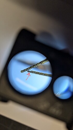

Its dulling my 1/16 in (1/4 in cut length) bits and chipping my 1/32 in (1/4 in cut length) bits. Attached are the pictures as requested, the magnified one illustrates what is happening the best I caught before it touched the working material. I would provide more images but as a new user, it will only allow me to upload 1.
I have upgraded your account so you should be able to upload more than one image, and added a link here to your ticket.
Thank you, here are the other two images.

I fixed the original issue!! The nut across from the mag sensor was screwed in way too tight so I flipped it on its back and griped the peg with a pair of rubberized players and slowly turned the nut until it was just off of the mag sensor when depressed. After re-initializing, it works great! Just wish I could get back the cutters haha.
