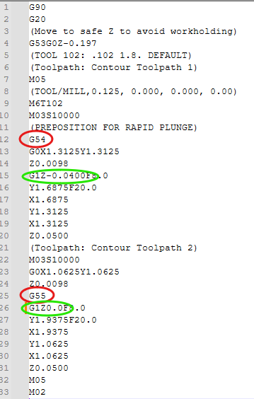

Here ya go…
The only thing added is the G54 & G55
The first Z is relative to Top of stock, the second Z to the bottom, or slightly below.
The constraint you mention is controlled when you set the fixture offset on the machine.
CM will most likely draw both paths relative to a single Z zero. It has no idea where the G55 is relative to the G54.
More advanced controllers do ‘know’ where the offsets are. You set them using the controller.
With CM, you set the offsets using macros or MDI, and only GRBL is aware of their position.
As long as the offsets on the machine match the offsets programmed, you’re good.
The relationship is preserved in the operators head. :wink:

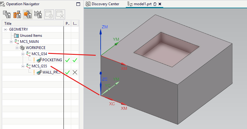

In NX, I can create multiple MCS (Machine Coordinate Systems) and assign a fixture offset to each. But all this does for the Gcode is add the G54, G55 as I edited them in above.
But I’m also working with solid 3D geometry.
The power comes in setting fixture offsets on the machine.

What you’re asking for is multiple work offsets. Which is something that isn’t supported by carbide motion and I’d bet the controller doesn’t support it if ran by another program but I’ve never tried.
What others have said is correct that if you have an accurate material thickness then it’s not an issue.
Other controllers such as a masso are cable of multiple work offsets. But upgrading a shapeoko to a masso touch is far from cost effective. You’re better off buying a different machine.

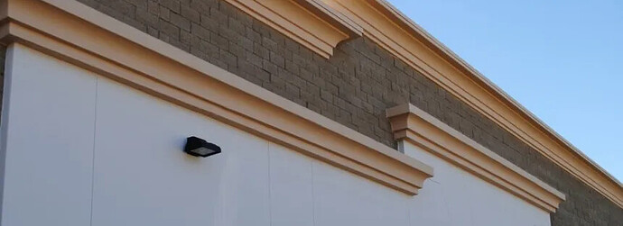

Try Styrofoam. It’s and interesting material to work with, in many ways it can be treated like wood. Finishing is where it becomes more challenging.
It’s very likely those features were done in Styrofoam in the picture below.
It becomes mind boggling what you can make with foam.

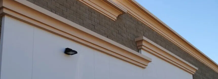

Our tract house in California had a metal frame, sheet Styrofoam insulation on that, and those type of “architectural details” that were hot-wire cut from Styrofoam and attached to the surface, and then the whole outside was sprayed with polymer-modified stucco. Flexible but earthquake-resistant…

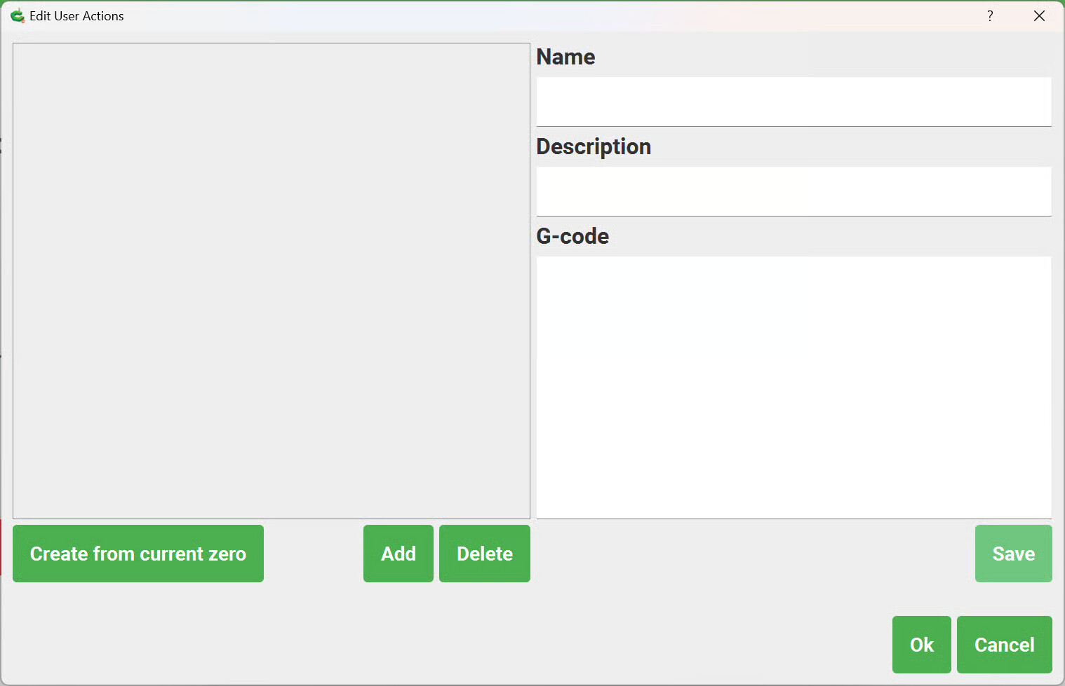

To expand on, and make explicit the answer, Carbide Create/Motion do not have a direct facility for this and it would be necessary to use separate files, but Grbl does support G54–59 Work coordinate systems, so it could be done using some other software — depending on what one wanted to do, it might even be possible to set up a Quick Action to facilitate this, but the usual approach there is to set a zero based on current machine position which may then be referred to — there’s a button for that, “Create from current zero”:
