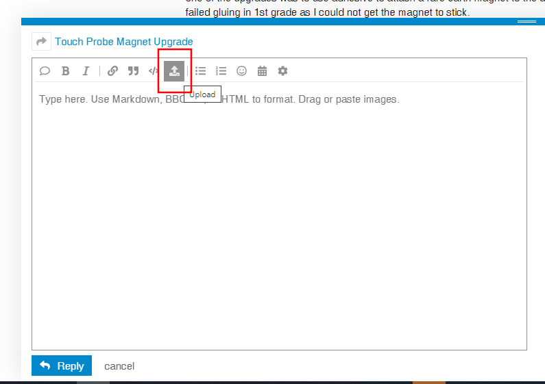

Not sure how to post photos on this forum or I would include a picture.
Thanks, Bill
to post a photo you can use the Upload button :
Well, that was easy.
Thanks
