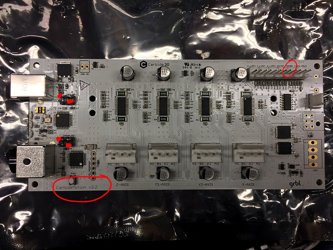

I’m really intrigued by you mentioning that you are using the Estlcam exclusively as I think its the perfect tool for me too but I’m unsure how to go about setting my machine up to use it. I think it would be useful to be able to switch between the software too but not essential if its easier. I’m especially interested in the probing 3d parts that Estlcam provides as I mostly engrave aluminium parts of all shapes and currently have to draw measure and draw each one!!!
I believe my board is Carbide Motion v2.2.
Would you be willing to tell me exactly how to go about it and how I can then connect a probe? Plus are there any downsides? Like does the measuring probe become redundant etc.
Any help you can offer will be much appreciated.
v2.2 CM should work right out of the box with Estlcam (no PROG pushbutton). I had some issues with the bootloader of my v2.2 board and I ended up reflashing the bootloader. I documented the reflash here:
I also used the standard Shapeoko configuration right out of the Estlcam box, and I don’t employ the Shapeoko homing switches (those I use with my GRBL controller).
Sounds like Estlcam contour mapping will get you where you want to be.
I’m not Jim, but can assist: First the new Touch Probe will come with the necessary documataion to tell you how to connect the probe to all versions of the GRBL board. But as the owner of a Ver2.2 board AND a Touch Probe, here is how (I believe) you will connect it.
See photo.
You will connect to the two (2) pin connector marked PROBE (part of the long white connector) and circled in red. Nixt, you will also connect the provided pigtail to a 5V source. I have identified four 5 Volt pins on the 2.2 board (Red Dots).
I ALSO have a probe that is part of the Additive Aerospace kit, and I use it to locate the center of holes (when I want the center of a hole to be my X0Y0, so NO it does not become redundant, it just becomes another tool in out toolbox.
I hope I have answered all your questions.
