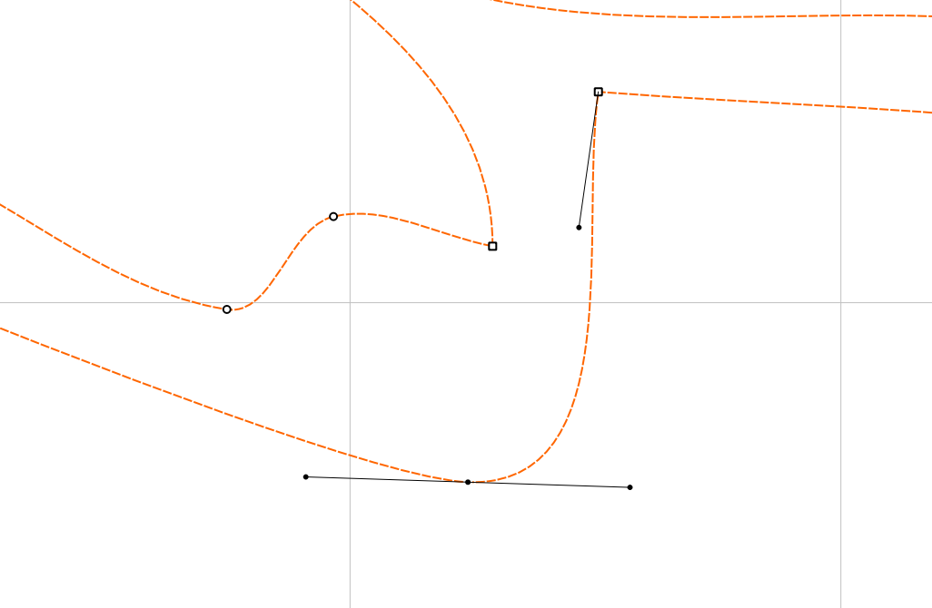

Hi all, I’m wondering if anyone knows how to smooth the jagged lines from image tracing without redesigning the whole image?
The Threshold angle will create smoother curves with a lower setting.
The “Convert to Curves” toggle also seems to smooth out the lines when checked.
Thank you I will try it out.

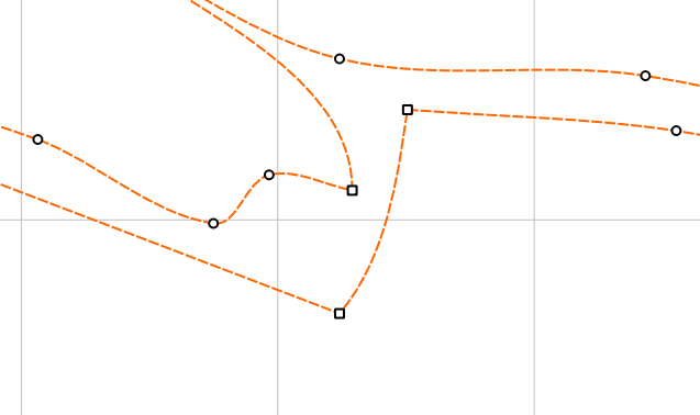

adjusting circle nodes adjusts the line from square node to square node.
Adjusting square nodes which should generally be placed at corners uses the square as the pivot point (if it doesn’t you can move existing or create them)

You can also select the Vector, hit N, and go node by node to “Smooth” the vector.
Square Node is sharp
Select Square Node and Hit “s”
