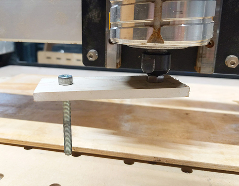

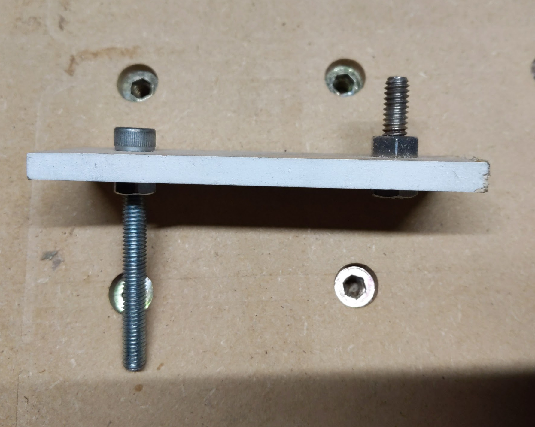

Here’s my super cheap tramming tool:
Small bolt is a 1/4 inch diameter. I use the collet that came with the router, not nicer ones I use for bits. Worked like champ.
Exact same idea, I like yours more as there is no need for 3d printed part.
