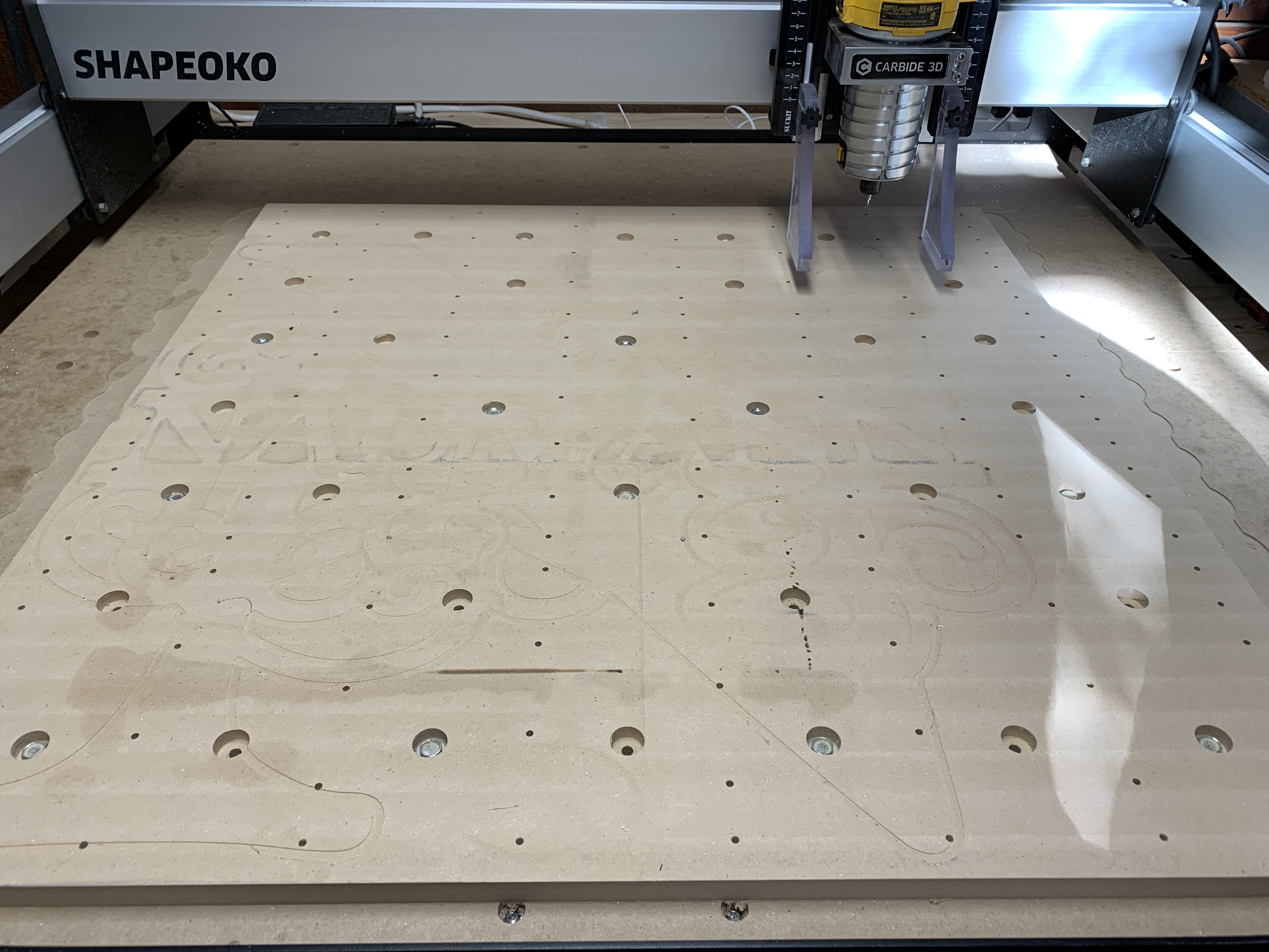

This is my 2nd go at flattening my wasteboard. It’s better than the 1st, but I’m still having problems with my Y-axis. X-axis seems to be almost perfect. Can’t see or feel the lines on the south part, but you can slightly on north side of the board. I have grooves on east and west because of my Y-axis…is this little bit okay or do I need to straighten it up like X?
I followed Winston Moys tramming video, but I must’ve done it wrong because tramming showed both my x and y way off. I’m as green as it gets to a cnc machine and this is giving me a headache. How flat did you get your wasteboard? PLEASE HELP!! :pray:

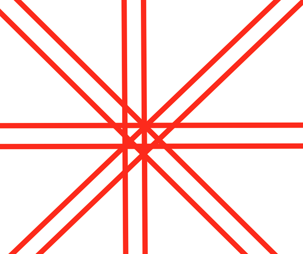

I also use a special pattern when machining my (aluminum) wasteboard.
Left to Right
Down and Up
45º and -45º
Something like this:

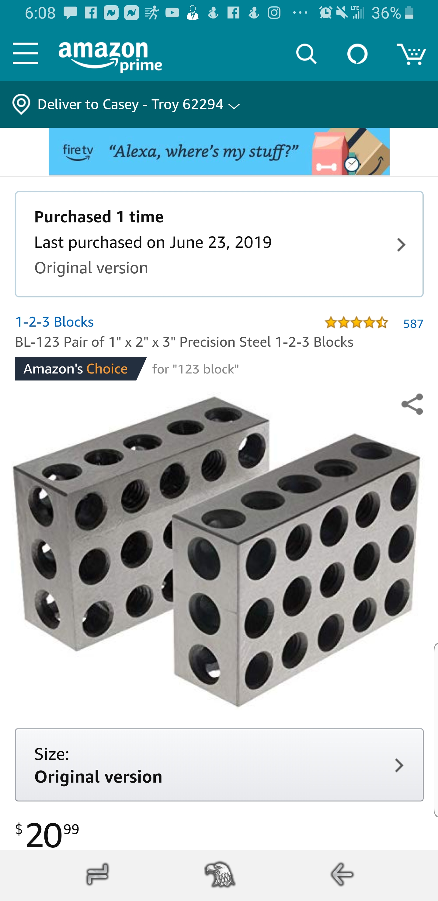

That’s the file I ran and he said next step would be to tram and recommend Winston’s tramming video. I adjusted the router collar, but I don’t have machining blocks or anything the right size to square up the collar so I just went back and forth making adjustments. I guess I need to invest in some of those 123 blocks he was talking about unless anyone has any other ideas. My squares aren’t big enough to fit under the collar. I have to bring it down to far where the bottom v wheels come out.

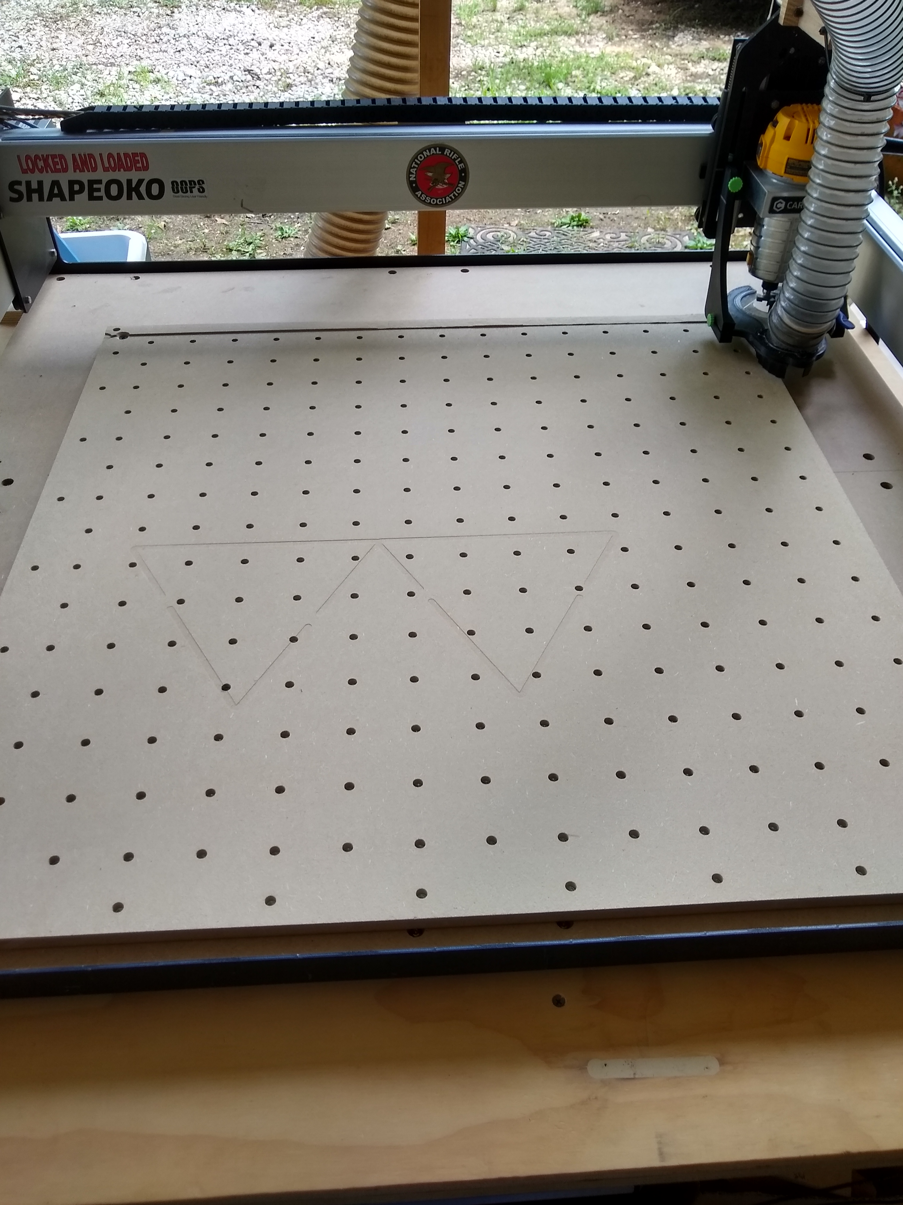

This is a timely subject for me. I Tramm’ed my supplemental MDF spoil board today. I had Tram’d it about 2 months ago and had some of my projects showing through so I decided to do it again. When I first Tram’d mine I had noticeable peaks and valleys in both directions. I got 1 2 3 set up blocks from Amazon and used them to get my router mount square. Then I shimmed the lower part of my router mount with aluminum foil and got my almost perfect. After running the Tram today I could see very small ridges and I ran a medium sanding sponge over the entire spoil board. I just very lightly used the sanding sponge and after I could feel no ridges in either direction. You can go crazy trying to get every defect out. Since this is my 3rd time to tram I think I might have 1 or two more passes before I have to replace the spoil board. I used the Myers Woodshop plans to make my spoil board and fences as well as the cam clamps. I am very happy with my results and I know that my spoil board is plumb and square with the router. The 1 2 3 setup blocks were very useful and were not very expensive. If you do not use the set up blocks it is a lot of trial and error. The more times you have to remove the Z axis to adjust the router mount the more chances you have of getting things out of kilter. Even if you base is not perfectly flat after tram-ing the spoil board will be square and plumb to the router. You can make your self a jig or buy one that has a dial indicator and check the flatness but that may be overkill for the Shapeoko.

This is my spoil board after tram before I put my fences back on. The two triangles were from a project I cut too deep but I decided I did not need to get it perfect. You cannot see any of the defects after I ran the medium 3M sanding sponge very lightly over the entire surface. This was my 3rd tram and on the first tram I had a low spot in the front left corner. The second tram had me level and plumb. The third tram took only one 0.010 pass and it was perfect with no low spots.

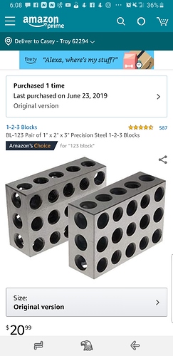

I’m not sure where to get the link from so I just took a screenshot lol.
Thanks @gdon_2003 for your link! I thought these blocks would’ve been more expensive. I ended up going with Amazon choice because of the reviews and free 1 day shipping. That other link said it wouldn’t ship for a few days… I’m impatient :see_no_evil:
