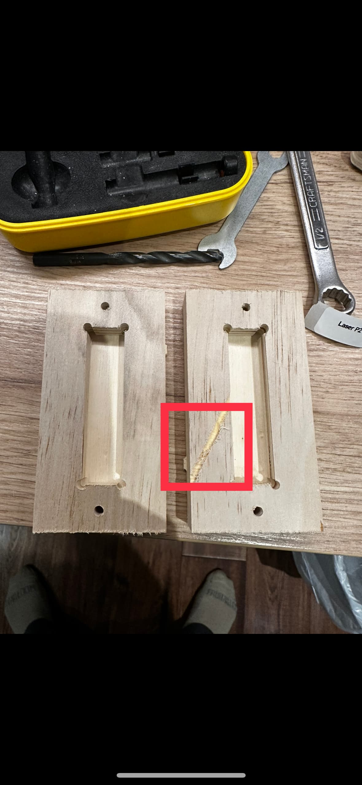

Hey guys so I created a two part job in Carbide create a pocket cut and then a contour cut. The pocket went fine I had two parts that needed to have a 12mm square cut in them and then a contour cut to full depth.
The Pocket worked in both cuts but once complete and it moved to the contour it failed to raise the tool head enough and just cut its way to the start point in the project. I am using the CC6 and GRBL post processor to a Duet board.
So I am not a GCode genius but I can see at the end of pocket is raises Z to 22.860 and the material was 17.5 mm or so but then still before it started the move to the start of the Contour it lowered the Z and cut the part.

The retract height was set to 5 mm and I watched the job it for sure didnt skip or max out the Z, its like it tried to drop the tool head on the way to the next operation instead of move to the next location and then drop the tool head.
So i ran the file again with the same results, as it moved from one toolpath to another it cut into the material as it moved from the finish point of the first toolpath and the 2nd toolpath in the cut list.
Do I have to run the 2 toolpaths separately even if they use the same bit for each cut?

All the rapids from section to section are happening at 24.1mm. It loos like you need to be looking for a mechanical issue.
From NCViewer:
I agree that is what it looked like to me in Gcode as well. It not mechanical for example the two pockets were cut with one tool path and it had to life the tool head to move between the two pockets and there was no issue with it cutting into the material while travelling. But when transitioning from the pocket toolpath to the contour toolpath that is where the tool head cleared the material and then as it was moving to the start of the contour the tool head lowered and cut into the material.
if you can reproduce this behavior, I suggest you manually check Z zero right after it happens. If the Z zero is not spot on anymore, either your tool slipped or you lost steps somehow.
Have you tried saving the file again and reloading it?
I have had this happen a few times and why it happen I have no clue. Why did saving the file again fix it? Again. I have no clue.
If you look at where the damage is on your part the path in the NC file does not transit thru that area without axes losing steps, pulleys slipping or belts jumping teeth. Are the pockets to correct depth? Are the contours cutting to the correct depth? Do you have any pictures after cutting before the pieces were removed from the machine? You are doing slotting operations which puts the most load on your machine and tooling. Consider adding offset geometry and pocketing a slot that is 110-125% the diameter of the tool. This will reduce the tool engagement helping with heat build up, chip clearance, deflection, etc. It takes a bit longer but is well worth while.
That is good advice and yes sorry I see the confusion I should have taken a picture of the operation while it was on the machine. The parts were opposite of how I have them pictured so the damage actually matches up to this movement.
Yes all other dimensions and depths came out correctly.
That motion would have caused damage from the dog bone corner not half way down the side of the pocket.
Fair point now that I look at it again.
Let me run another test tonight and take a video of it as it seams to be pretty reproducible.
