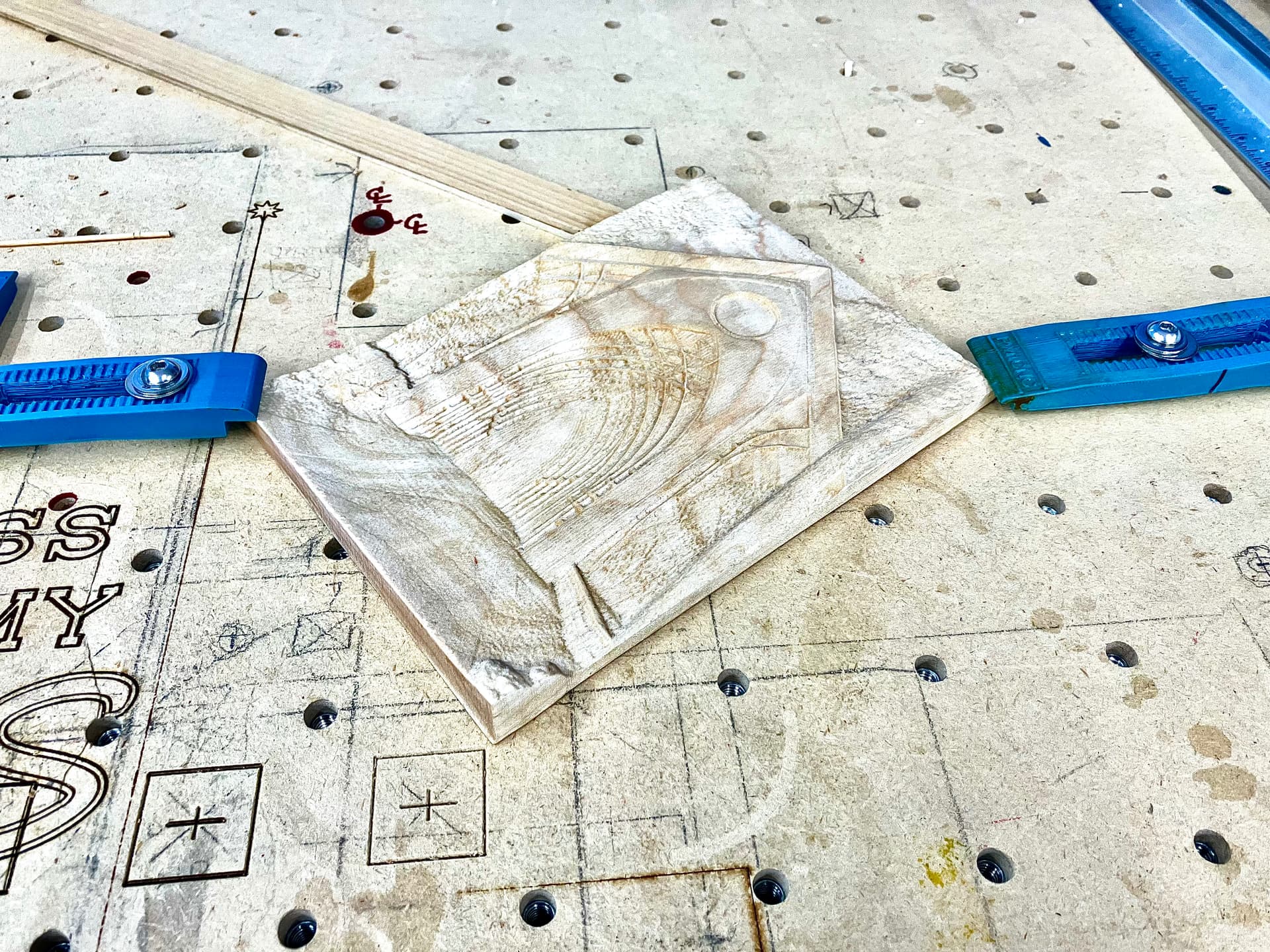

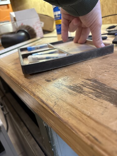

Ok… having been a woodworker my whole life (thanks dad!) I don’t have a solution to this and am wondering if you awesome people in this group who are smarter than me might.
What do you do to help eliminate warpage when carving out a tray?
I consistently have the problem and can’t figure out a solution (if there is one).

I can’t always match the thickness of the wood to the depth of the carving. So I end up with a thin result that warps as soon as I let the clamping pressure loose.

  • No. It’s a tray, so hogging out everything from one side
  • perfect example of what happens every time:
  • dimensions on this one is 3/4"x8x8
  • original size: same
  • single piece
  • Bone dry
  • I have not consulted that book but thanks!

It was “bone dry” until you opened it up. It depends on what type of milled wood it is? Flat sawn vs Quartersawn. Flat sawn does this more often and easier. Once you mill out the pockets you remove the balance of the grain keeping its self in check. This is usually consistent with the bow as you have on the pocketed side. The lower half will have more stress/movement because it has more grain to induce movement.

Put little rubber feet on the bottom or invert it on a planer sled and plane the bottom.
This happens in almost any material that’s not engineered to stay flat. We will usually start by facing the bottom first, taking off a little material (1/32"-1/16") even if we don’t need to, and then flipping it over and cutting out the rest of the features. Tod’s suggestion is even more effective, but it just takes more time.
