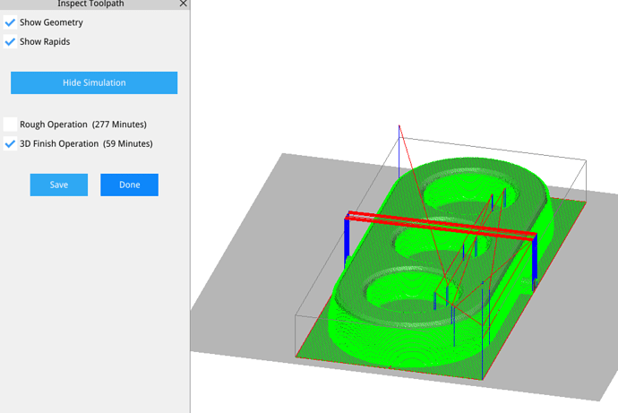

Trying a file with ONLY a finish pass and it's doing the roughing pass;
(Scott) #1
I’m trying to export ONLY the finishing pass (the roughing pass was done yesterday) and when I run it, it is doing the roughing pass (into thin air). How do I get JUST the finishing pass exported? Thanks
(Scott) #2
For now, I’m regenerated the pass from scratch (tossing the old ones) and skipped the roughing pass at the initial setup dialog. That worked and only generated finish pass but I would think just unchecking the roughing pass and hitting Save would work…
