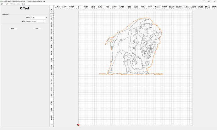

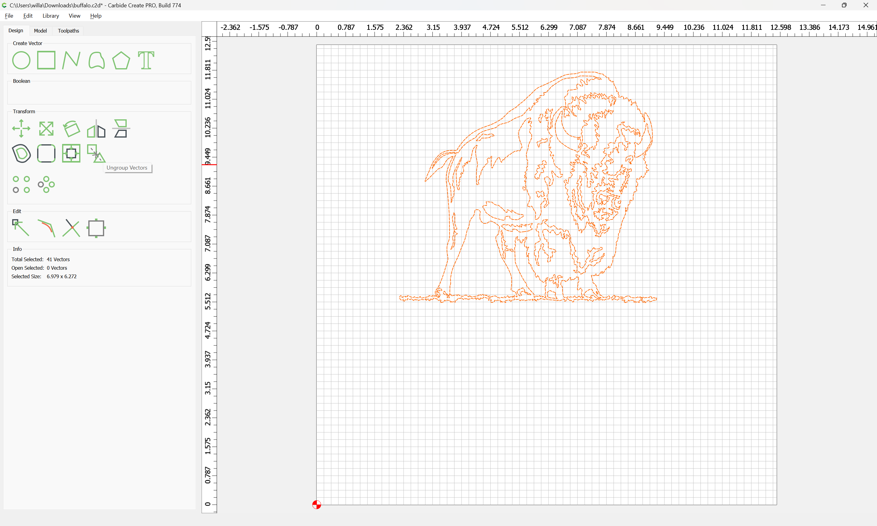

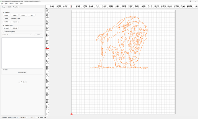

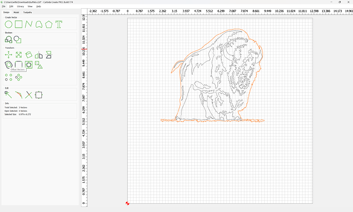

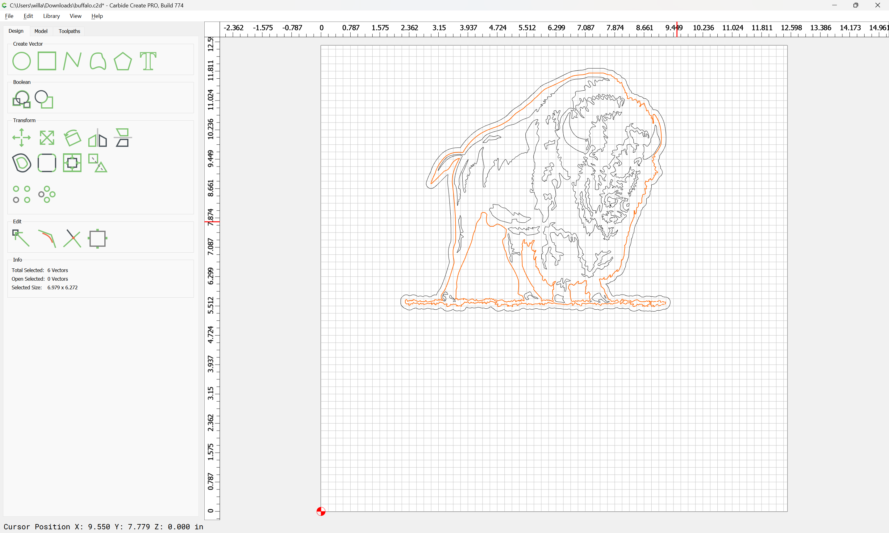

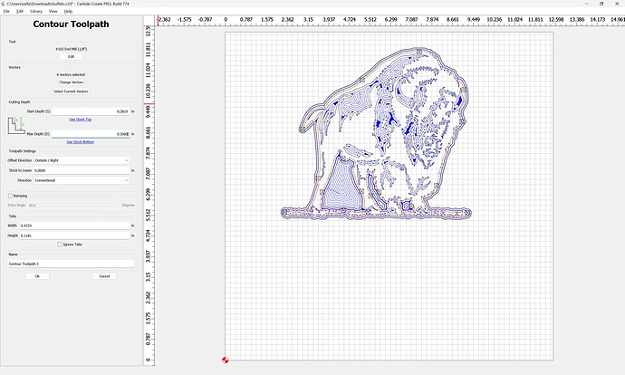

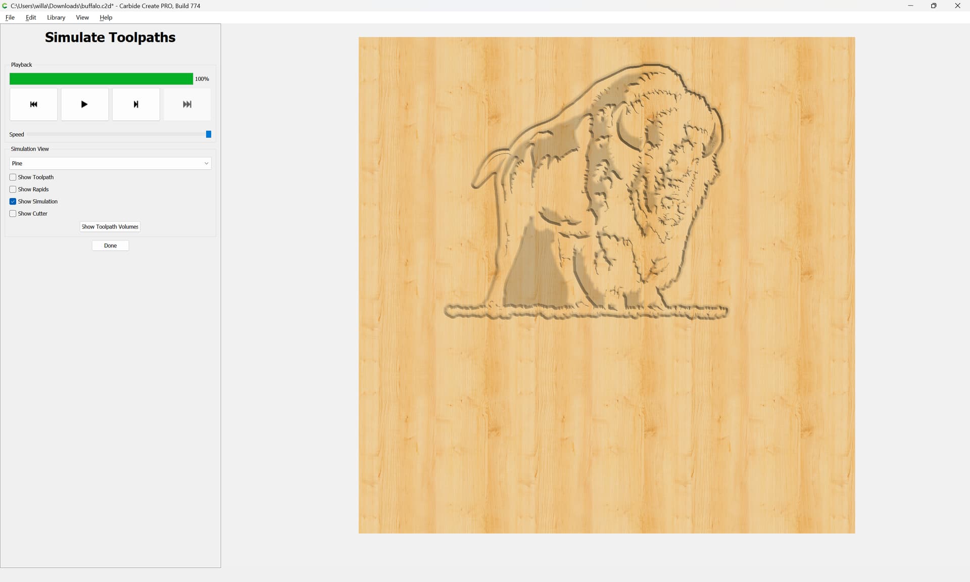

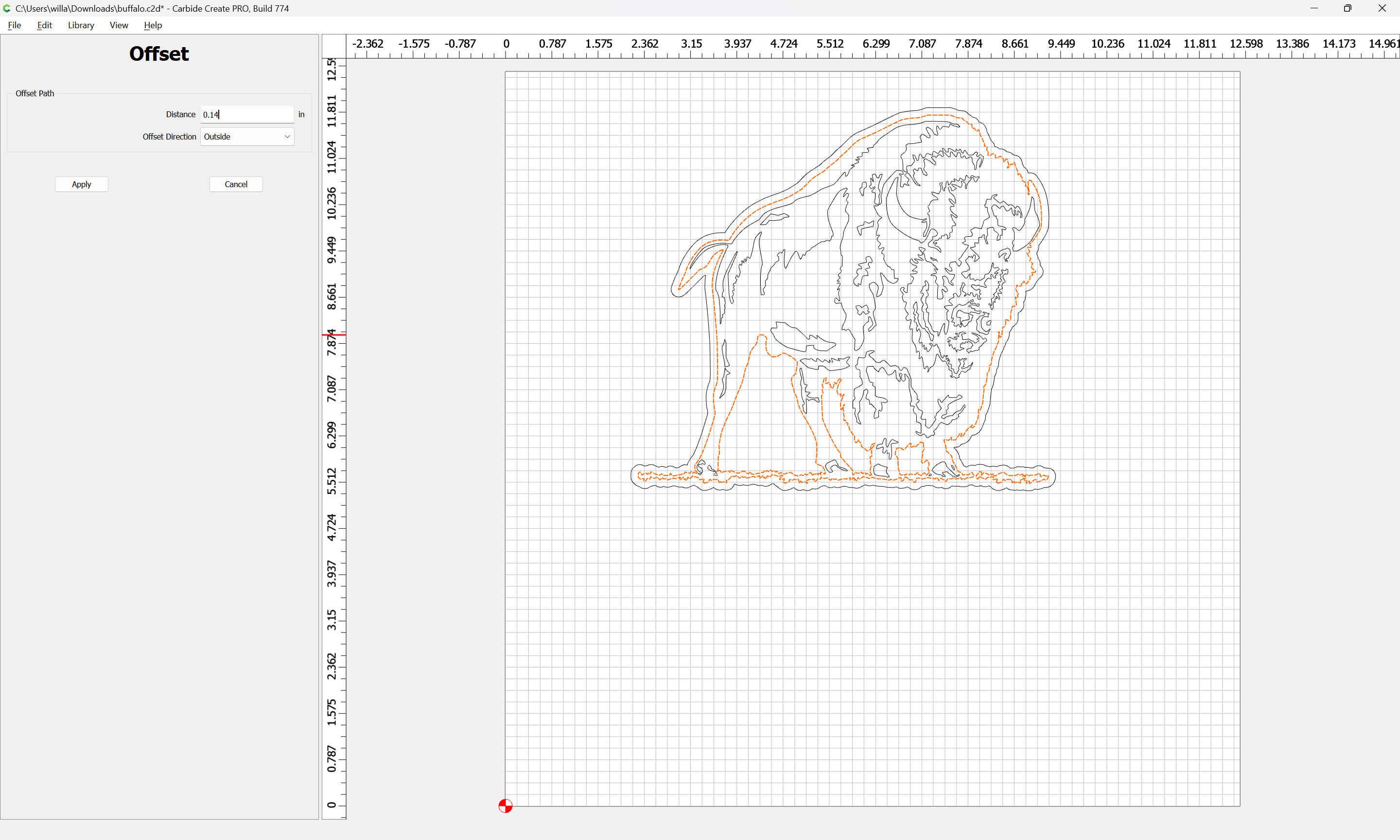

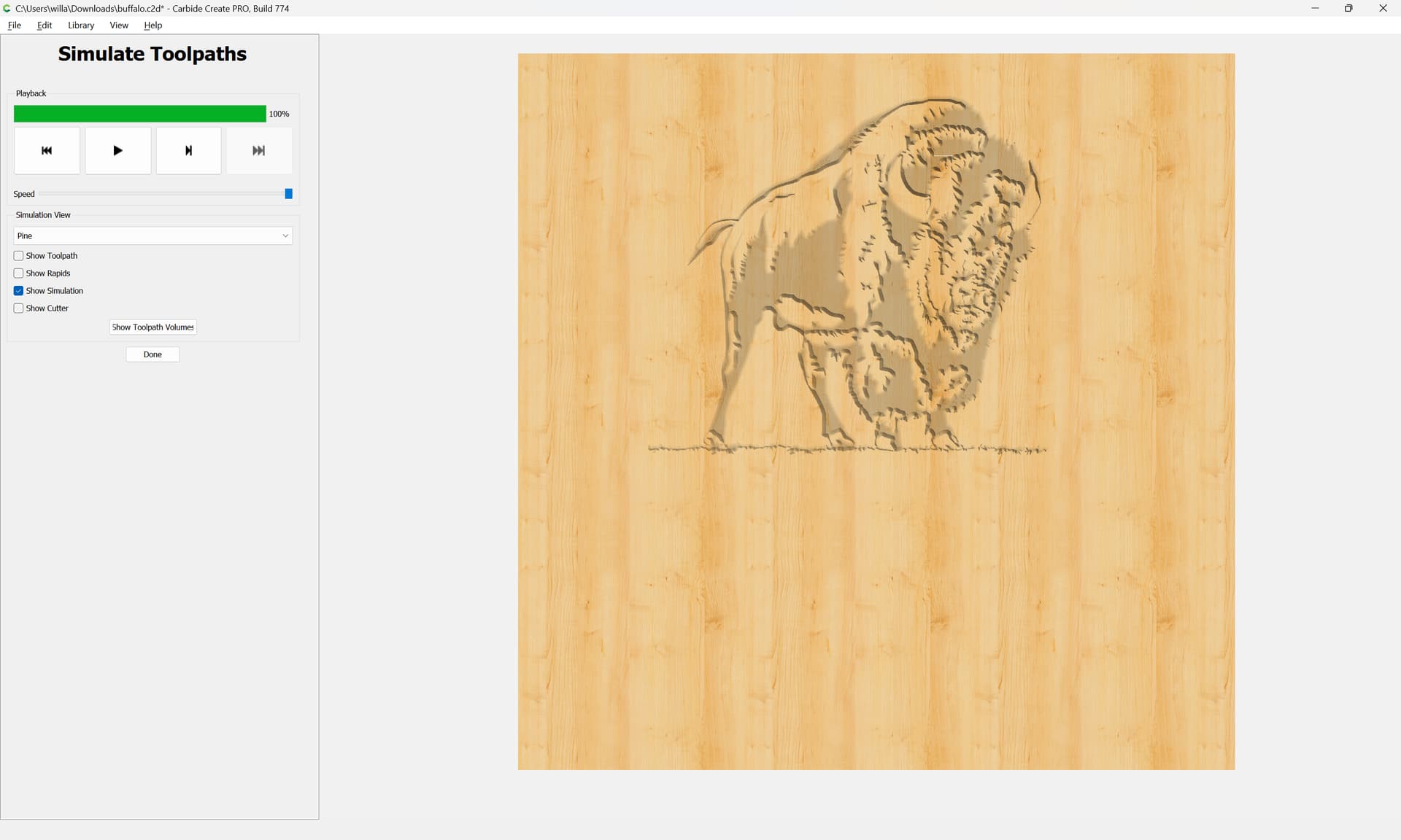

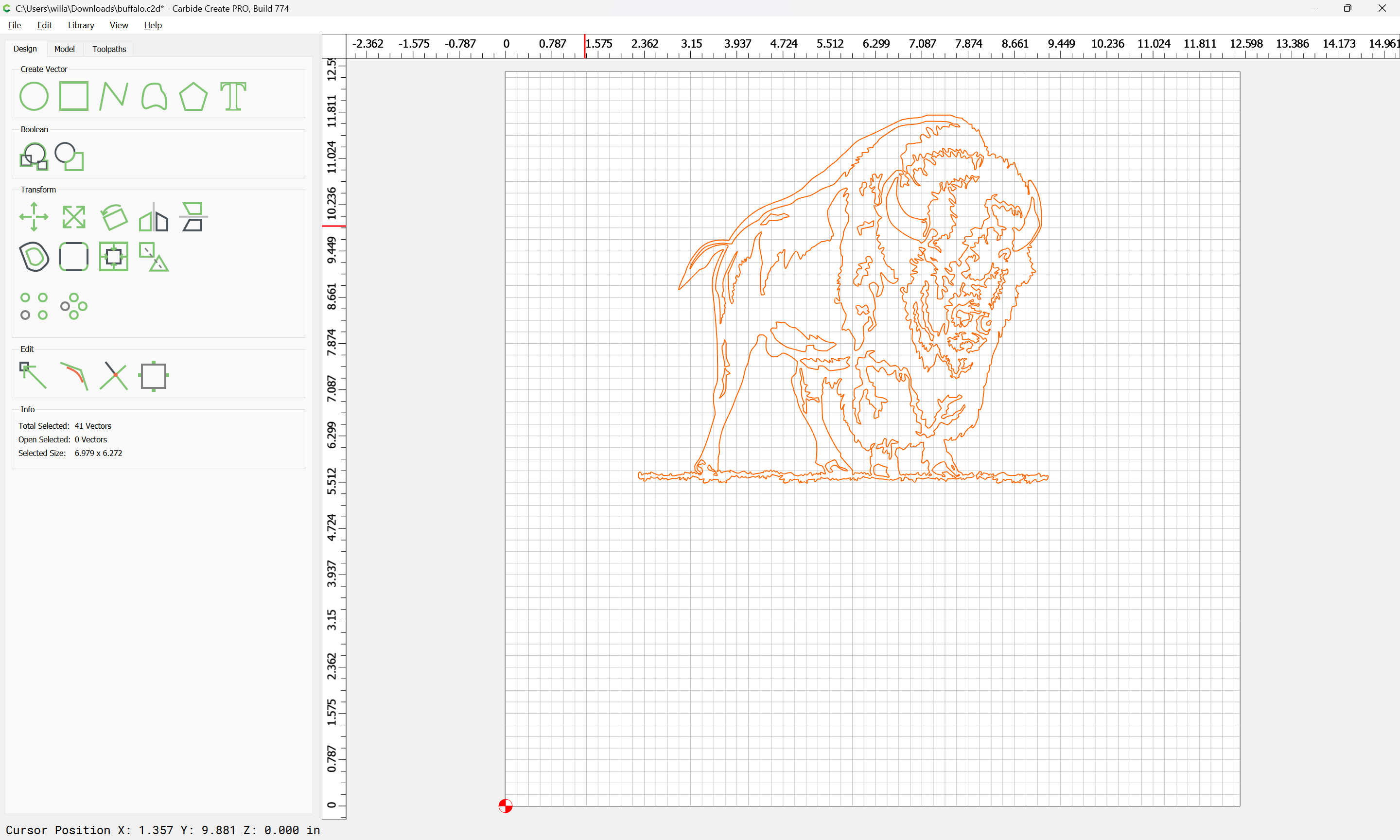

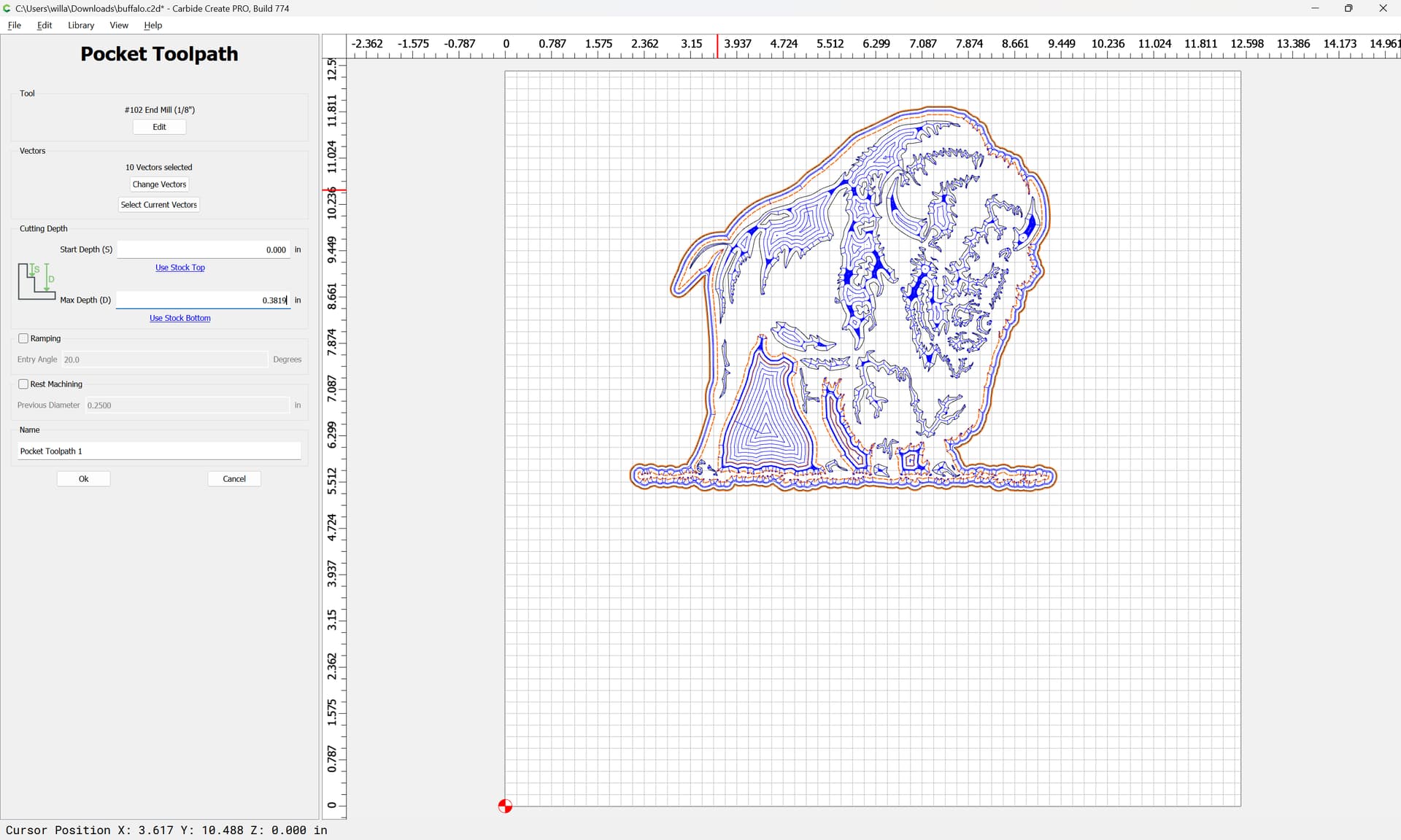

I having a difficult time with this cnc project of a buffalo. Don’t know if my tool path is bad. I’m trying to do a contour with a 102 bit. I’ve been practicing on 1/2" plywood, and it looks like garbage. Any suggestions?
Tim
This is a quite detailed design:

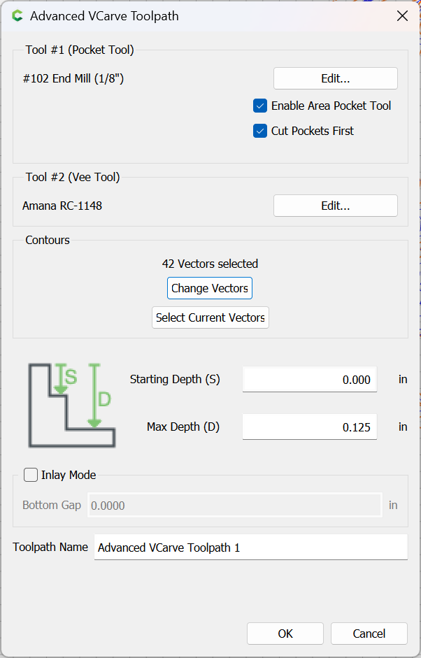

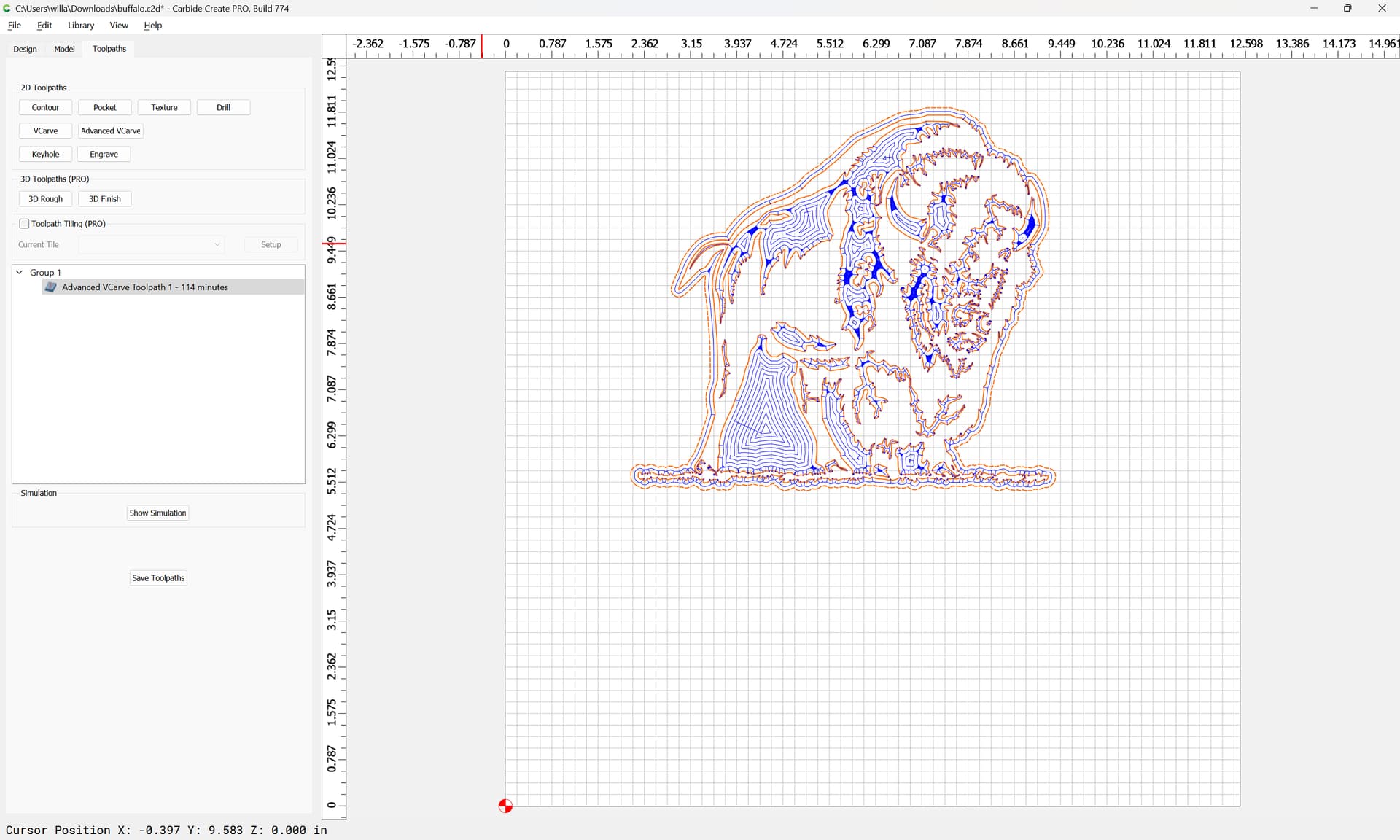

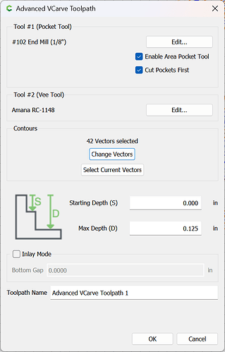

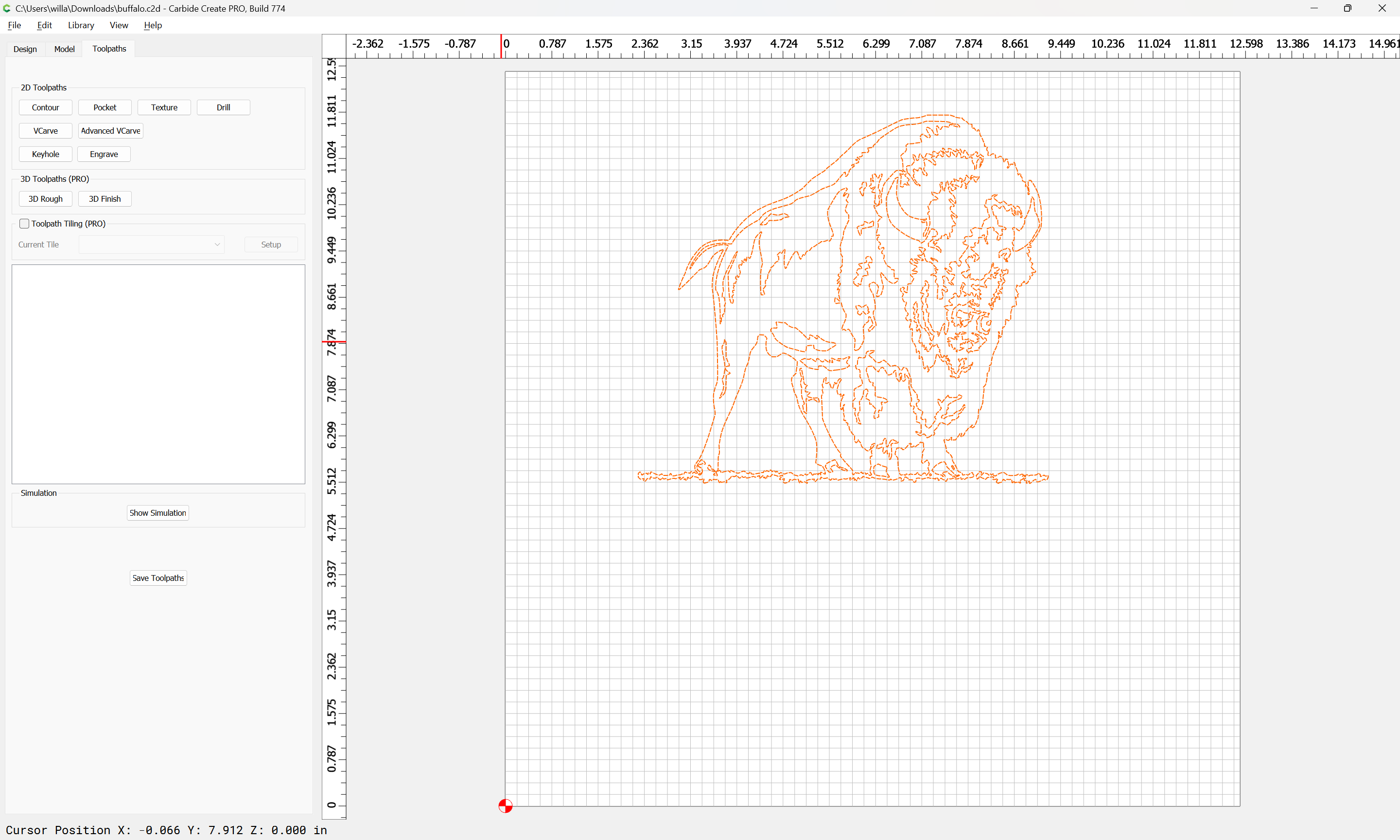

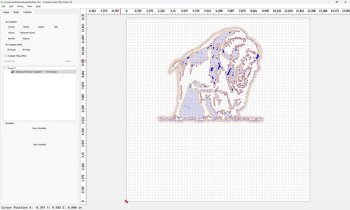

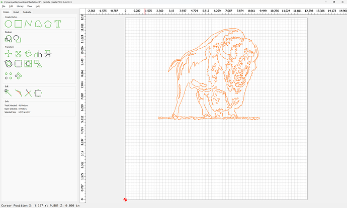

For intricate designs it is usually best to use V carving or Advanced V carving — since this design has large open areas, Advanced V carving would be better, but if done with the design as it is:

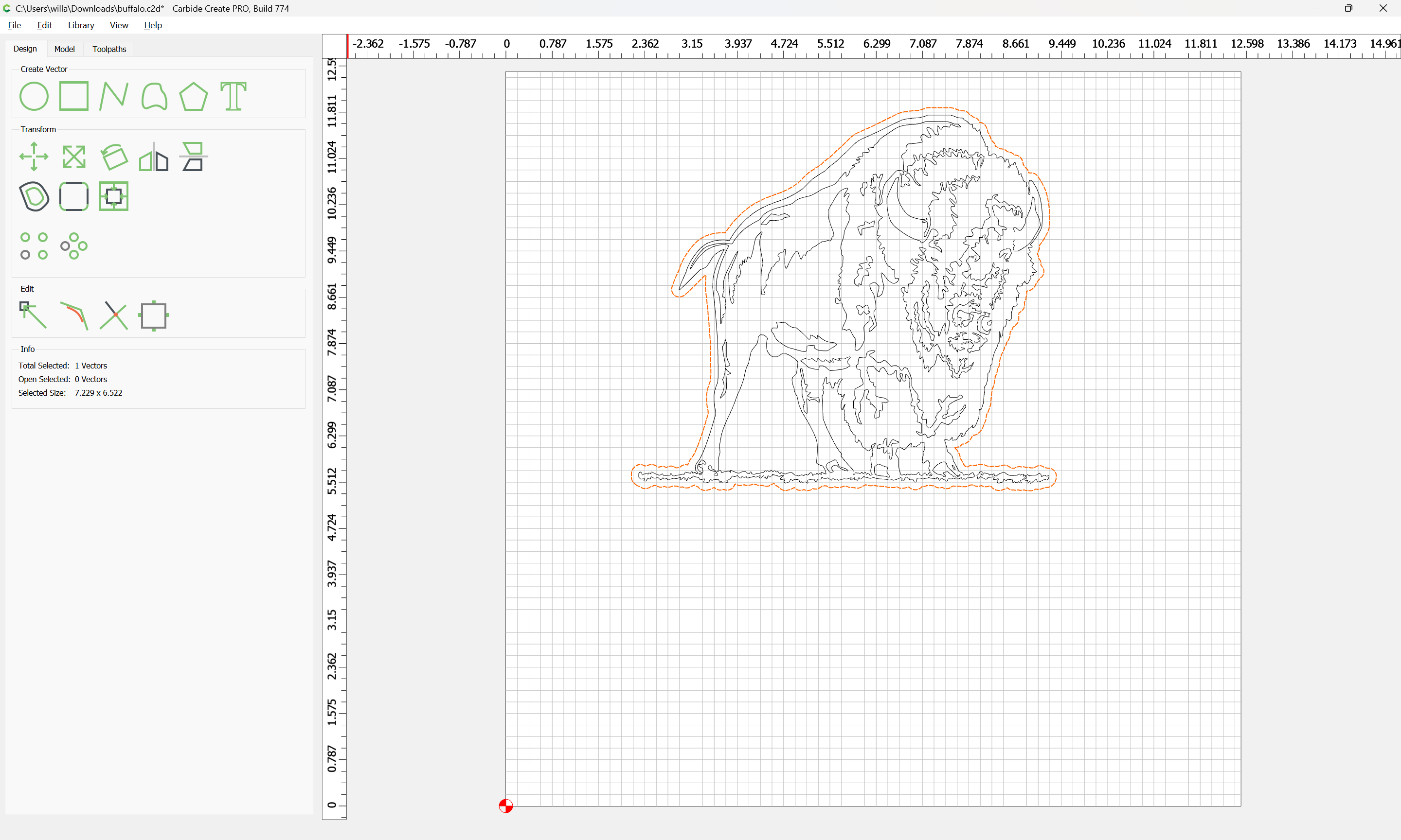

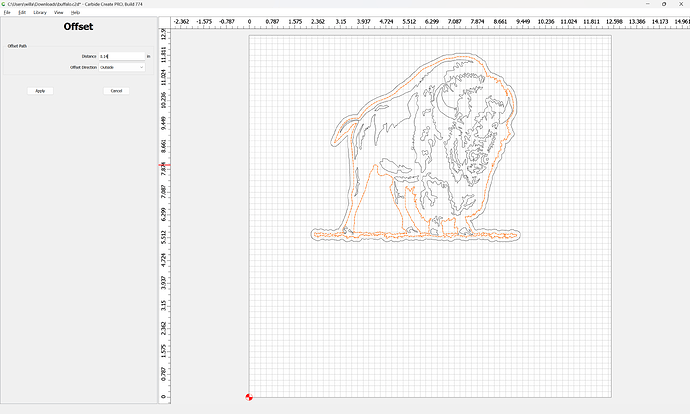

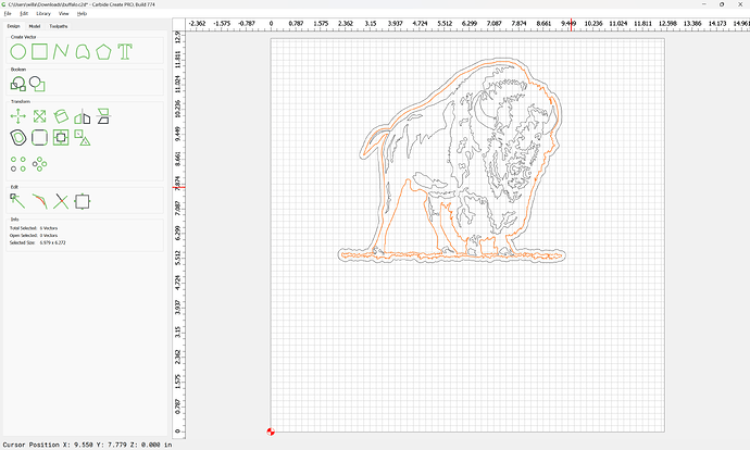

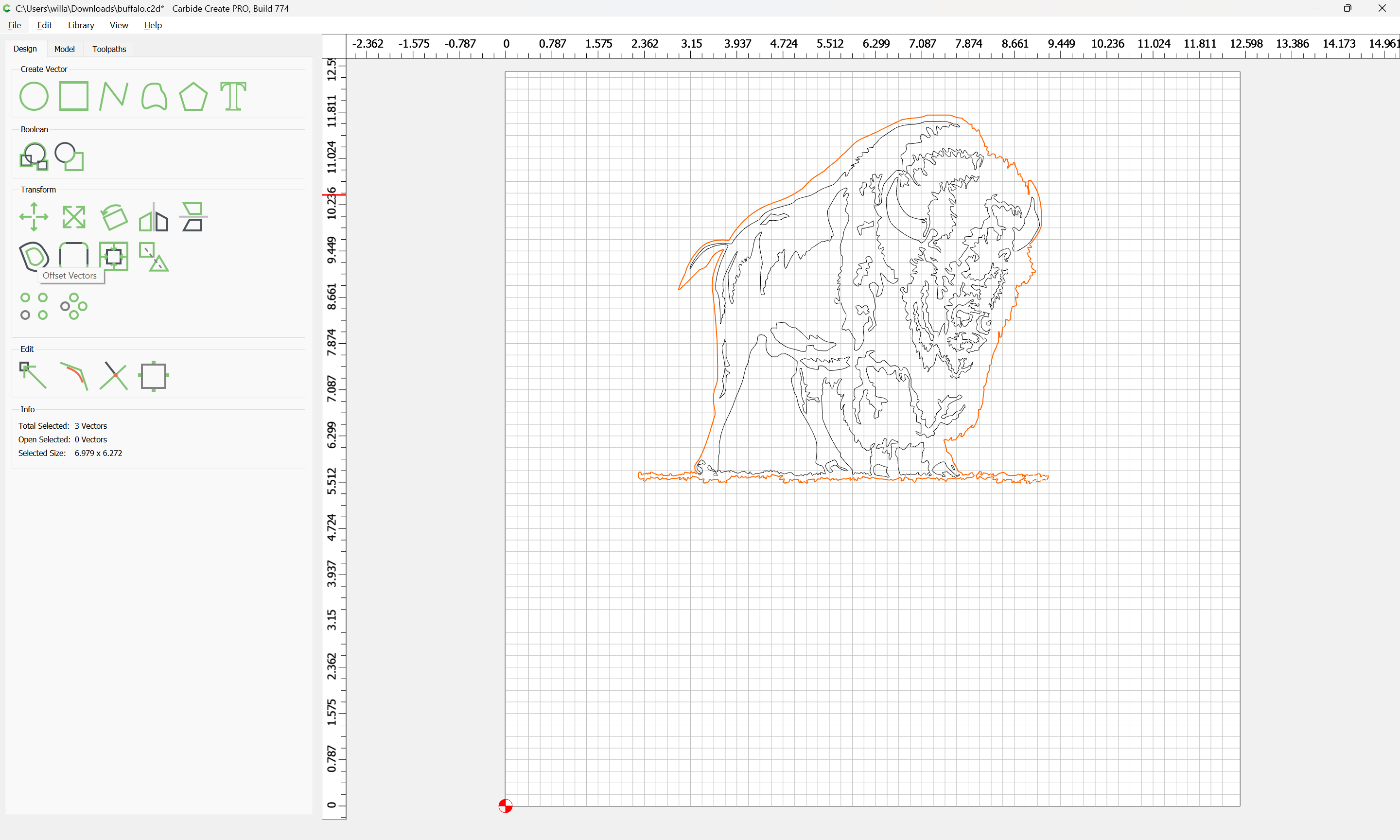

If you offset the perimeter to the outside:
(which will require ungrouping)

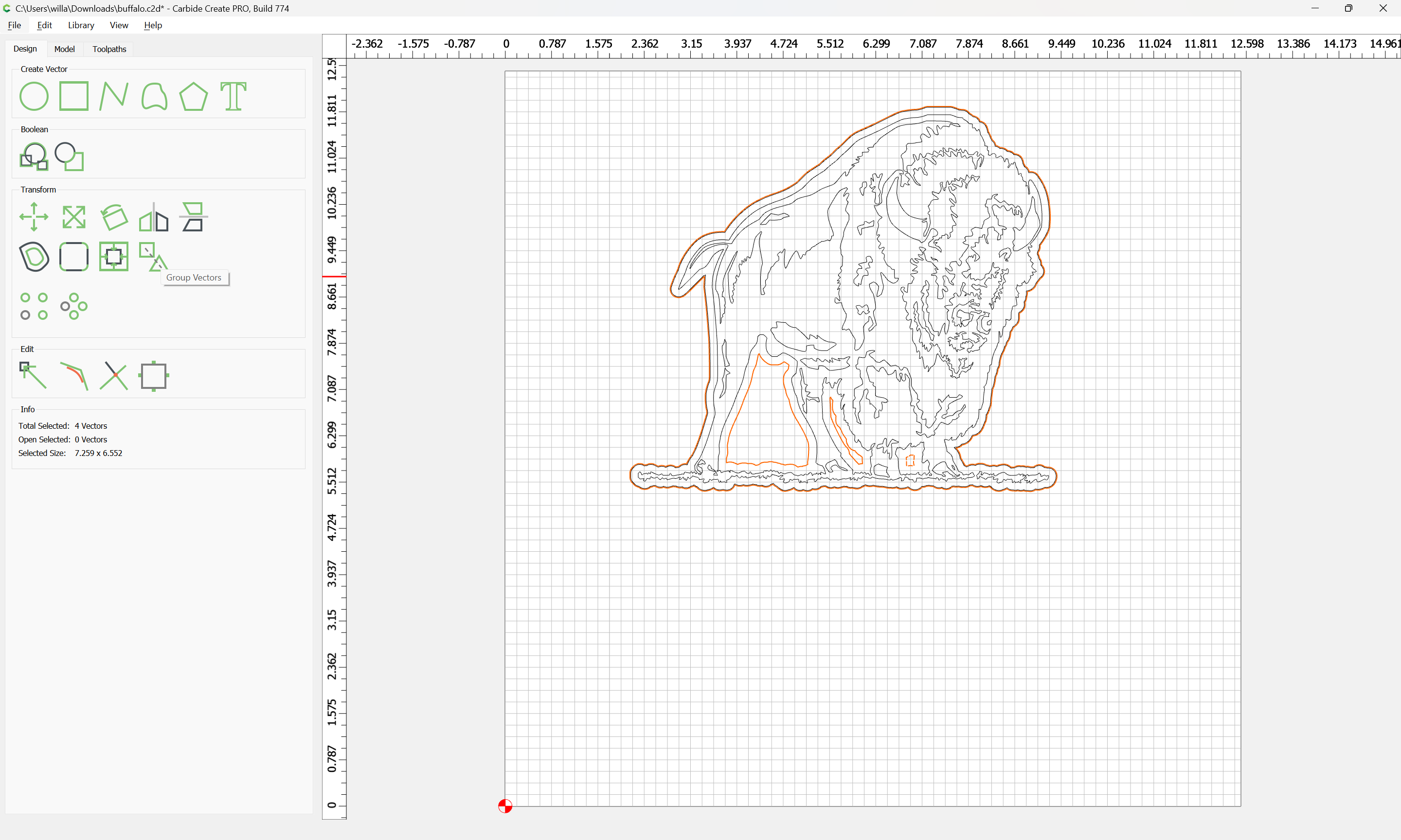

Offset to the outside:

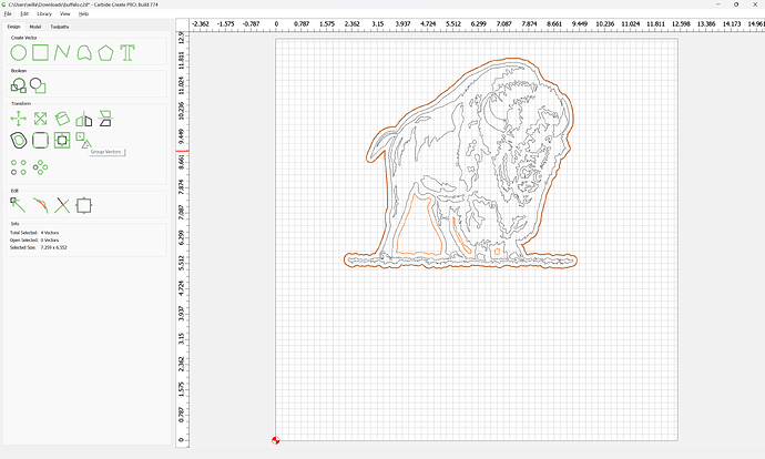

Change the geometry for this toolpath to include this:

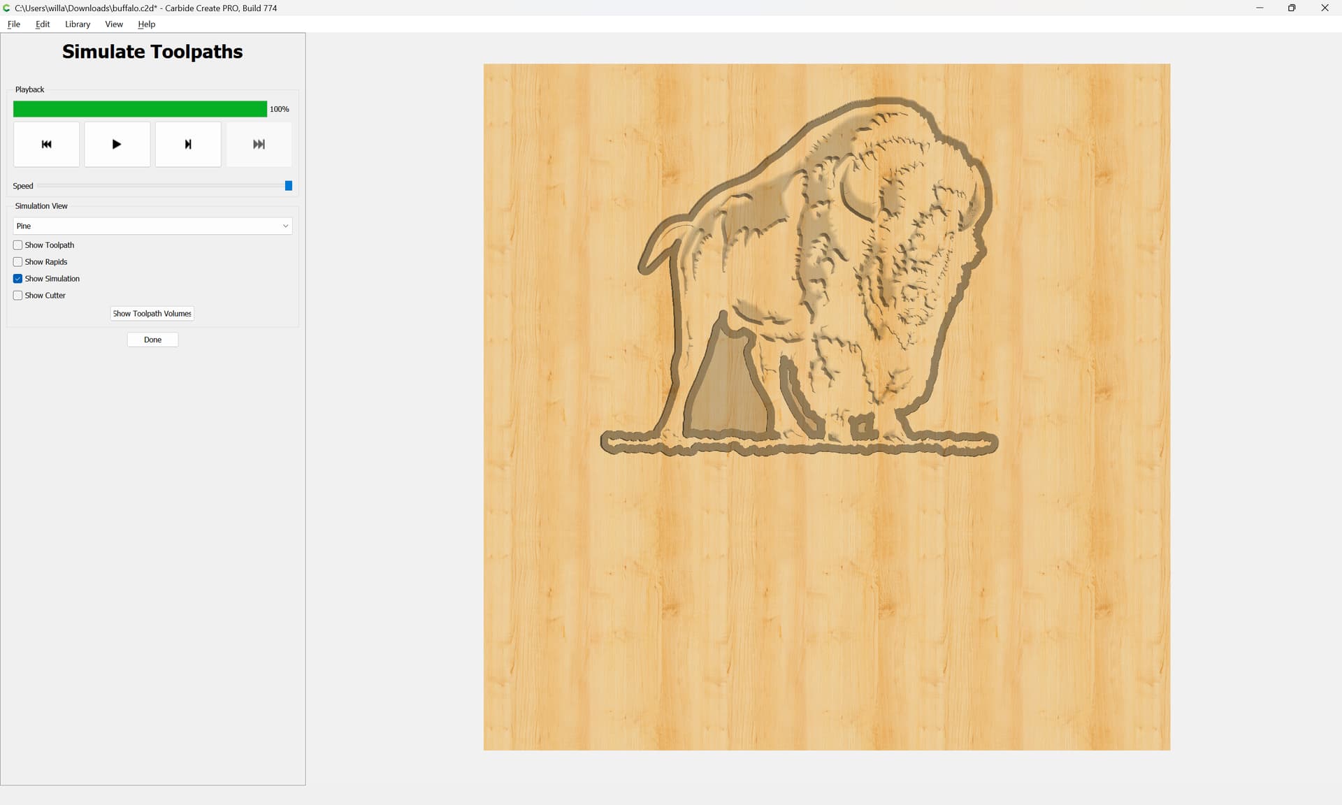

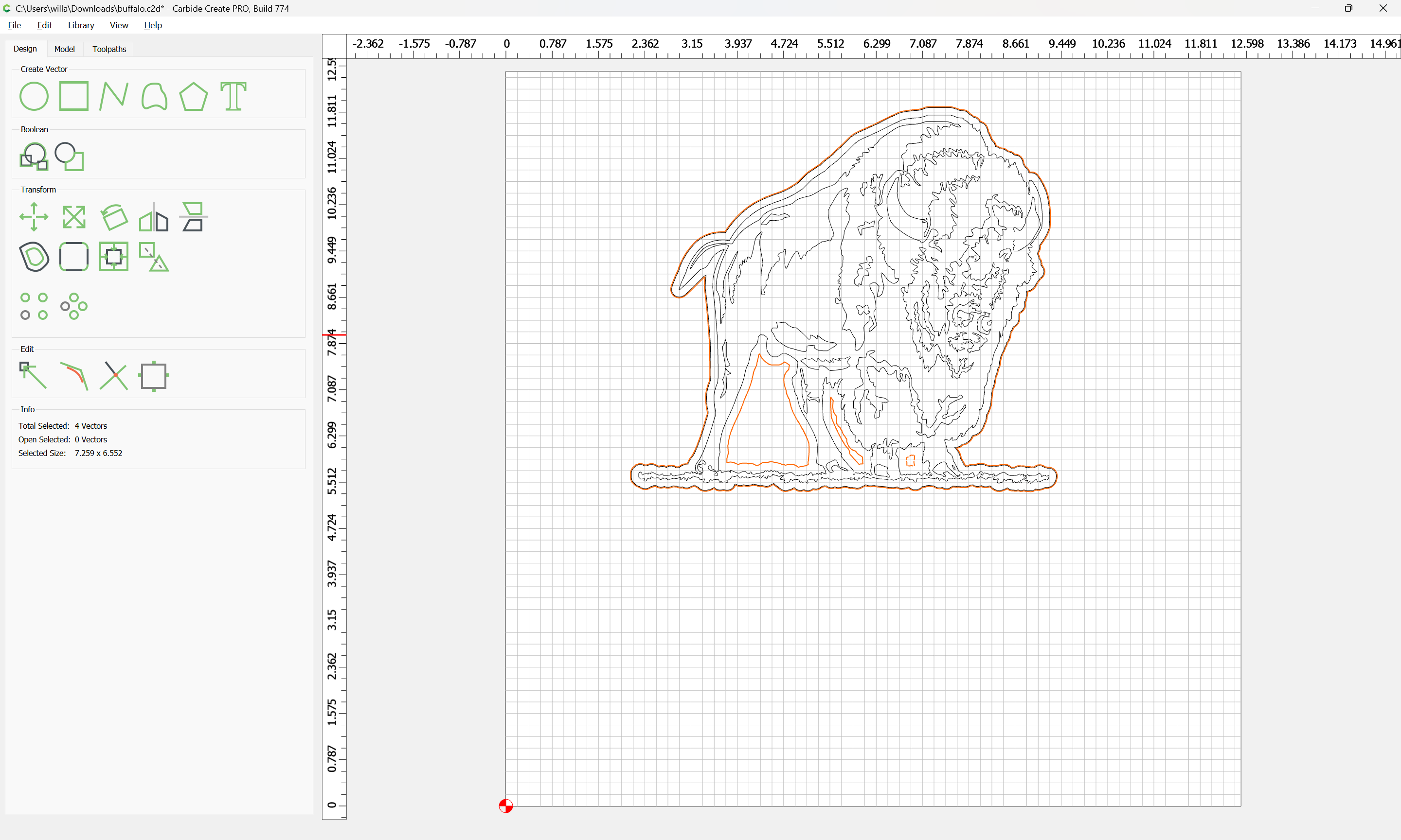

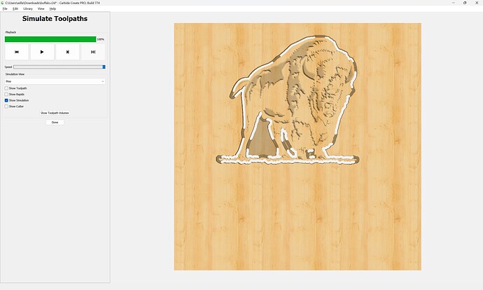

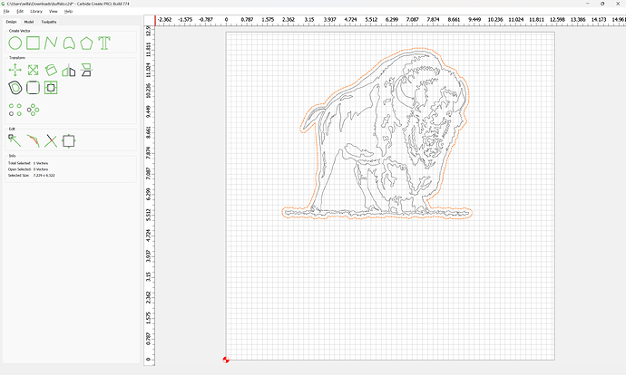

which gives us a more reasonable appearance:

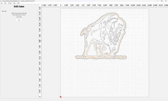

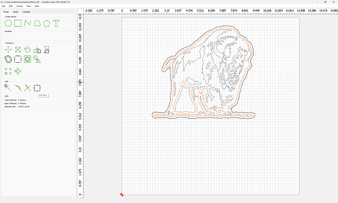

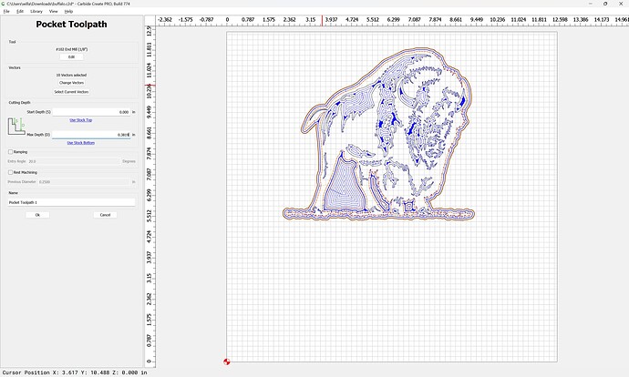

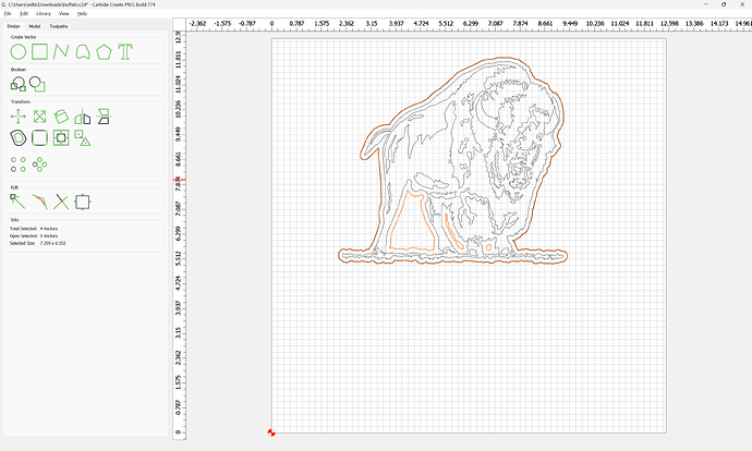

It is then possible to cut things out with a suitable endmill:

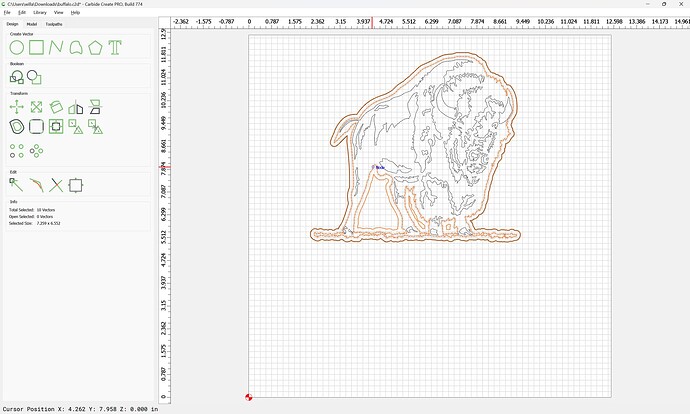

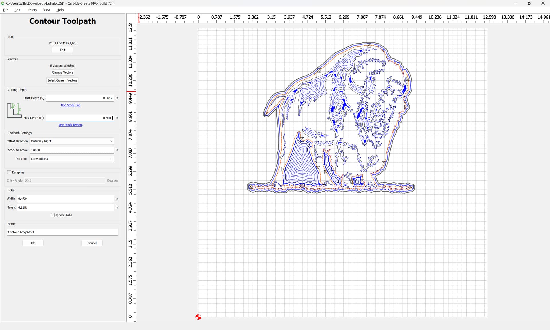

and then set up a toolpath to cut down to tab height:

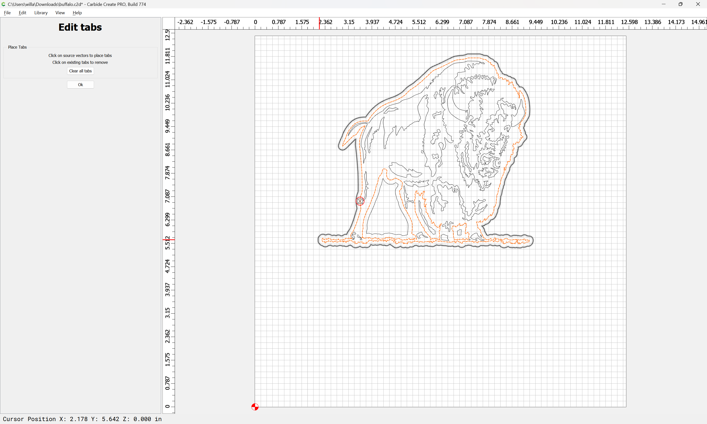

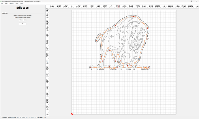

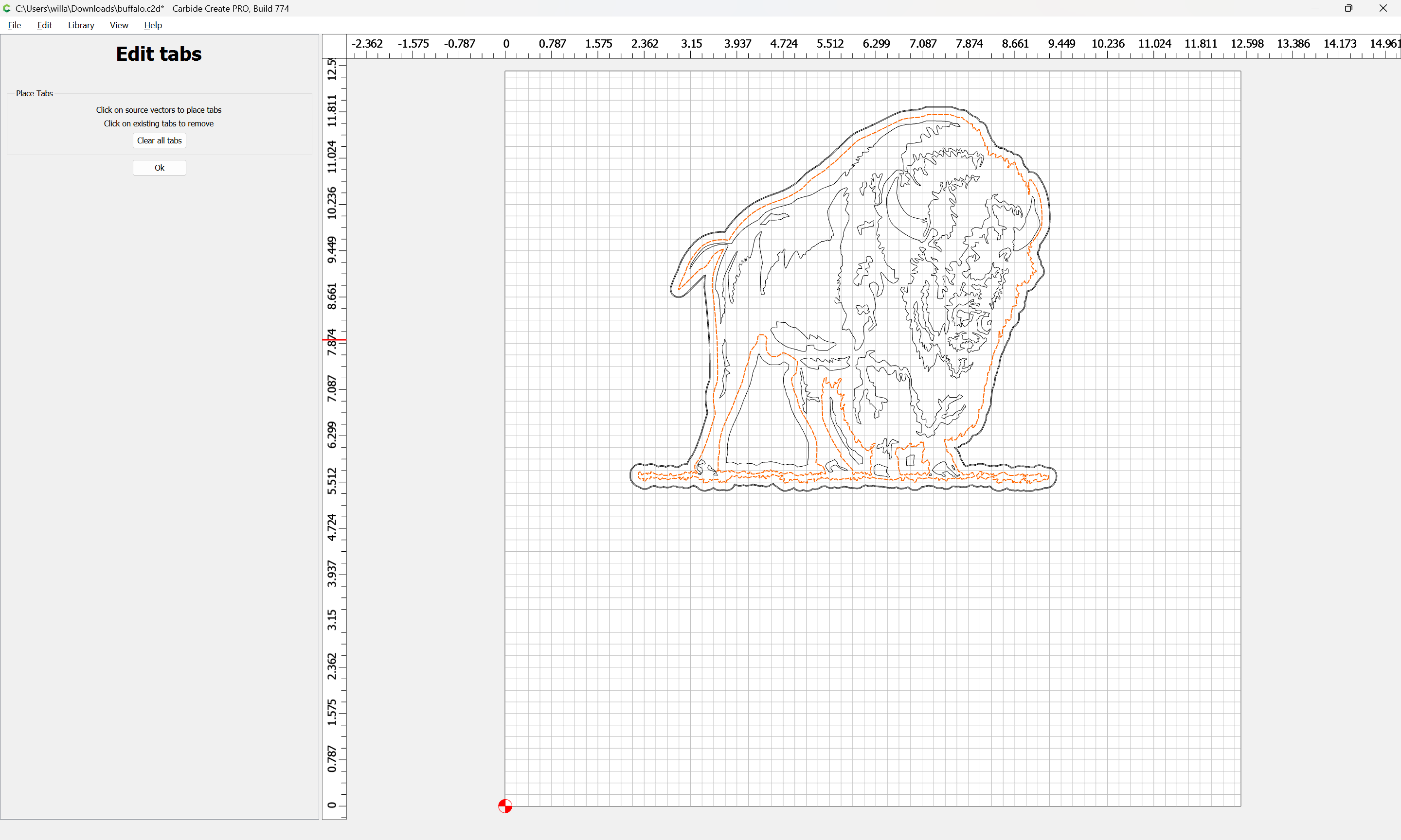

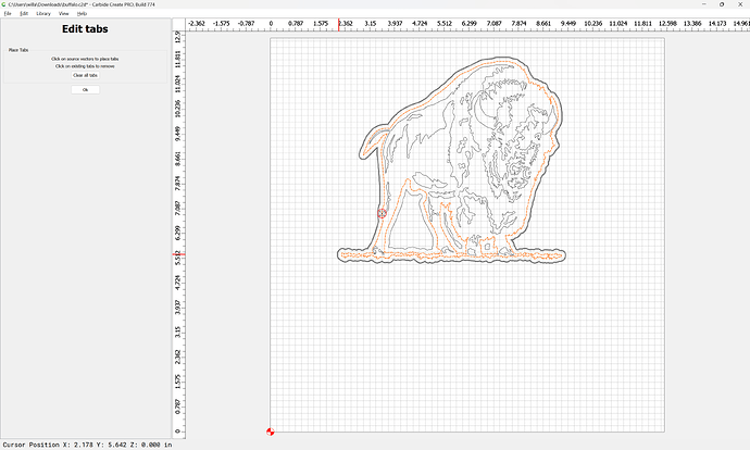

and then add tabs to the perimeter geometry:
and then create an Outside Contour to finish:
Attached as a v7 file:
buffalo_v7.c2d (1.2 MB)
If you want a different appearance you may need a different geometry to start.
