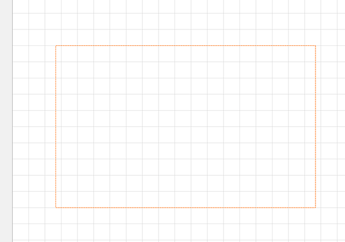

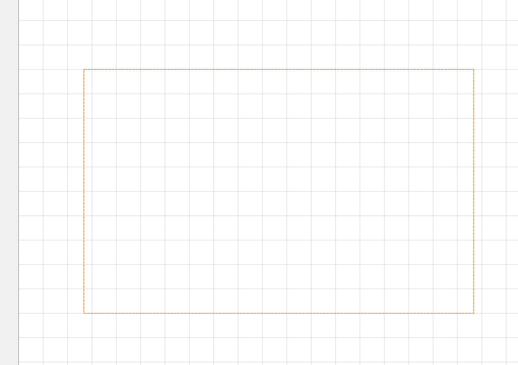

As @jtclose svg files are 2d. To save any shape just select it and go to file and export to svg with a file name.
Here I just drew a rectangle and exported it an an svg
Here is the resulting svg:
