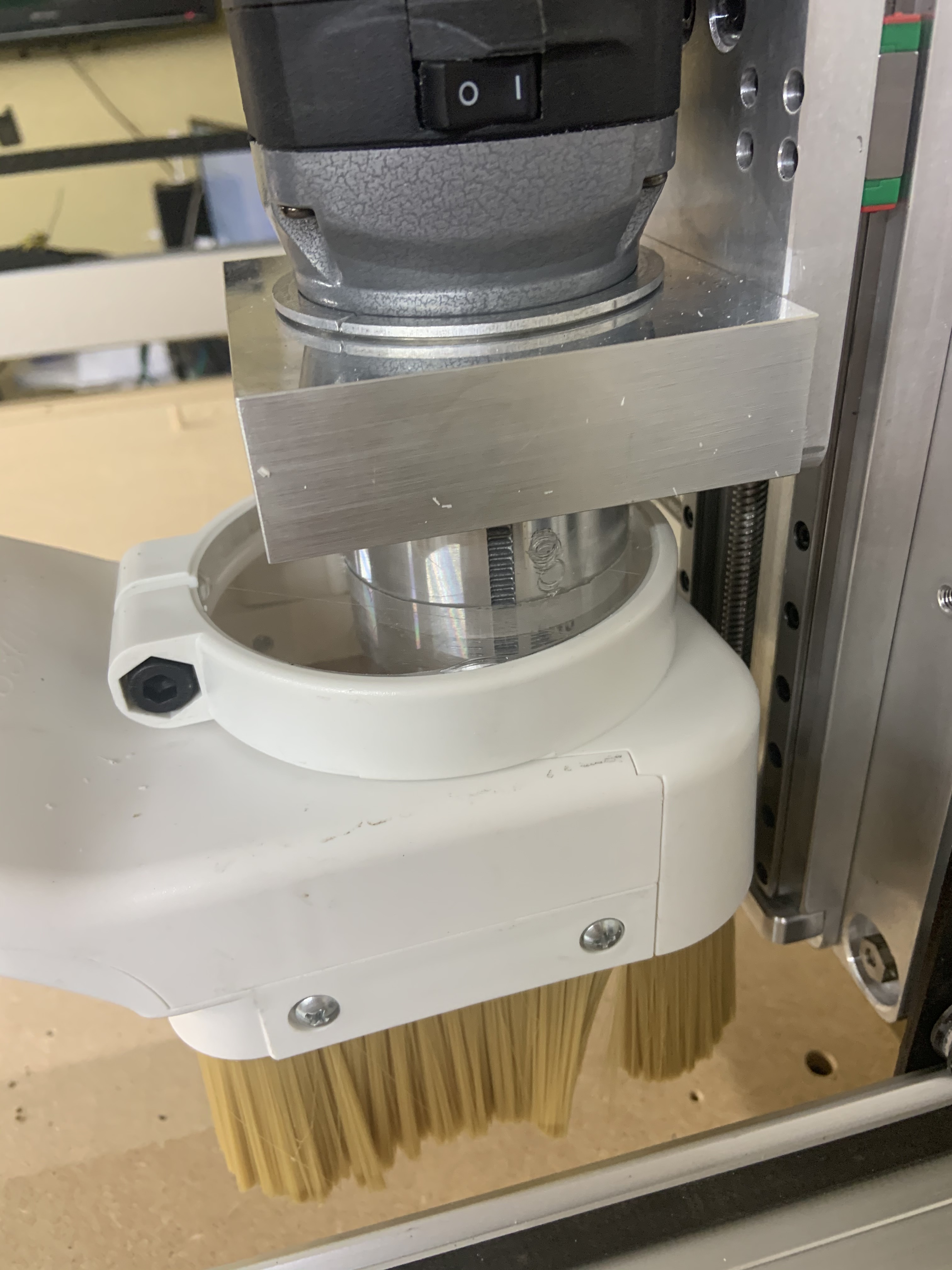

Thanks to you i got my project finished! I needed an offset adapter because I bought a dust boot from amazon for an 80mm spindle. I plan to upgrade that next but in the mean time I will see how well this works for a cheap setup. I used 3/4" acrylic I had laying around to make this
