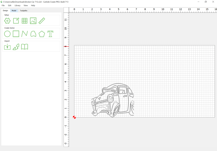

Unable to load file to CM from 712
Pulled up a project I had tried to do a long while ago. Loaded the file into CC712 to play with it. Did a little bit of cleaning on the file, and created a few tool paths to test how it would cut. Saved the file, saved the tool paths. NOTE: Today as it was saving the progress bar started at 66 percent, hung for +/- 15 seconds, and disappeared.
Opened CM566, initialized, and loaded the File. It did not make it to CM.
While I was playing around late last night I was able to load files to CM, as I saved tool paths last night it saved normally. Today when I wanted to test my cuts, the file would not load into CM
So I opened CC652 opened an old file, loaded it into CM. It worked. Was unable to load the file I was working on last night in CC652. The file was blank in CC652.
This is just a learning file, nothing important except the learning.
Just tried another file. Broken Car. Did not work
Broken Car 712.c2d (144 KB)
Temps2.c2d (496 KB)
Temps3.c2d (496 KB)
Note that 712 is supposed to be broken and should be replaced by 713:
  • (FIX) We broke the file a little in 712

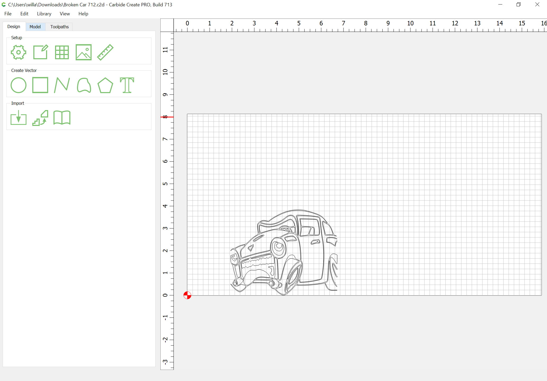

Should Broken Car look like this?
(works in build 711 or 713)

Yes, it was a file I was playing with to see how to play with lines. Something I borrowed from the internet.
I am using Windows 10
Thanks for the help again Will
