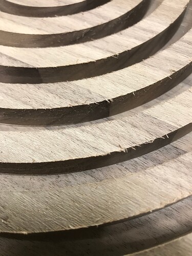

I’m at a loss here and looking for ideas. Running a 5 Pro with Makita router.
The Problem: I have an item where I cut concentric circles. First pass is with an IDC roughing bit followed by a 0.02 offset with a compression bit. The compression bit removes the roughing marks everywhere except the 5 to 7 o’clock area on the front side, this is consistent around all the circles. I’ve also noticed this on other projects, it removes roughing marks everywhere except the area in the same position. I even changed the offset to 0.03 and it still didn’t even touch the area in question. This is an old file that I’ve run dozens of times without issue.

Can you share the C2D file? And these are the marks you’re talking about, right?
It’s not a file issue, this happens across multiple different files that I run on a regular basis.
That is the problem area though, the finishing compression bit only clears the roughing marks in select areas. It has to be some mechanical issue that’s causing the bit to not make perfect circles as the cut is inconsistent.

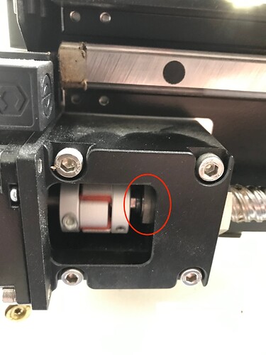

Then I found the problem. I previously noticed the screw rod was uneven between the two sides by about 3mm at the front of the machine. I was able to wiggle the rod front to back and figured this must be the issue. A little bit of looking around and I found this was loose. Removed a few pieces, tightened this back down and the problem seems to have been solved.
Thanks everyone for your input.
In the CNC machining world this would be called excessive backlash and typically the main place you would see it is when you cross quadrants and the ballscrew reverses, obviously this was a mechanical issue but sometimes it may wear. Easiest way to check is with a test indicator moving either axis in both directions seeing if there is play. Not sure if Carbide motion parameters can be adjusted to overcome some of this when wear is the culprit.
