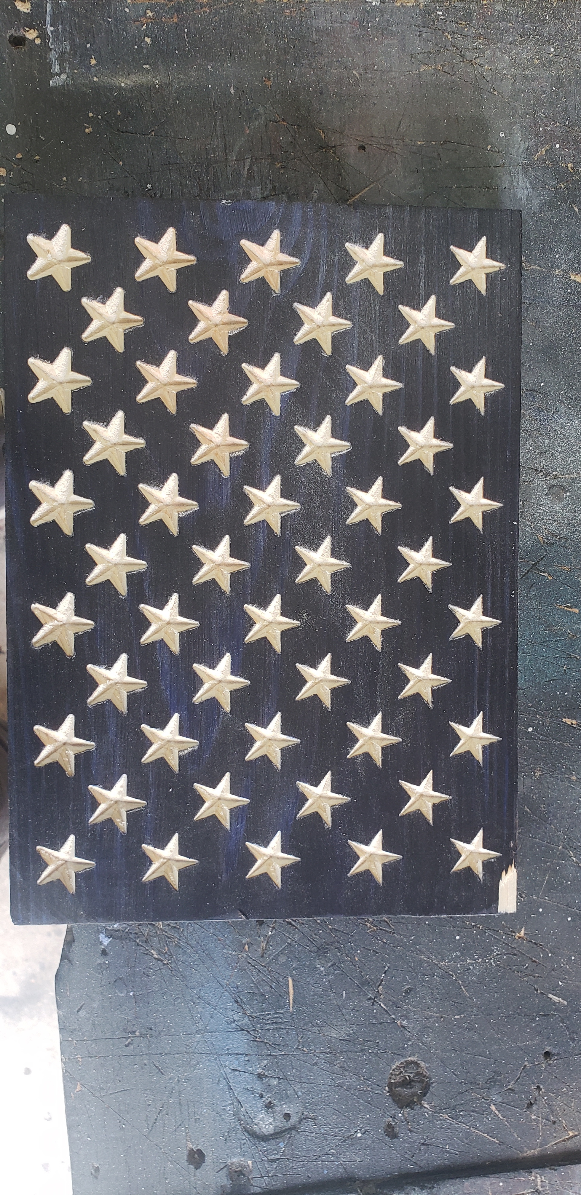

Trying to work on a few test pieces for a few different flags and this is issue in running into. Starts look good in one corner and by time I get to other side they are much deeper!!
HELP!!!
I’m using 60 deg vbit. Tool path is done with advanced vcarve set to .25 deep.
20200529_144720|690x335
Usually this is an indication of variations in your stock thickness or your wasteboard “flatness”. Basically, a piece of wood is rarely flat and a consistent distance from your endmill. For any precision v-carving, I recommend facing the stock with your machine first.
If that’s not it, you may have lost a step or two with all of the Z moves. Make sure your Z belt is really tight.
Thanks for the feedback. Im gonna have to try resurfacing my waste board… Which is process in its self as it seems me Z Travel isnt long enough! I have the Z plus drive so no belts to tighten! LOL
while a nice flat wasteboard is great…
the problem is more likely with the top of your wood, not at the bottom of it…
Surfacing the workpiece is probably the best way to do it.
I know it doesn’t help if you’ve already painted/stained, but if you can do it before that step and place it back in the same spot, you should be good.
Do you have an extra wasteboard on there? The Z Plus requires the extra WB for proper reach.
