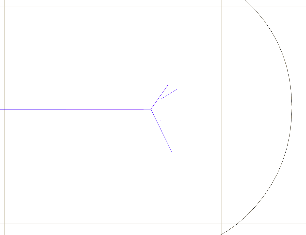

At the end of each letter there are multiple ‘picks’, all close together.
Here’s one end of a ‘t’ crossbar, from CC 805:
The light square is 1mm grid, so CC is still outputting ridiculously small movements. It’s hard to see, but there is a forth pick in there that I estimate is less than 0.01mm.
