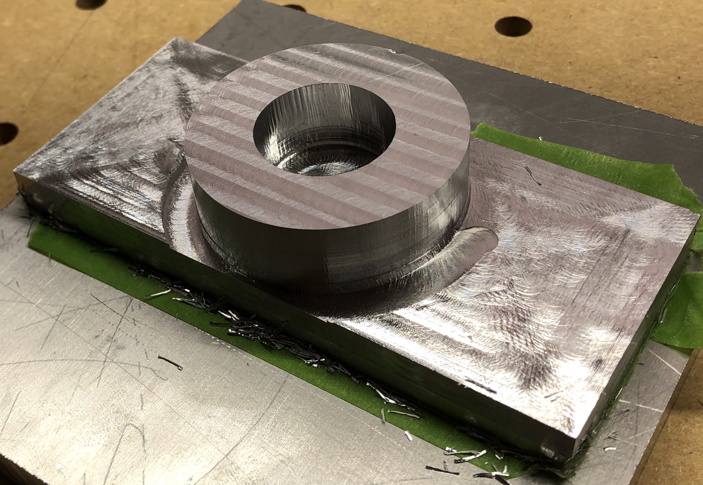

So I’ve been working through a bunch of tests in 6061 bar stock to develop test recipes for feeds and speeds along with cutting strategies. The last 3 attempts have just been total fails and it has to do with being able to relocate reliably the wcs after shutting down a session and returning to it later. My workflow is an xl with hdz, tool setter and probe. I was working on finishing strategies today on what I would describe as a bearing block , after finding the center if my work piece because it was off after home , I checked my z- 0 and reset it to the top of my model since. When I went to run my contour to clean up the outer walls using multiple depths it over shot the final depth. I slammed stop , checked the came measured the stock and model reset everything and reran the op… same thing. Then I rigged up some indicators to see what the issue was and something wacky is going on with my offset post tool probing. I plan to take it out of the loop tomorrow and see what the deal is but this has just started happening… it’s always bad when you here a 3 flute plunging into stock when it shouldn’t be, which is odd because the roughing didn’t have this problem. It’s also interesting to measure after a cold start how much drift there is after a rehoming event and jog to x/y zero.

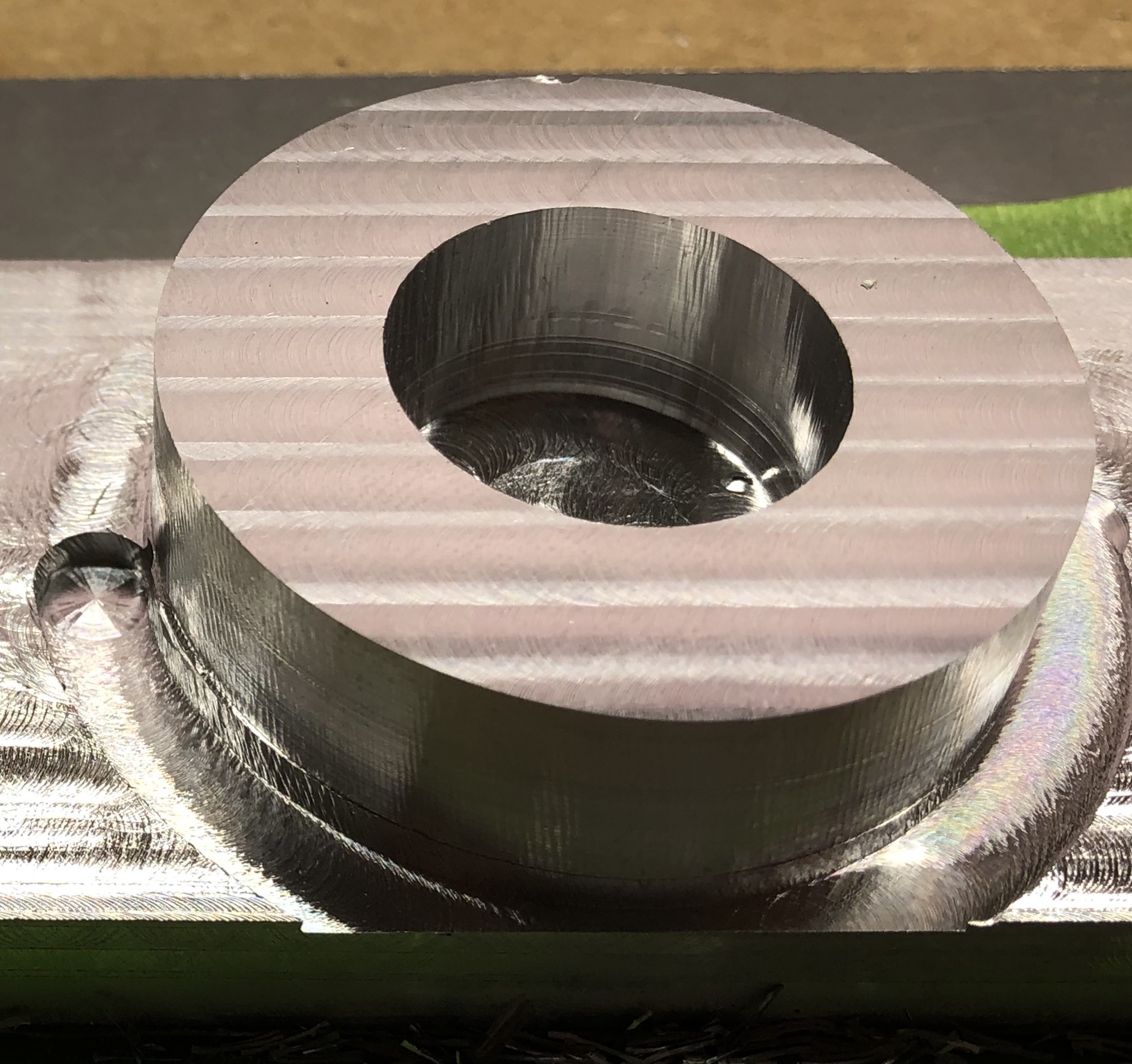

No. No tool change. I was testing strategies for relocating my x,y,z WCO when I need to resume a project after a cold start and then magically this issues started. My guess is something is now wrong with my bit setter because this is exactly how it would manifest…just not sure why. Its not extreme but you can see in the picture during a contour op where on the final depth it over shot and plunged into the floor.
