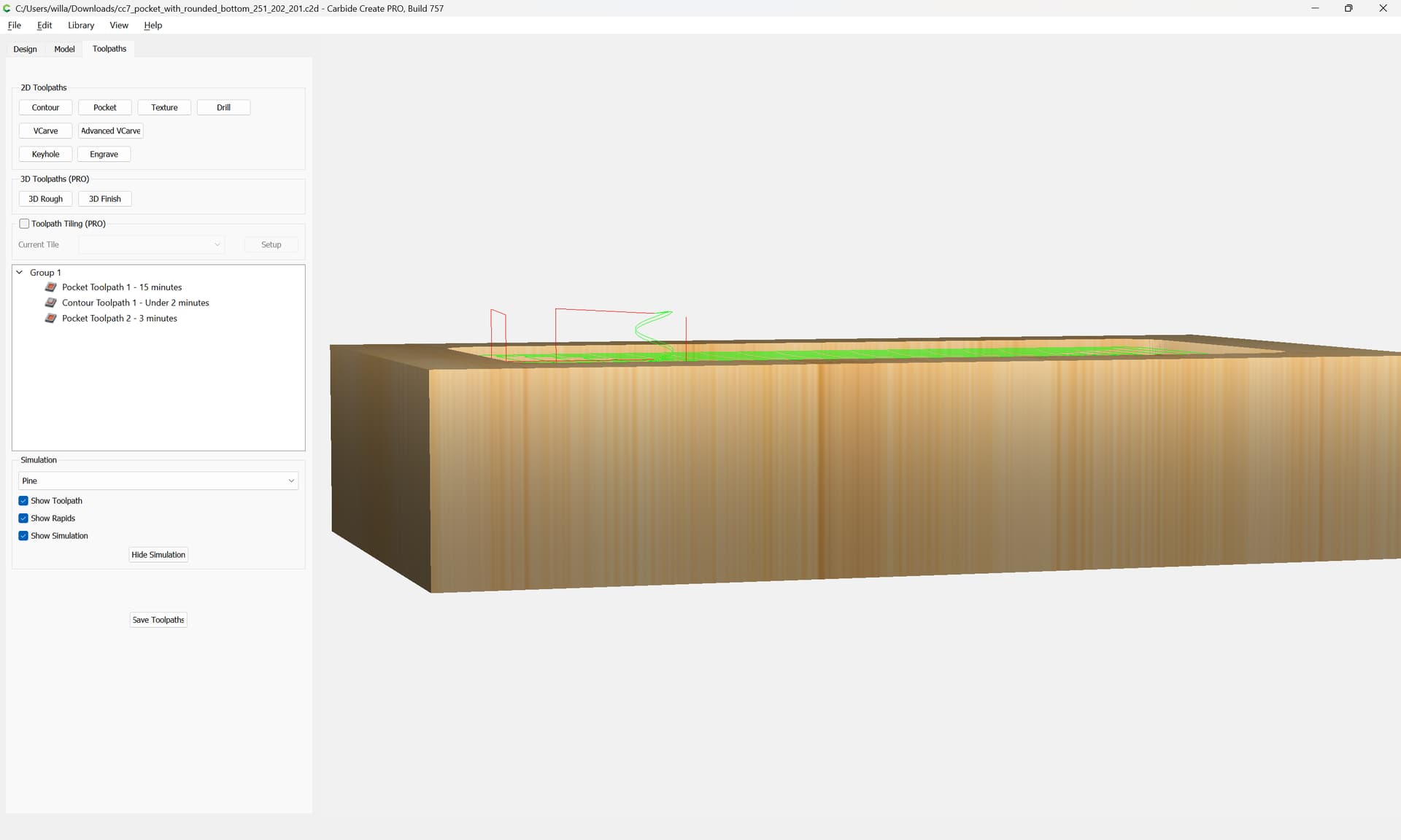

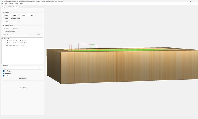

It is having a cut angle in for entry — it’s an option in Carbide Create Pro and some other CAM tools:

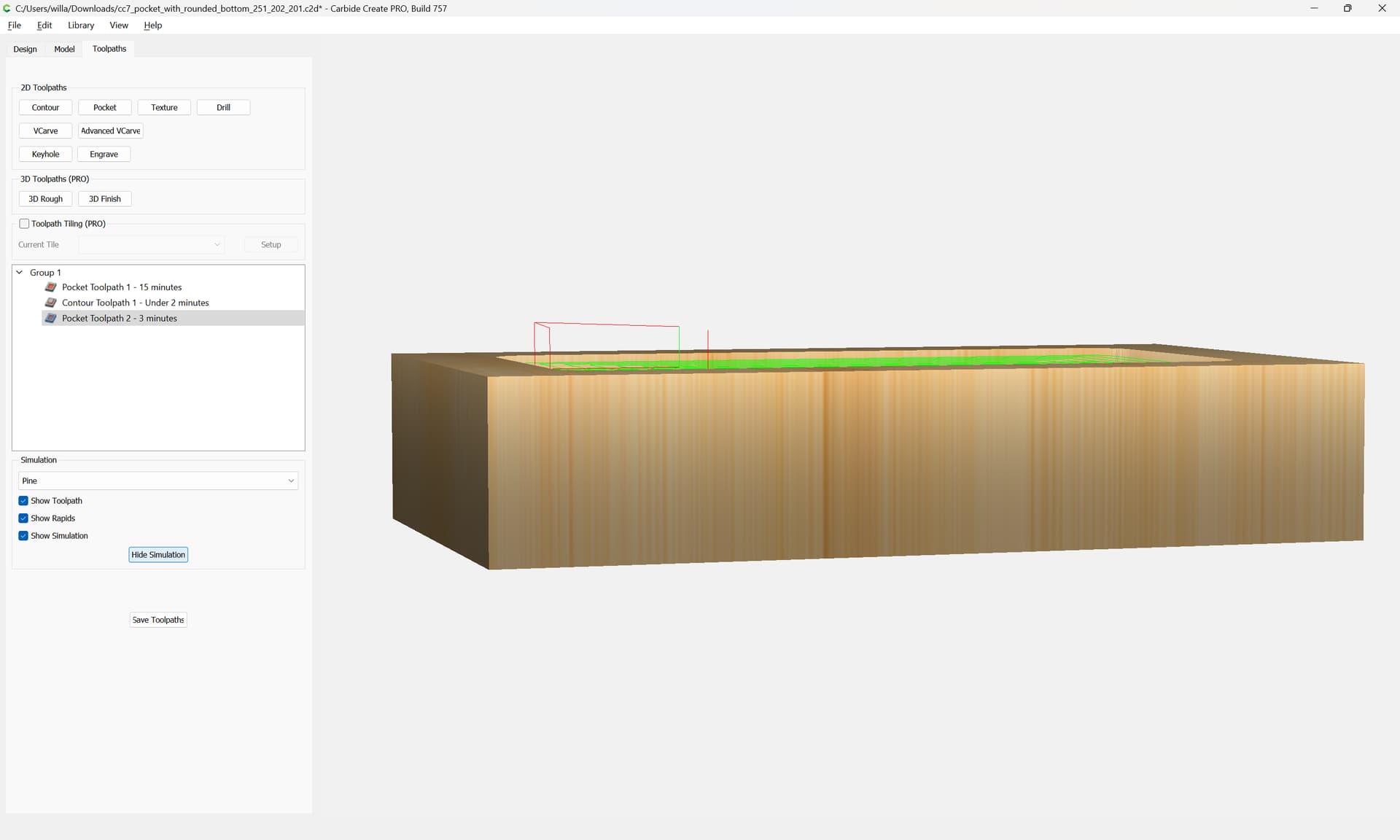

as opposed to:
