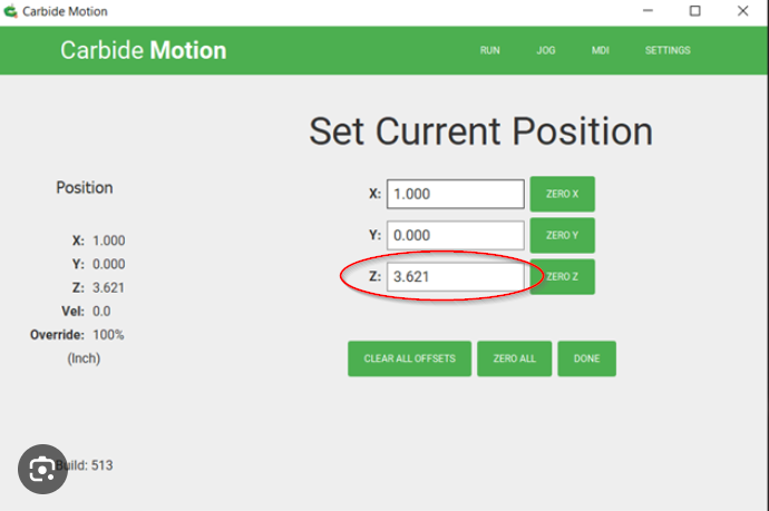

I would like to make a user action that lowers the z depth by a certain amount. I use the machine to flatten a good bit of live edge slabs and am having to jog down to the z and set zero when trying to take off a few thousandths at a time. Just thought that a user action may be easier if it is possible. I would like to be able make a couple different ones that lower the Z zero by a set amount like .004, .014, 0.24, etc. Any help is greatly appreciated
I believe this will work if you switch into a Relative movement mode (EDIT: G90 not G20 as corrected below) and then make the motion (and then switch back).
Please verify by looking up the G-codes, and then test before committing.
G20 is Inch, G21 is metric (mm). G90 is Absolute positioning, G91 is Incremental (Relative).
However, I do this all the time by just typing in a value into the Z position rather than clicking “Set Zero”. If you move it to Z0.0, and then type in “0.014”, Z zero is now 0.014" lower.
In fact, I usually just add my offset amount to whatever is in Z at the time. So after a program it retracts to 3.738, and I want to take another 0.010" off, so I change that to 3.748 & rerun it.
Cool thing about this is when you are done, if you are going to use the same tool it’s already set at 0.0
Thanks so much for our help. I hope I understand it correctly. So after my flattening program runs the machine retracts and goes to the back left. Where do i enter the 3.748 and that will effectively make a deeper pass by .010?
You don’t. You look at the current Z value, whatever it may be and add 0.010" to that number.
This one says 3.621, so you would type 3.631 or just change the 2 to a 3, and hit enter, instead of clicking on “ZERO Z”

So instead of going back in and changing the tool path depth of cut in the file itself I can just reset the Z zero here and rerun the file to take of an additional .010” for a leveling or surfacing action?
If this is correct I will be saving some level of effort for sure.
Yes. And I usually enter a max depth of 0.0001", which gets rounded to 0.000 so I’m finishing the top off at Z0.0. Your first pass, if you’re touching off & cutting 0.010" at a time, you would set the Z to 0.010"
Awesome! Thank you. This process is much more efficient than adjusting the actual file and reloading etc.
