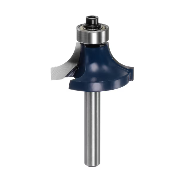

The type of bit matters. If you have a round over with a bearing you need to remove the bearing. Bearings on router bits do not work well with a CNC.
If you have a round over without a bearing then you could do a no offset but giving a little bit of an offset would be best. You could always create another tool path to do just an offset without a few thousands of offset if the round over does not look right.

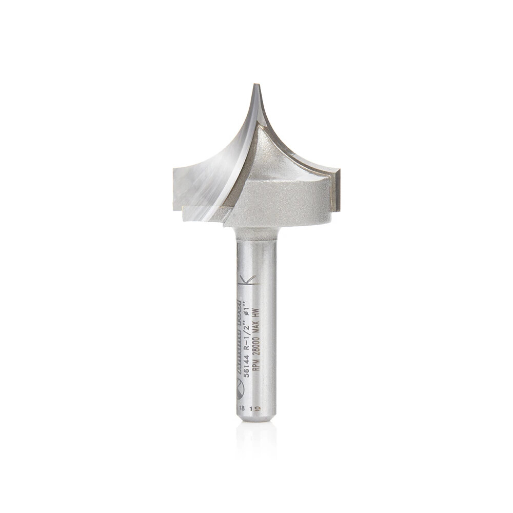

A roundover bit like this.
A roundover bit like this maybe if the bearing is removed.
Just remember with the bearing removed there is a part of the bit that is sticking down below the round over part. So make sure you material is thick enough for that part to not hit the spoilboard and possibly loose steps.

I’ve used a bit like @gdon_2003 shows without a bearing and it works very well. DOC is really a personal; preference depending on the surrounding geometry. I will say I tested it a good bit before deciding on what I wanted.
One thing to consider is leaving a tiny bit of gap so the corners of the bit don’t leave a mark on the part. You have to measure the bit to determine your desired offset, or the diameter you use to define the bit, and the desired cut depth.
