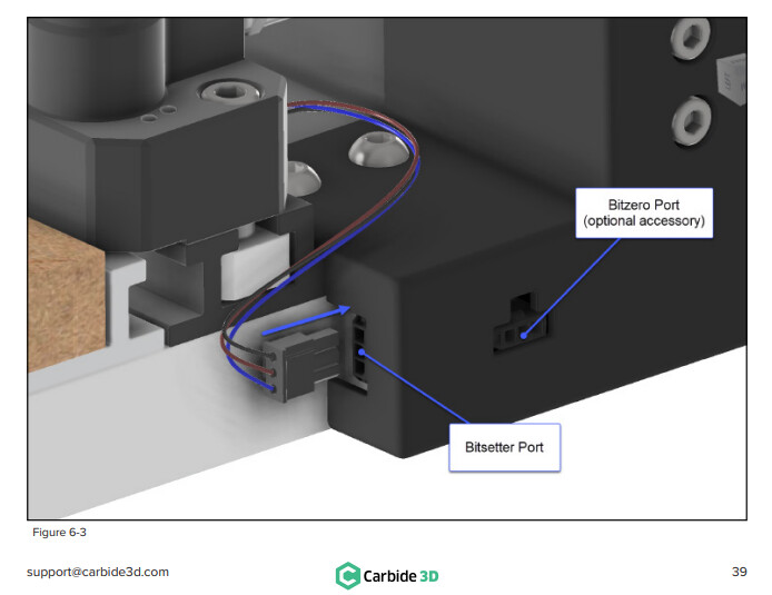

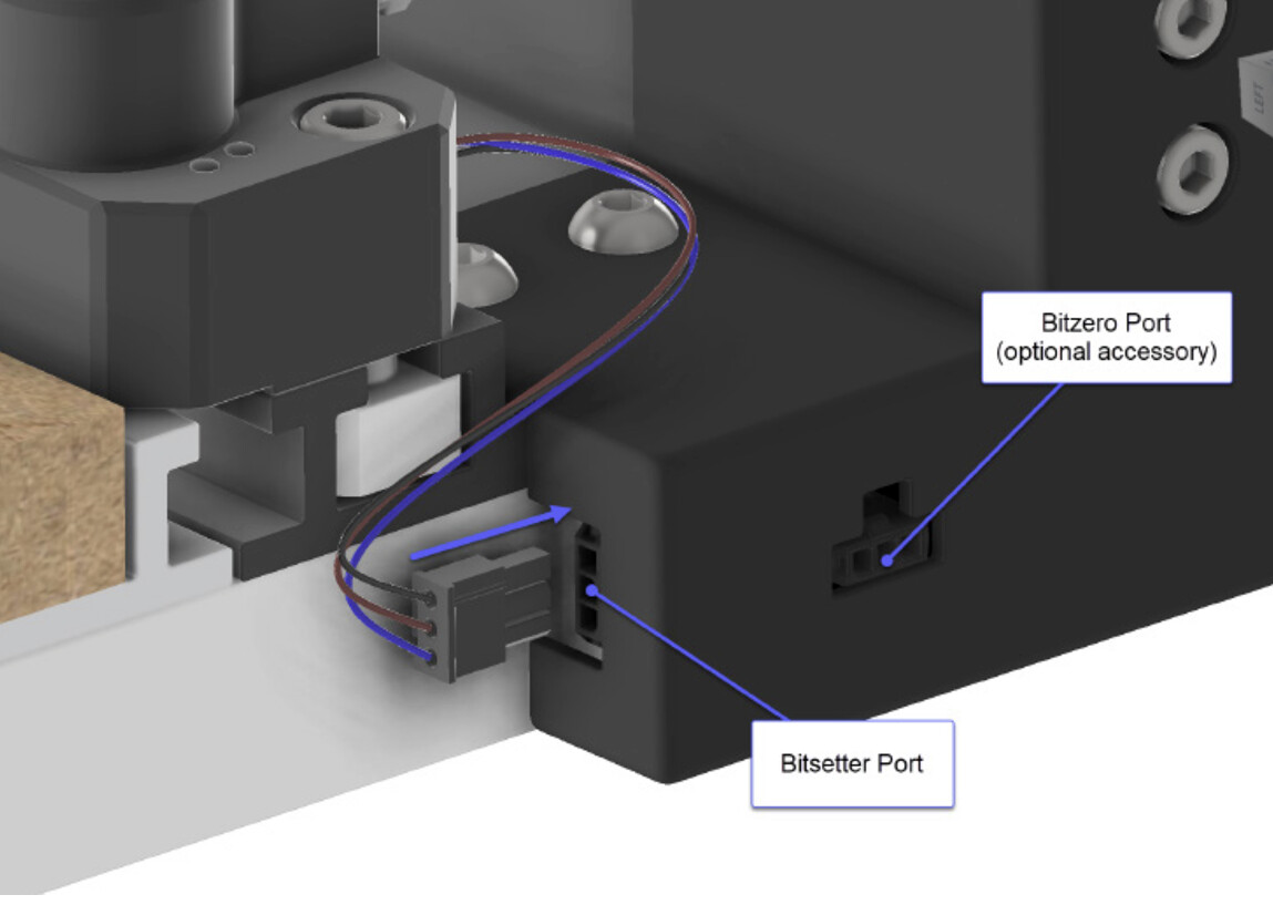

Just bought a bit zero v2 for my Shapeoko 5, how can I use that and the bit setter at the same time? I keep having to unplug one to use the other.
They can both be plugged in at the same time. They have their own ports.
WillAdams
(William Adams (Carbide 3D))
3
Plug both in as noted in the instructions?
pg. 54
